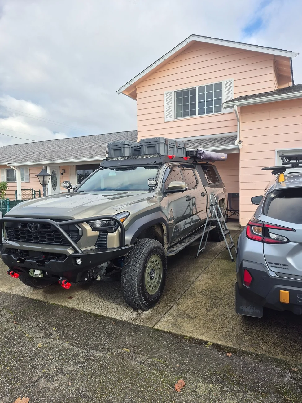

I agree with co245, drive your truck for 1000 miles or so. The suspension will settle down and you might be presently pleased with the results.
My king suspension settled about 1/2 inch, and if you are planning on installing a winch or winch with high clearance front bumper it will settle even more.
I just ordered new 650lb coils to replace the 500lb coils that came with the King suspension to lift the front end back up to level or close to.
It's just $$$

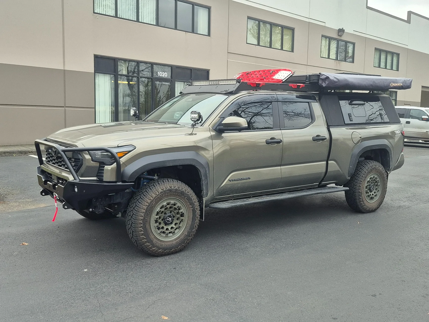

I highly doubt your stock TRD OR Bilstein shocks ever bottomed out (unless you were smashing speed bumps or g-outs at 30, or jumping the truck, or were just heavily loaded). With stock Toyota bump stops, bottoming out while driving is not a gentle experience.
The shocks were likely hitting the internal ESCV compression stage which is about halfway through the travel on our shocks. It's a noticable tap and stiffening of the travel.
More into about the stock shocks here (from when the tech was introduced on Bronco shocks, which are the same as our Taco shocks):
https://offroad.bilstein.com/en-us/a-look-inside-the-all-new-bilstein-escv-for-the-ford-bronco/
For your 5100 dilemma...
With the front circlip in the 3rd position, the springs should be preloaded for ~1.8" of lift over stock springs according to the Bilstein table of circlip positions. I've seen 5100s on earlier Toyotas occasionally net more lift than advertised, and I'd guess that you are in that situation.
1.5" front lift is the typical leveling kit for these trucks. In my opinion, that's actually a bit too much for a "perfectly level" truck. It evens out the fender gaps but results in a slightly nose-high stance if you measure along the bottom of the rockers (or running boards/sliders).
I'd recommend lowering the circlip down to the 1st position if you want a small amount of rake.
New shocks will have stiffer damping since they need driving time to break in. And with your springs preloaded for the extra front lift you now have, they will drive a bit "stiffer" (preload = same spring rate, but now at a stiffer value of the spring rate). This is the exact same as running a preload lift spacer which results in a "stiffer" feeling ride.
So dropping down to a lower circlip setting will also result in a "softer" front suspension feel due to reduced preload that is closer to stock. Something to keep in mind.

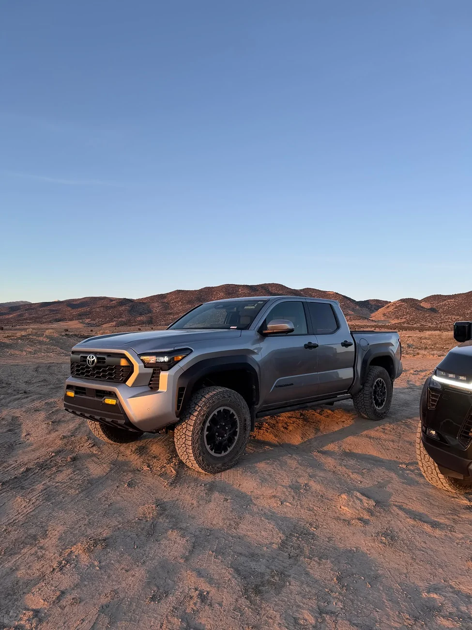

Got out on the trails today, the ride is infinitely better off road compared to stock, at all speeds. Less harsh, more compliant, have no complaints about the way these perform so far.
Obviously this photo was not taken on level ground, but you can see the front sitting a bit higher than the rear

Unfortunately even if they settle a 1/2in they’d still be too high.. maybe if bumpers etc. were in the cards near term I’d leave them, but at least I know I can re-adjust again down the road if needed.
Hopefully by then a set of Kings will be in the budget anyway!
