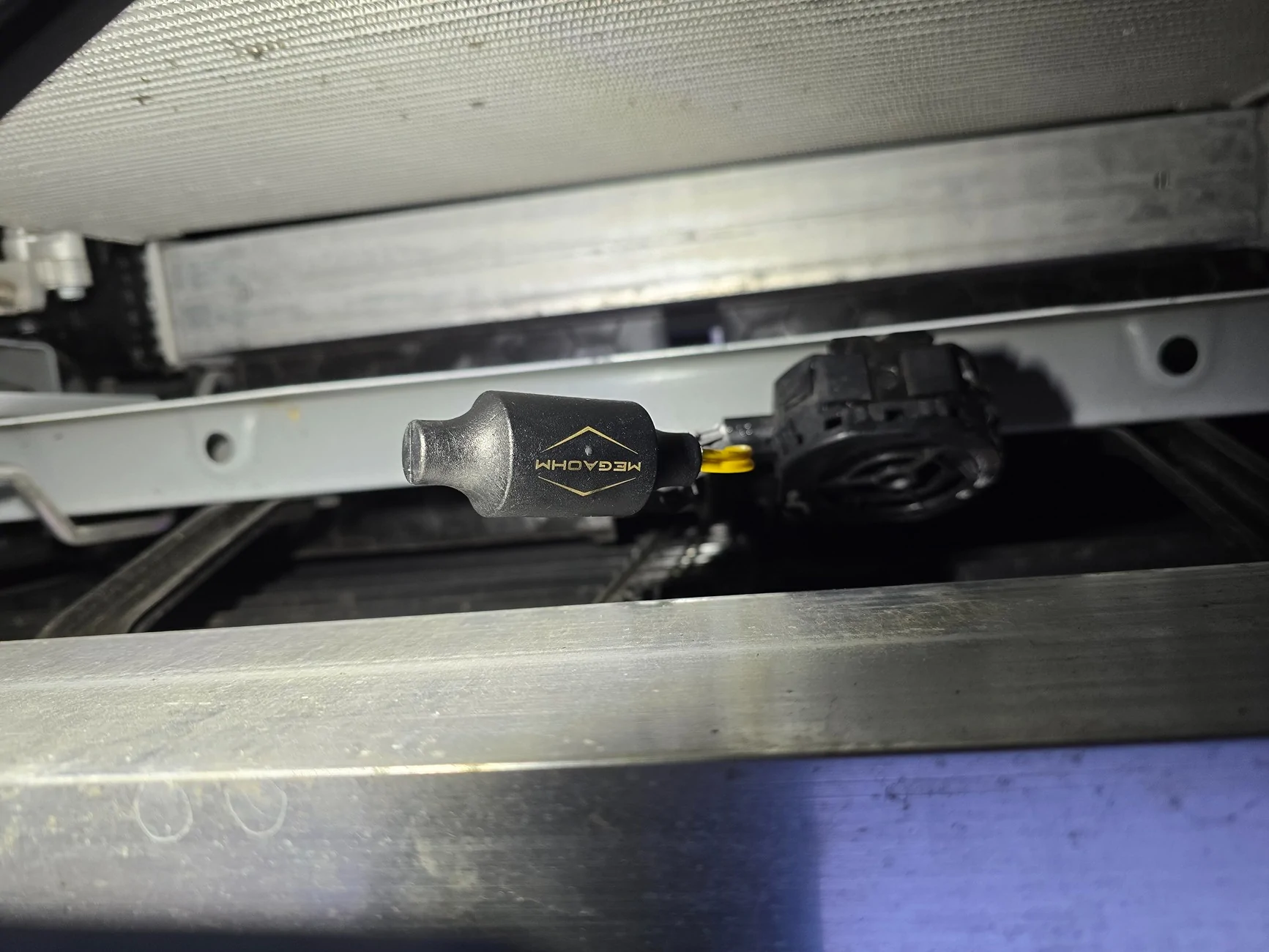

So no one will hear you while driving under battery power?....ok

Could drive in tow haul mode would keep the truck from turning on amd off along with jetsons noise coming on.
The fan is pretty loud and you can still hear the hybrid motor... Trust me there is plenty of noise without this thing.

I'm fairly certain they are required to emit some sort of sound while driving for pedestrian safety.
It makes plenty of noise without this... There are some non-hybrid 4cyl vehicles that are quieter.
True. If I had my druthers, I’d change the sound from Jetsons to riffs from the bands of Donna Summer, Joan Jett or Prince. Oh, I’ll be modern and add Taylor Swift.

Trying to make sense of this. You installed a resistor in place of the hybrid noise maker? Where can i buy that resistor?
Yes, it's required by the DOT for that reason. By disabling it, if you are in an accident and the Insurance Co. Finds out... might not be the best move.

Is it easily accessible crawling under the front of the truck? I'm probably going to try a piece of gorilla tape over it first, should cut the sound at least by half. Works well for backup beepers on equipment
You can easily slip your hand between the skid plate and the front bumper.
I tried gorilla tape and it actually worked pretty good..
