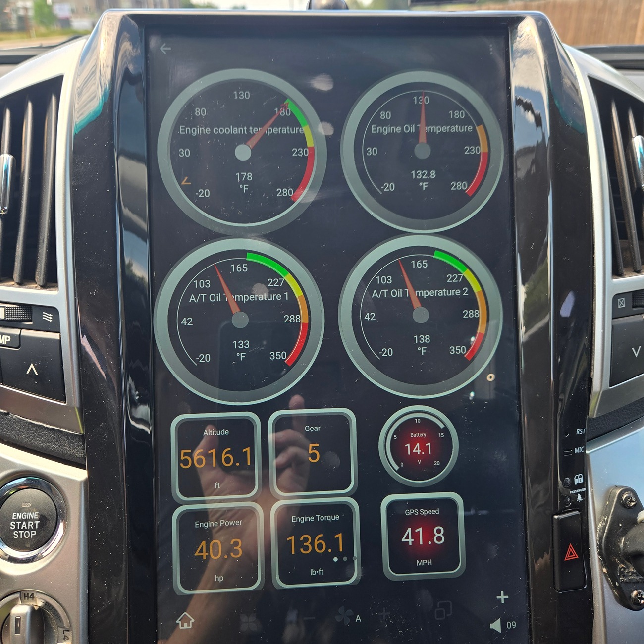

When your transmission temps get high, are you in Drive? I had an issue with my 200 series Land Cruiser in Drive while towing the transmission would overheat up Mtn passes. Turns out the tranny is hunting for gears in D using the computer. I switched to manual 5 when towing and havent had thee problem since. Note when in Manual 5 on an auto tranny, it will still use gears 1-5.
Note sure if this is applicaable to the Tacoma, but might be since same manufacturer
I also use OBD Fusion and monitor transmission temps along wwith several other items

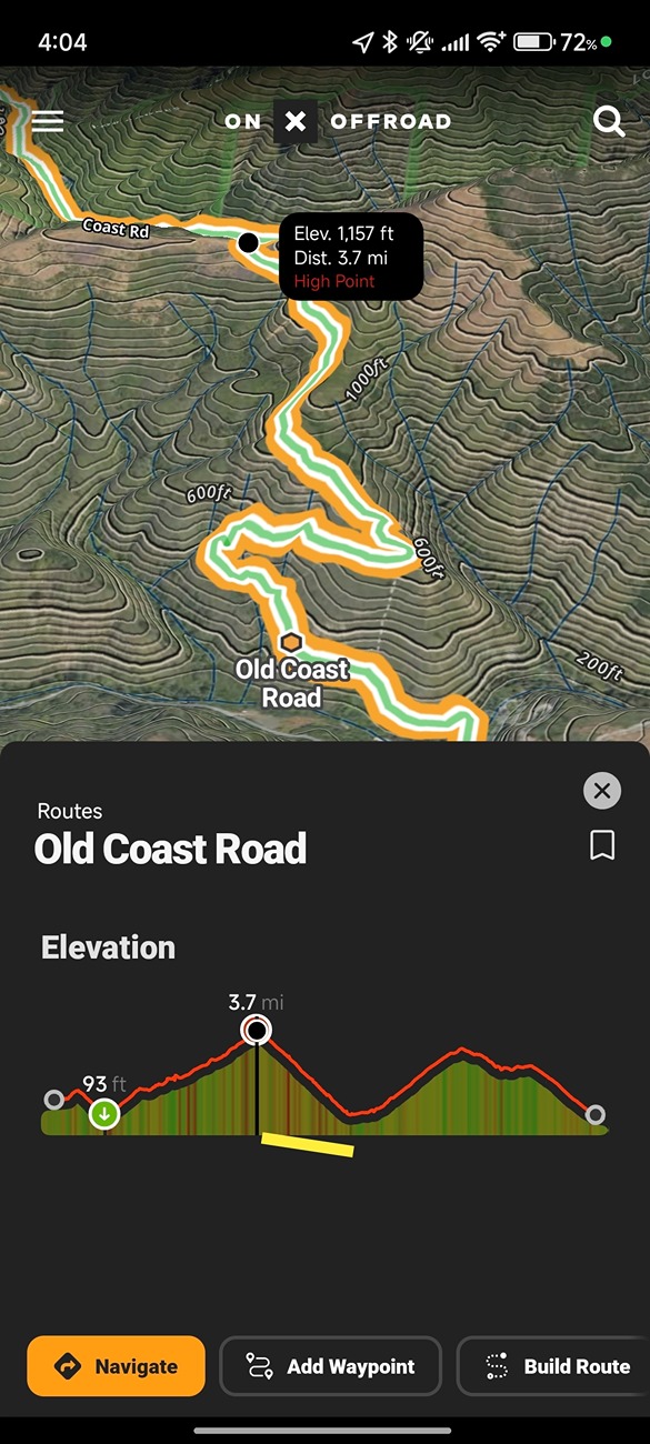

I actually did a little experiment with this today on a trail, drove the entire thing in S1, since the trail was best at around 10mph.
I noticed on the longest climb of the trail the trans temp got up to 240F, as indicated by my Scan gauge, which was about 3/4 the way to the red bar on the cluster trans temp gauge. It never overheated but I was curious if it would stop climbing, didn't find out since I summited the peak and then we were descending.
I didn't feel like the climb necessitated 4Lo because it wasn't that steep, and I assume at 10mph the truck can just lock the torque converter anyways and reduce the heat being pumped into the trans.
RPMs were around 2000-2200, so a fair amount of coolant being pumped through, when I bumped it into D it immediately shifted to 2nd.. which seemed too low for the grade, which I calculated at about 10%.

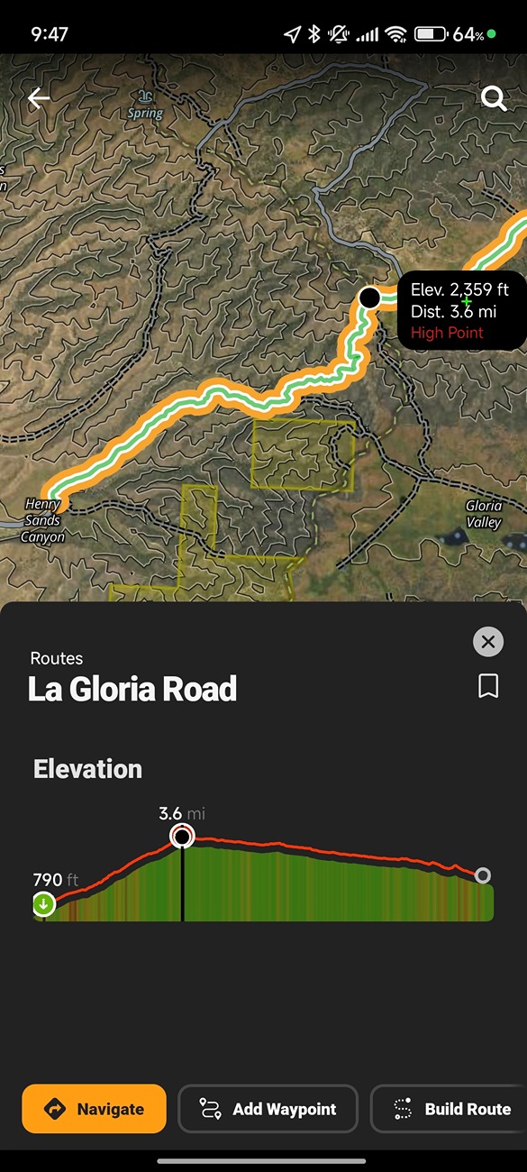

We're going to go up La Gloria road Friday, I'll use the "current gear" gauge on my Scan Gauge and see what it does in S mode.
