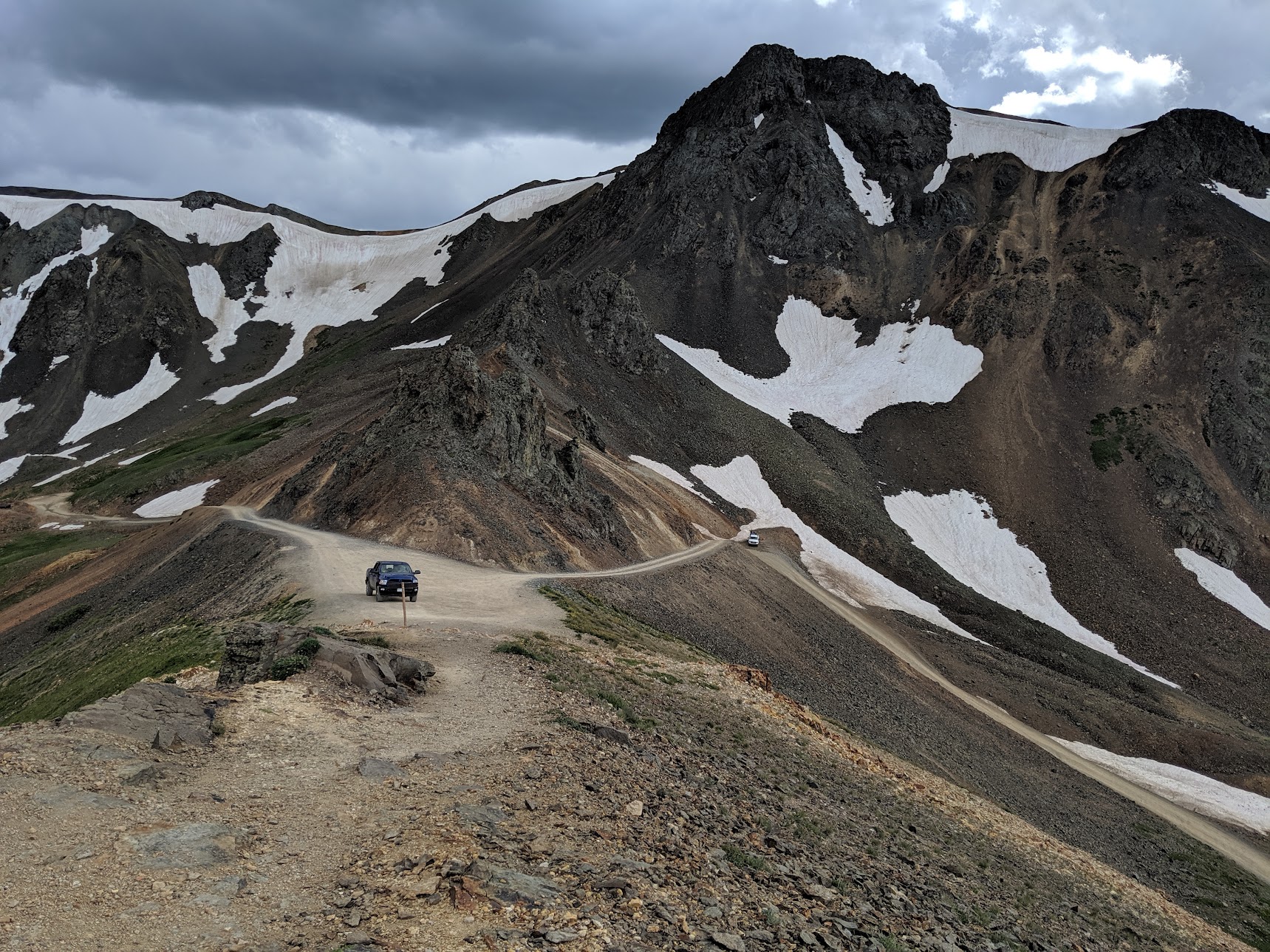

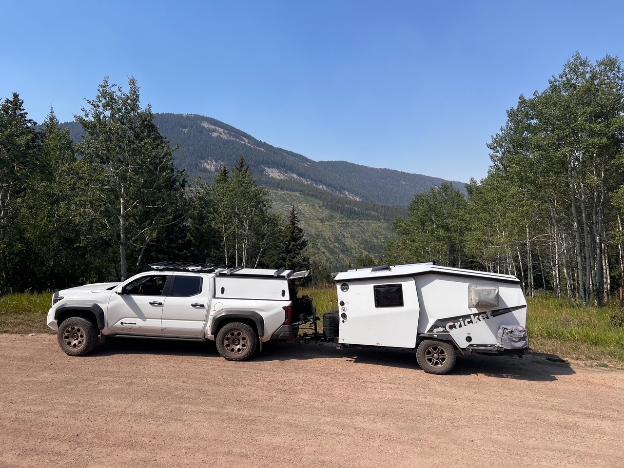

So last couple of weeks, I drove from 4000ft to 9300 ft paved to 5500, then dirt the rest of the way up. Cat scales had me at 9300 lbs across three axles, most of which is gear in the back, the trailer axle is about 2300. You can see it sitting down in the rear. After watching this thread, I was watching the transmission temps on the way up. Its about a 35 mile dirt road, all but the last mile or so is 4HI. On this section, the tranmission temp did get about 2/3 of the way up the scale, but after I saw it start to climb past half, I shifted into the manual gears and was already in tow/haul which keeps the transmission one gear lower than normal anyway. Moving to the manual gears and shifting through these to keep the RPMs around 1900-2300 stopped the temp climb. Once I got into the 4low areas, and slowed down the temps gradually dropped. This seems to feed into the theory that the auto shifting might be what's causing the problem for some of these transmissions.

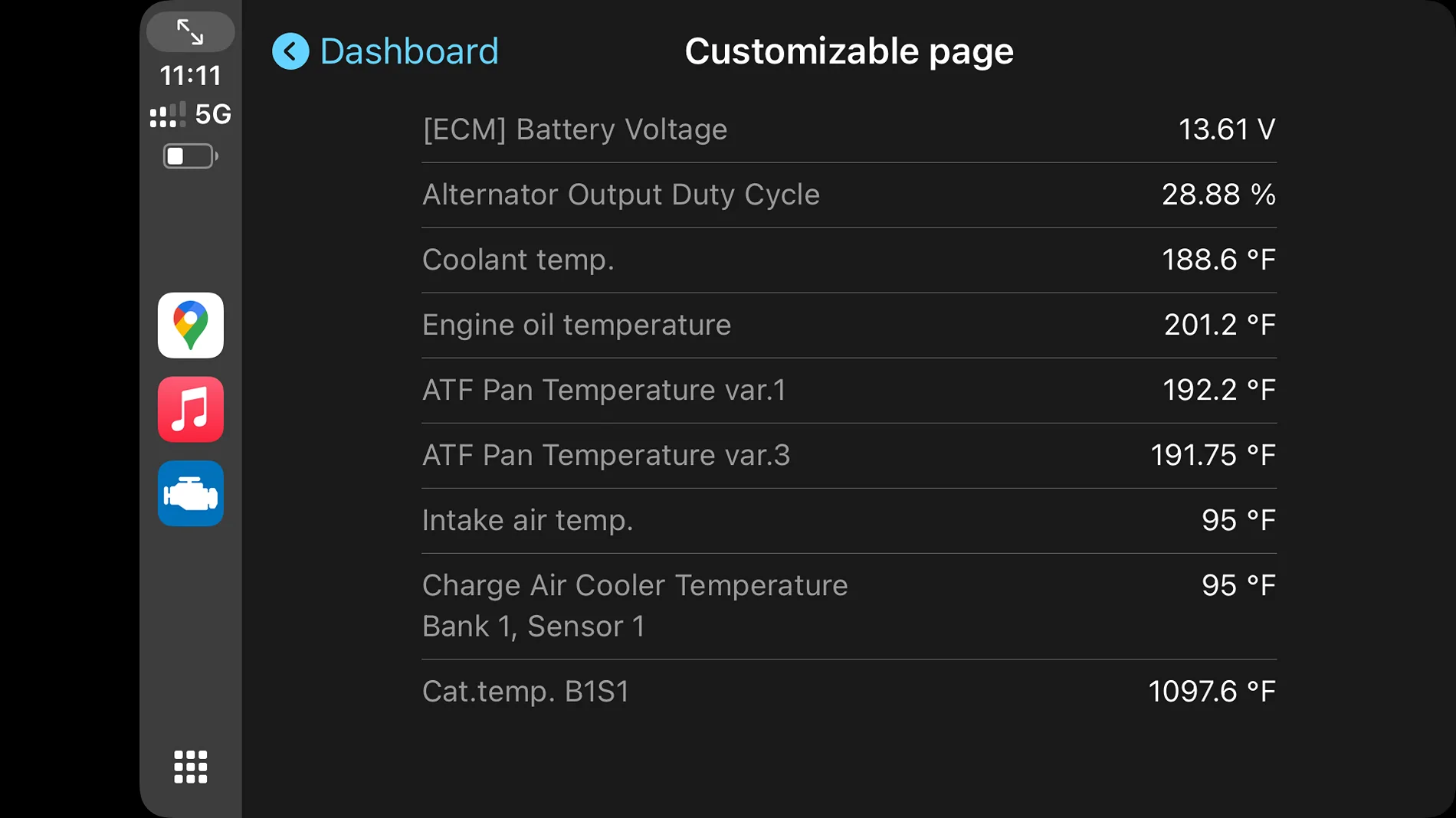

Coming from a 1st Gen V6, this little hybrid 4banger doesn't engine brake for shit, however, I have noticed that on long highway descents (think I-70 back into Denver) in drive, the engine will downshift one gear, and it does brake using the hybrid system (you can feel the braking, but the brake lights aren't activated.) I suspect that when you use the "brakes" while descending off road in manual, that it is also using the regenerative braking system, and I bet that it would be difficult to overheat the normal brakes with a hybrid system.
So the idea is that we use the manual gear selector, keep it in a lower gear with higher RPMs on long 4wd climbs. It’s funny because I typically would avoid that to avoid overheating the engine. I will go test my climb spot again redlining 2nd gear and see what happens.
Yea, I'm nowhere near redline (6Kish) I'm normally puttering along between 1800 and 2300, which seems to be the smooth mostly quiet range. If left in D, it would drop down to 1300-1500, and I think that's where we are seeing the heat issues. Remember the engine isn't overheating, the transmission is. And those lower RPMS and high torque load really heat up the transmission.
Also, I have a trailhunter, which I suspect comes with some sort of transmission cooler due to the integrated towing package. This may be why I didn't overtemp, in similar conditions to OP.
