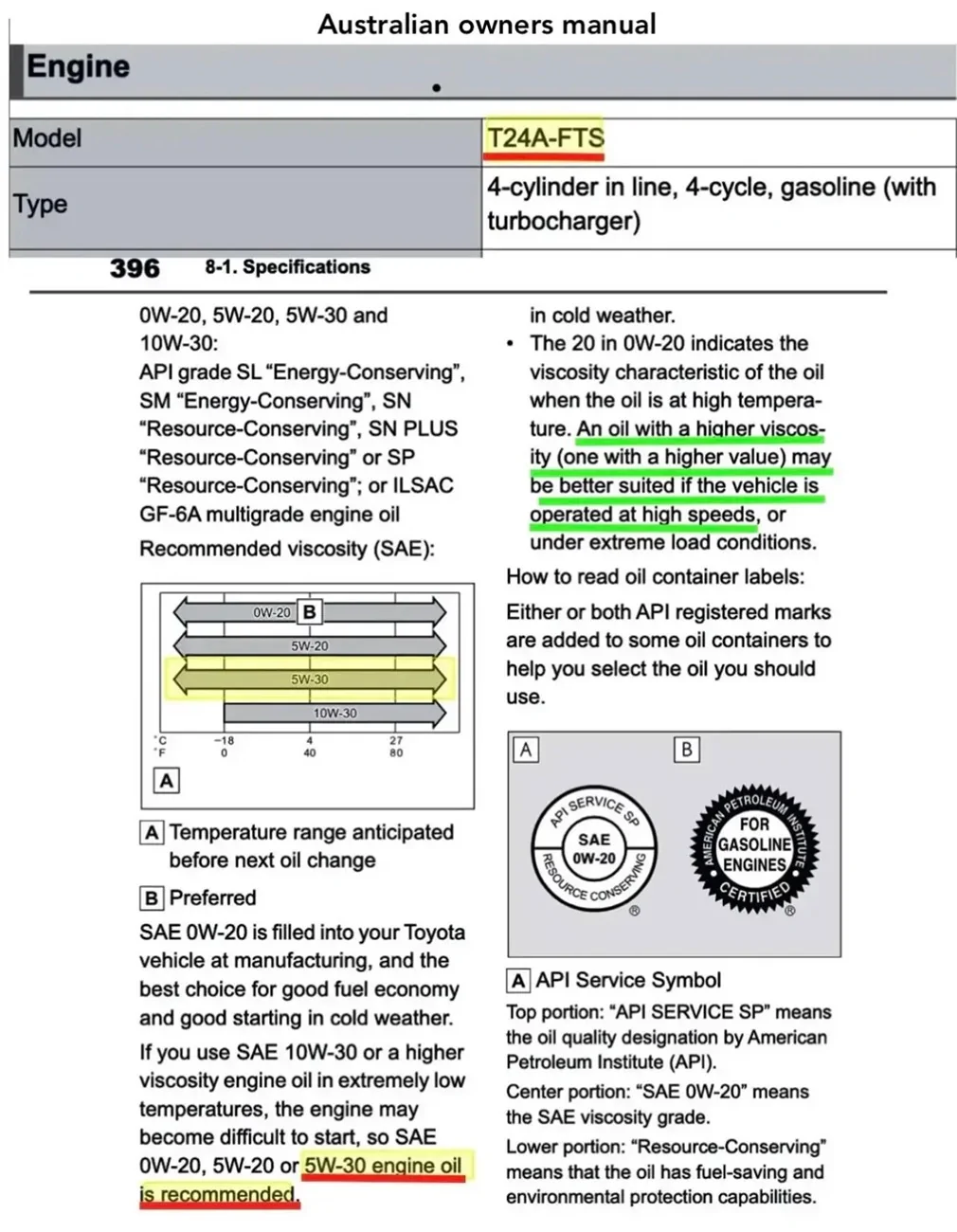

For countries that don’t force fuel economy upon the entire manufacturer’s vehicle platforms…. From the vehicle manufacturer’s own suggestion(s)…

It doesn’t say only 5W-30 is recommended. It says 0W-20, 5W-20 OR 5W-30. All three are recommended over 10W-30 or higher. I read it to say for the general public who uses it as a daily runner and does not push high sustained speeds or under extreme load conditions, the preferred oil is 0W-20 which is the factory fill. To me all three seem fine for the truck And up to your personal preference. Also it seems like they prefer B. But allow you to adjust depending on your indivisual use case.
All the oil viscosity options oils are suitable but for various temperatures, with significant overlap. Thinner oils are more thermally conductive but generally fail at temperatures that thicker oils can still provide film strength. When towing near Yuma in August, I’ll run an oil spec that Toyota recommends, but not for the United States market. The more oil samples of various viscosities and brands, that are submitted for this engine, will create an empirical data set that we can all appreciate

That may be but what I was pointing out is your highlighting is misleading since it appears you are inferring that it is THE recommended oil when it’s not what the manual says at all. And as far as I know Australia is not subject to cafe but they still recommend and factory fill 0w-20.
I run a combo of 5w30 and 0w20 since I do occasionally Offroad. And I do oil changes every 3,000 miles. 5,000 at most. Just my personal preference.

Re read your pdf. Based on it, the Australian Market vehicles are prefilled with 0W-20. Preferred is 0W20. 0W20 OR 5W20 OR 5W30 are recommended over 10W30 in certain conditions. Higher than 20 viscosity may be used if you run at sustain high speeds or extreme load conditions.
So if you’re filling based on the Australian market and NOT US market, you should be using the listed preferred oil which is B 0W20.
I personally think all three they listed are fine. But if you want what Toyota prefers in Australia then you should be using 0W20.
