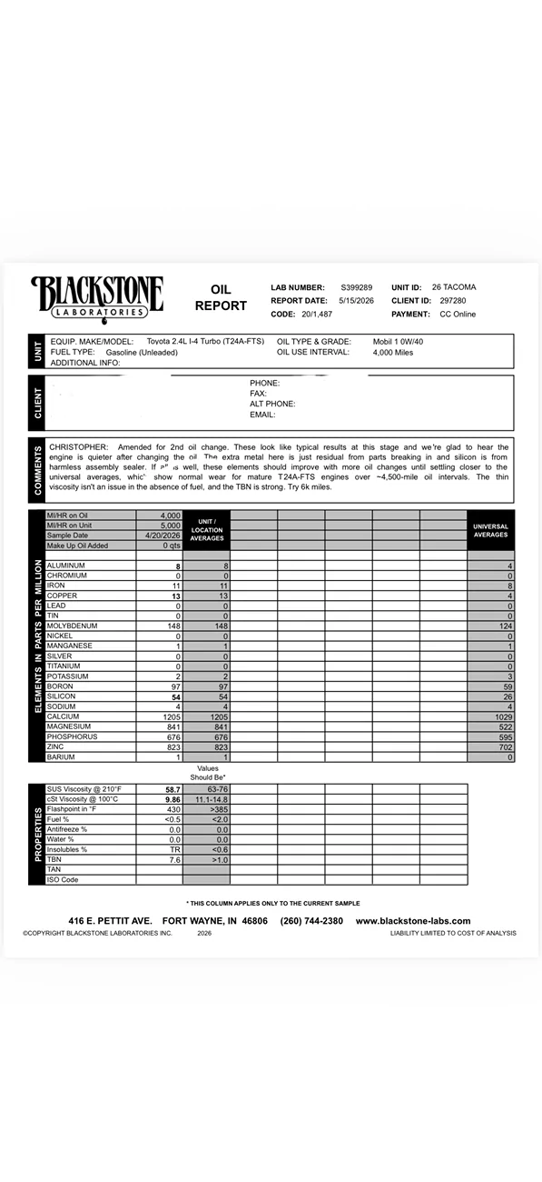

How does 0W-30 or 0W-40 fit into this? Seems like it solves both ends.........flow in the cold and protection in the hot.
I’ve been using 0W-40 in mine. My partner and I have VW/Audis that we’ve put serious miles on with original Turbo and Timing chains(one has 325k miles).
They all use 0W-40, not saying that it’s the reason for their long life but it is easier to have one oil for all cars. The Tacoma is doing exceptionally well and has gotten a lot quieter since switching.
I did a UOA after 4000 miles of M1 0W40, the engine was still too new to get much from it, but it is a good base point for future UOA

UOA can't tell everything and the accuracy of the results can depend on who does the testing. I know there's some hate out there for Blackstone. But I'm genuinely curious as to what Lakespeed finds with his Tacoma. I'll be watching it closely. Personally, I agree with some of his initial assessment. If a 0w20 can stay in grade, it's fine. But that's a big if. If you live in a cold environment and idle and/or short trip frequently, I don't see how that oil wouldn't become diluted and fall out of grade.
