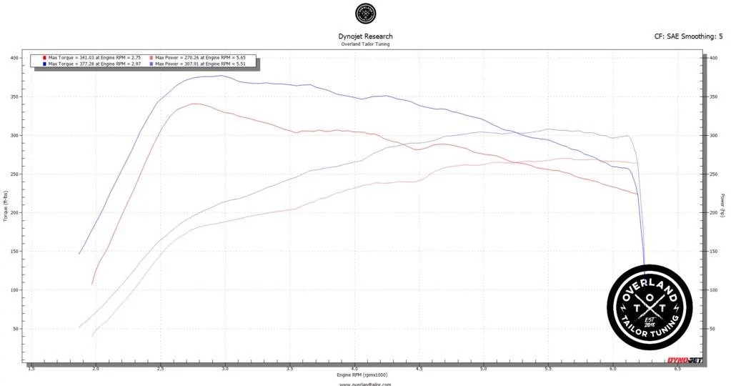

The wall of torque in the dyno chart is anything but understressed ?
Hope Toyota made the bottom ends stout. Guess we will find out lol definitely never tuning my truck.
Edit:
125hp/Liter post tune is no joke, that's more than an EJ STI. Those exploded for entirely different reasons, but were in no way an "understressed" motor. They also had the benefit of shorter OCI (Subaru recommended 3,000 miles), thicker oil, single scroll turbo tuned for higher RPM torque, and lower compression (reduces risk of knock/LSPI), and despite all this still sometimes blew up ?
These offset rods better be good shit ?
Edit:
My GLA45 had approx. 200hp per liter. And then I tuned it after that. Never an issue.
125 is nothing. Also, thanks for dropping in to tell us all you’re not interested. :facepalm:
