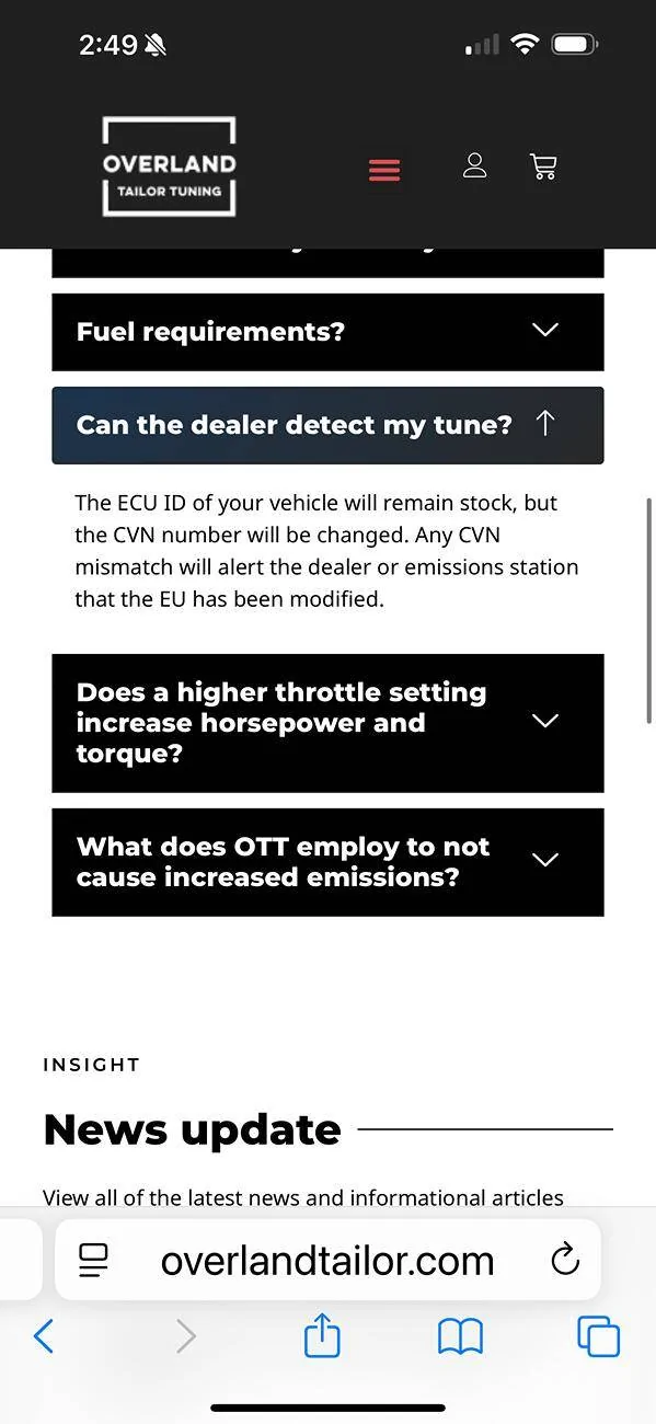

@JustDSM, was just reading thru FAQs on the website in anticipation of getting tuned today and saw that the dealer can recognize a change in the CVN number within the ECU. What is that and how does it apply to the 2024 ECU?

Seems like it's basically the ECU checksum.

Great question, and I appreciate you doing your homework ahead of time.
There’s a lot of misunderstanding (and sometimes intentional misinformation) floating around when it comes to flashing ECUs. One of the more common myths is that aftermarket tunes somehow “flag” the ECU in Toyota’s systems or trigger a red flag for dealer software. That’s not the case with our calibration.
To clarify:
Our tune does not trigger a flash counter, leave behind a flag in Toyota's diagnostic tools, or show up in Techstream as anything out of the ordinary. There’s no “tuned” status that’s stored or transmitted in the ECU after flashing.
Now, regarding CVNs (Calibration Verification Numbers) that’s a separate matter. Every calibration Toyota releases has a unique CVN. When we apply a new calibration, that CVN will naturally change. But here’s the important part:
There is no master database of “correct” CVNs that dealership techs reference. With tens of thousands of CVNs across all models and configurations, it’s simply not feasible. Technicians are paid on a flat rate and generally focus on resolving the issue at hand as quickly as possible. For them to notice a CVN difference, they would need to 1) know what it was supposed to be for your exact software version, and 2) be looking for it, which in practice, they just don't do.
What you saw on our FAQ page is us being upfront and transparent. We're not in the business of hiding anything or pushing people into something they’re uncomfortable with. The CVN change is simply a technical reality of modifying a calibration.
For what it’s worth, we’ve only seen CVNs come into question during emissions testing in certain CARB states. The good news is we’re actively working on CARB EO certification, which will make our calibration compliant across all 50 states, including those that currently require strict emissions conformity.
Hope that helps clarify it!
