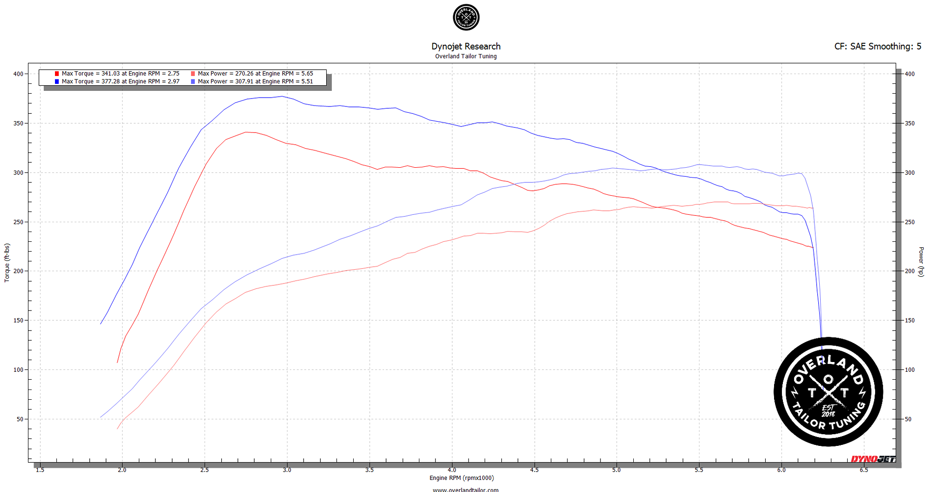

What does it improve on a manual transmission?
At a high level, our calibration delivers a big jump in overall performance for the manual trucks:
  • Faster spool-up for improved low- and midrange response
  • Significant rev-hang reduction for a more connected driving feel between shifts
  • Sharper throttle response without being jerky
  • And roughly +30whp / +30wtq across the entire RPM range
    2024 Tacoma Has anyone done the OTT Tune? TRD Offroad Stock vs OTT Stage 1
For manuals specifically, our upcoming update (rolling out next week for all gas-only models) adds a few important changes:
  • Neutral rev limiter raised from 3,300 to 6,300 RPM
  • Main engine rev limiter raised to 6,300 to match the automatics, letting you use the full power band instead of being forced to short shift early
The result? You get the full output potential of the tune, smoother and more natural shifts, and a truck that feels far less “held back” compared to stock.
