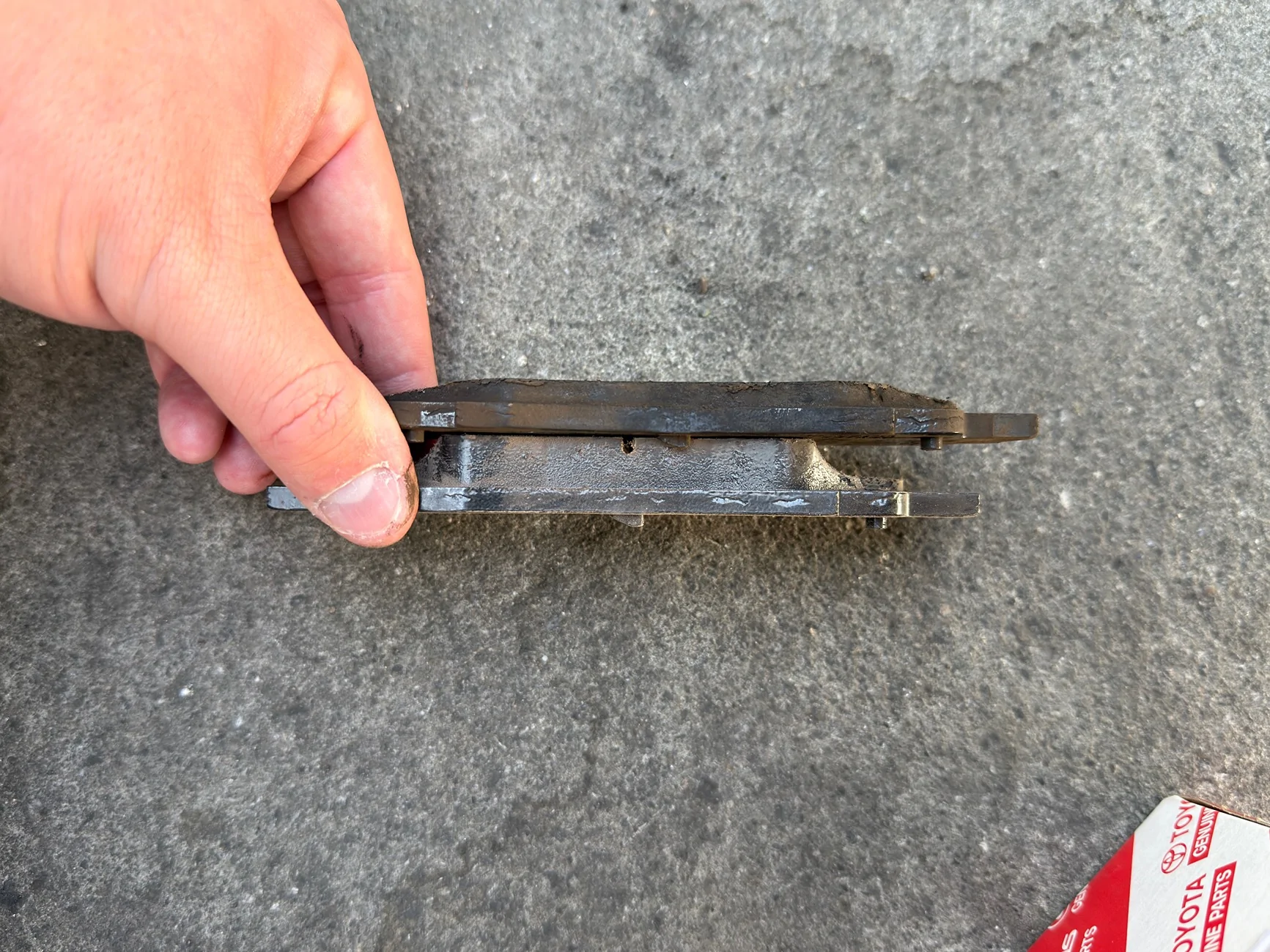

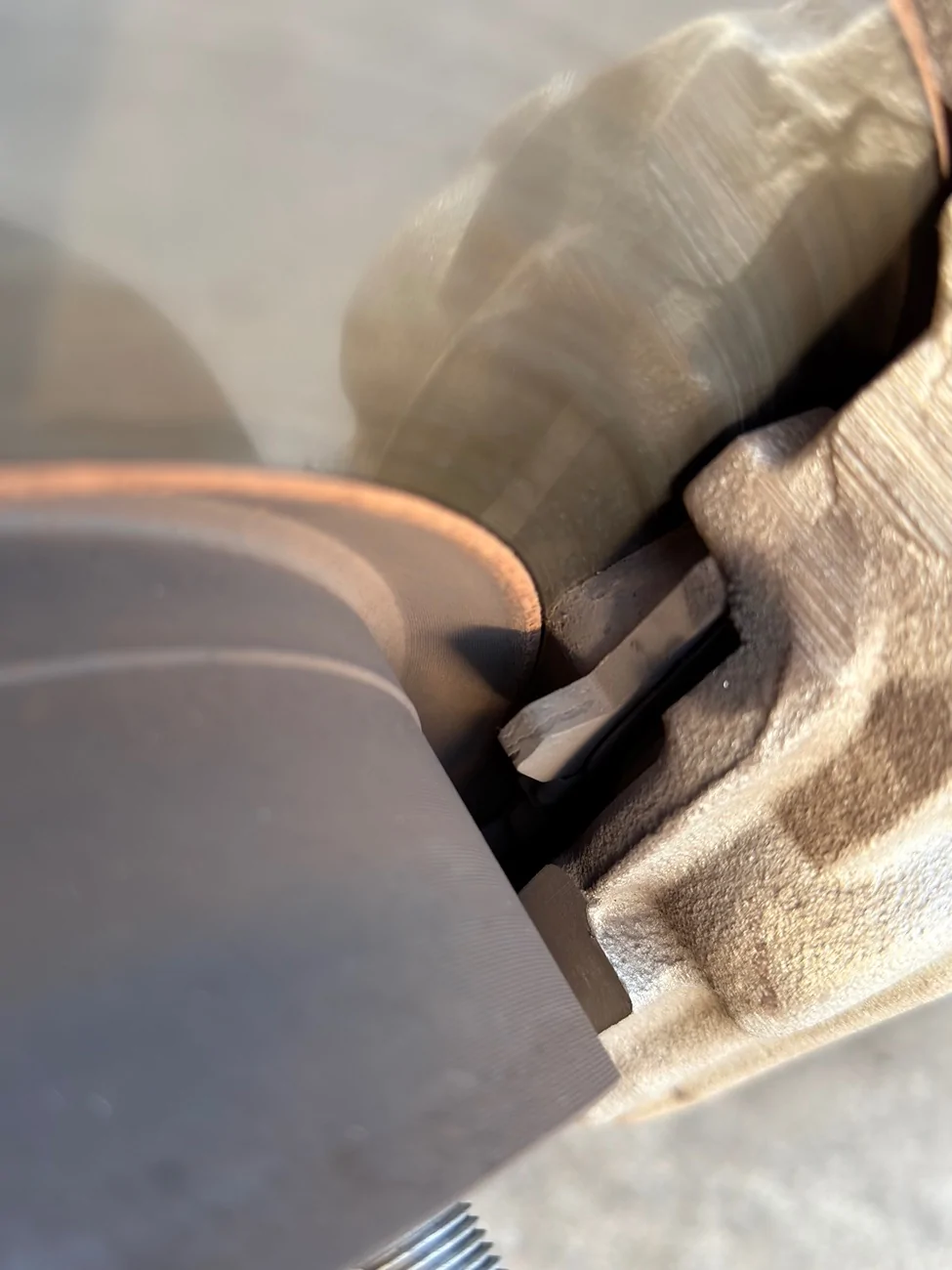

Hey guys! I got a 24 Limited and currently is 29K miles, as of right now my front break pads is still have around 70% but my read pads all gone, see attached for rear pads. This makes me and my technician confused. It should be front replace before rear one, mechanic guys said he never see this before, generally front will be replace before rear one. I didn't tow and load heavy stuff every day, just a daily commute drive. Is this normal or someone have same issues? Thanks!

I also posted about this in a different forum. I am at 35K miles and the dealer when doing my recall said I only had 3MM left. Of course they wanted to change them out for me. I passed and taking it to my indy this week to see if they truly are gone or typical dealer making shit up. I do not keep cars very long. Usually sell them by 60K. I have never replaced rear brakes on anything I've owned. I thought it was crazy at 35K to be done.

70% of stopping power is in the front brake and the rear tends to slide more causing more wear from less stopping .

I only use this less than 10% time and I turned off the function to automatically break by itself. that's weird, generally front will last shorter than rear one.
Braking by itself to avoid a collision uses the front brakes. It uses the rear brakes for things like lane assist and other things. So if you have that on you are actively wearing the rears.

@Sner's post about huge rear brake bias due to the active nannies was an eye opener.
