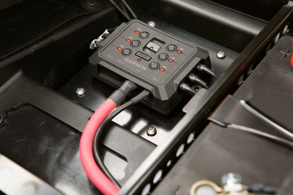

I don’t have a desire to add AUX switches to my Sport since I use the Bluetooth Garmin PowerSwitch which utilizes control via an iOS Garmin app or on CarPlay. I’d like to ideally be able to control the reverse white light function via the PowerSwitch.
The PowerSwitch has 6 controllable lights on one unit with a 6 “positive” connection points on it. If that helps…

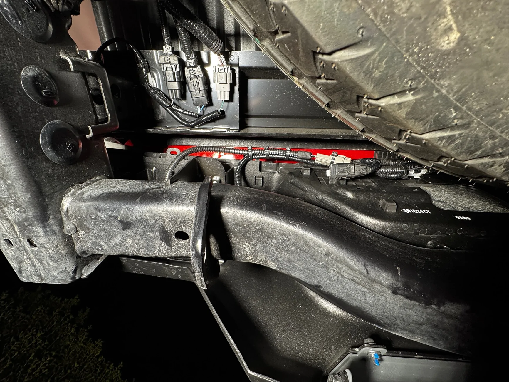

Curious, is this the connector you were talking about on the bumper? Just capped off by the license plate light. I forgot about this one.
I did end up removing the tail light harness last night and got a ground added to it. Wasn’t too bad to do and I rewired that main harness to split directly to the lights. Once I get my Deutsch connectors I’ll repurpose to correct lengths and make permanent connections and be done.

Ok.
So what I meant by "connector" is that the trucks that CAME WITH switches and the ARB Bumper included a connector that was wired from the front engine bay to connect to the built in switches. So you don't have to run any wires with those at all.
If you don't have that (and you don't) I said you can just plug in our extension (Link Below)
That HAS a ground built in. It replaces the ground ring.... as shown in the photo BELOW the link...
So you don't need to connect it to the tail light if you run it to the switches you added in the engine bay.
You simply feed the harness UP your frame (Inside like a piece of pipe if you want) and bring it out by your switch wires and put the ground under any bolt.

I see now how the ground could have been handled upstream, but since I don’t have any switch-related wiring or logic under the hood, running a long harness forward just for that didn’t really make sense for my use case. Especially since the goal of using the tail-light harness was to retain the automatic park and reverse functions — moving everything forward would defeat that and essentially turn it into a manual-switch setup, which I was trying to avoid.
I ended up reworking the tail-light harness Friday evening and it’s now doing exactly what I wanted. Aside from swapping the Deutsch connectors once they arrive and shortening a few runs per light, it’s complete and working well. I eliminated the short rear harness entirely by extending the tail-light harness outputs to each light and splitting the circuits where needed. It was already long enough to do this; it just didn’t have enough outputs originally.
I’m a bit picky with grounds in the rear of pickup trucks, since the frame isn’t a true ground and the bed often isn’t officially bonded. While bolting to the frame can work for small loads (and did here), there isn’t a guaranteed factory ground path back there, so I prefer using an existing ground circuit that was designed for the purpose — in this case, the tail-light ground. I also prefer keeping everything contained within the harness rather than having a loose ground lead to a bolt.
Appreciate the suggestions — this approach ended up fitting my goals best and is working great.

Here’s the finished result. Shortened runs, integrated ground into tail harness, removed extra splitter harness, loomed and routed cleanly with the bumper harness.
2024 Tacoma HOW TO: Rigid SR-L Series Lights for ARB Rear Bumper Installation IMG_2138
2024 Tacoma HOW TO: Rigid SR-L Series Lights for ARB Rear Bumper Installation IMG_2134
2024 Tacoma HOW TO: Rigid SR-L Series Lights for ARB Rear Bumper Installation IMG_2140
2024 Tacoma HOW TO: Rigid SR-L Series Lights for ARB Rear Bumper Installation IMG_2143
2024 Tacoma HOW TO: Rigid SR-L Series Lights for ARB Rear Bumper Installation IMG_2142
