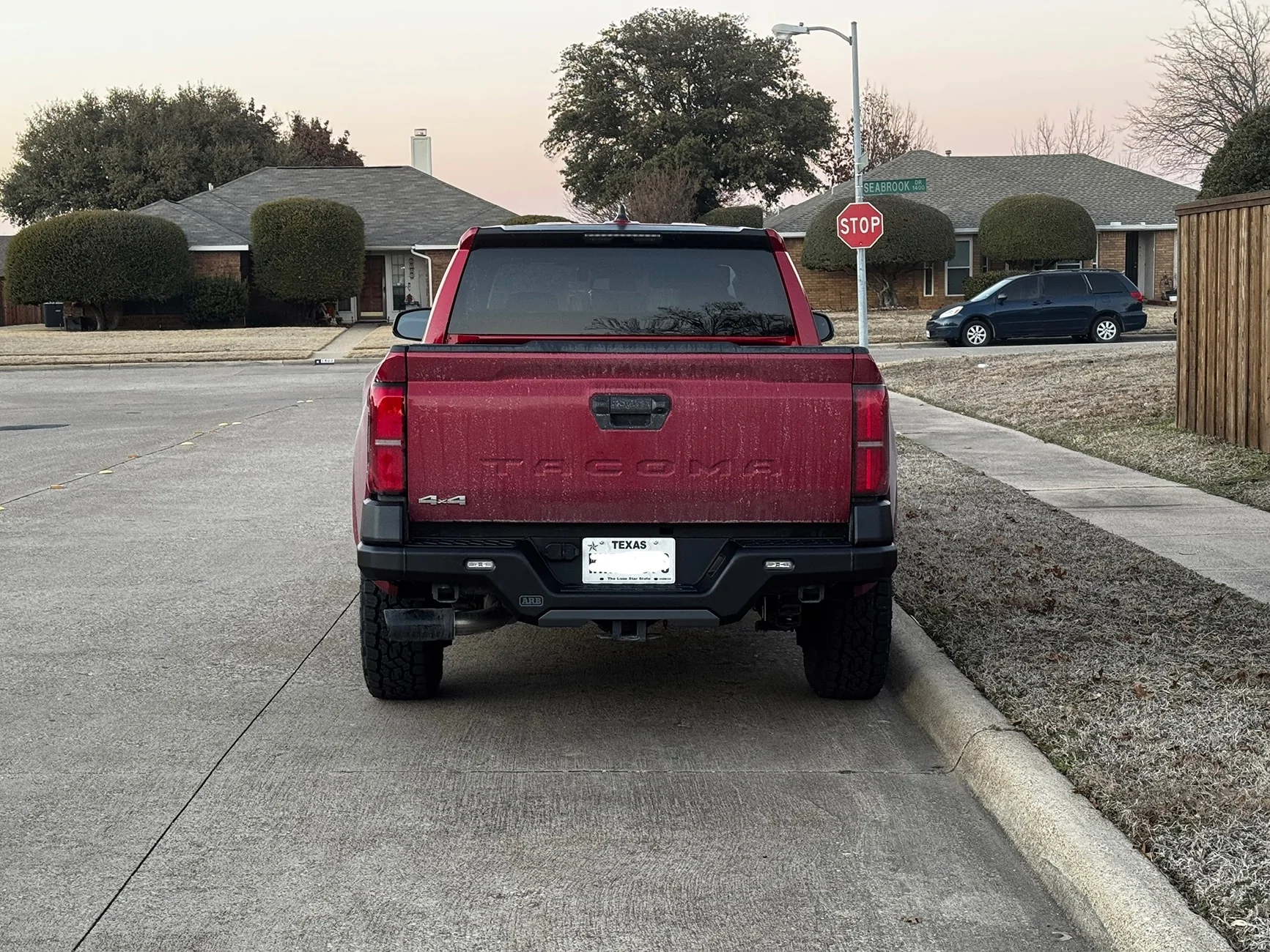

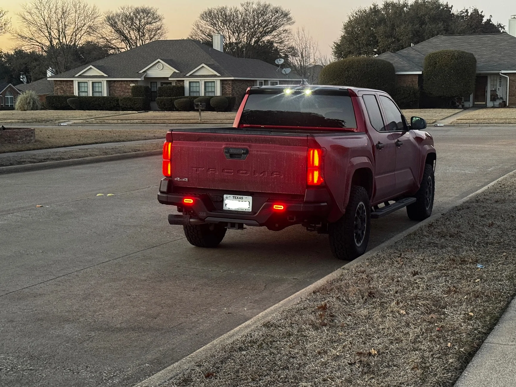

Thanks for the write up. Swapped my bumper today and installed the SR-Ls right after. For anyone wondering, you don’t need to pay much attention to Toyota’s warning that this bumper doesn’t work with the SRs without BSM. It works fine, it’s just that the harness doesn’t fit the bumper perfectly where it clips in. It can be made to work just fine and while I am not using as many clips as I used to and may adjust the clips to improve that, it is perfectly safe as-is currently.
Not to disparage SPV as I appreciate what they are doing to support the market; however I wasn’t thrilled with the harness. I went with the simple tail light tap because I don’t have aux switches and don’t feel like adding them at the moment. It was significantly longer than needed and required looping it into a bundle to waste slack. Also not a fan of weatherpack connectors or the ring terminal needing a bolt for ground. I’d rather it pull ground from the tail light T harness. I’m running it as-is for now so I can benefit rom the lights immediately, but I’ll probably rewire in the near future. Also tapping at the tail light is a pain (sort of bulky to add the t-harness behind the tail light). I might use the trailer connector option if I redo it myself. Probably will use Deutsch connectors as well if I redo it. Again, I appreciate that SPV fixed up what Rigid offers and that they are supporting the market, I just wish the harness was done a bit differently and was more precise than mine was.
The results are fantastic and I couldn’t be happier with the performance of the lights or appearance of the bumper. Sure makes a base model truck look cool.
Next up will be to remove that ridiculously out of place 4x4 badge and install my black tailgate inserts.

Looks good Just plastids the 4X4 and it will blend in better.
BLtheP
Apr 12, 2024
248
185
TX
I don't like having a badge on one side and empty on the other...looks asymmetrical. I'd rather just remove it, plus with the Tacoma letters it starts to look sort of busy keeping it.
