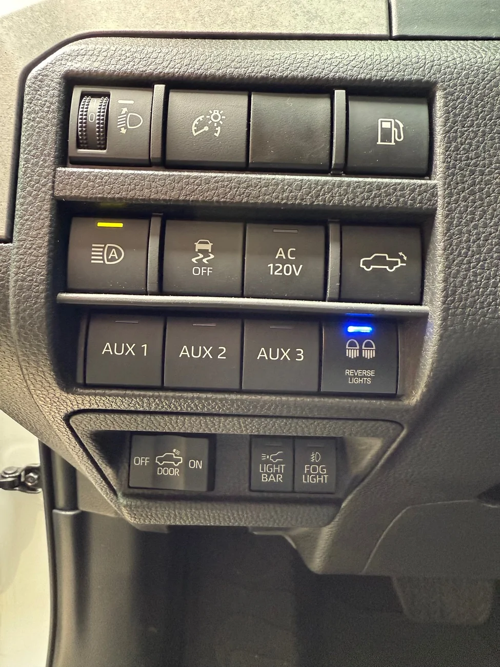

I finally finished up with the wiring on these lights for my 2025 Tacoma Pro following the instructions closely. Everything works as it should but for some reason mine turns on manually using Aux 3 instead of Aux 1. From what I’ve read these lights only draw 1 amp and Aux 3 is 5 amps so I should be good but I’m wondering what I did wrong. Is there more than one 4 pin to 2 pin jumper under the hood? Or is it possible that I hooked up the white wire to the plug that plugs into the back of the truck but didn’t need to according to instructions since I received the pigtail that goes into the tail/parking light. I would unwrap it to check but since it’s working fine in Aux 3 I just want to make sure I’m ok. Thanks!

I’ll have to look at mine, but I think it’s on auxiliary three also.

The pigtail that I used for the rear is using AUX 4. The pigtail is in the bag with two pigtails in the same bag. The paperwork that is included with the pigtails shows the amp draw from each colored wire and I wired the ground to ground and the 10 amp to the red wire (main light) iirc. the white wire would be for the outer red halo light and is not required
Thats the same pigtail that I used. I guess working off Aux 3 isn’t a problem if everything works as it should, correct? These lights only draw 1 amp, so 2 amps at the most.
Yes you are correct. I guess you used the other wire from the pigtail that would go to AUX 3? Just means you hypothetically still have AUX 1,2 and 4 available

On my 24’, I got 3 bags of harnesses … I used the one that pigtails into the rear but also has wires available for my other 2 aux switches (so 1 harness handles all 3 switches)… so my question is why do I have these other 2 bags of harnesses

Depends on where you are going to connect (under hood, in cab or by the bed). Also the 2024 rear pigtail is different from the 2025 pigtail.
