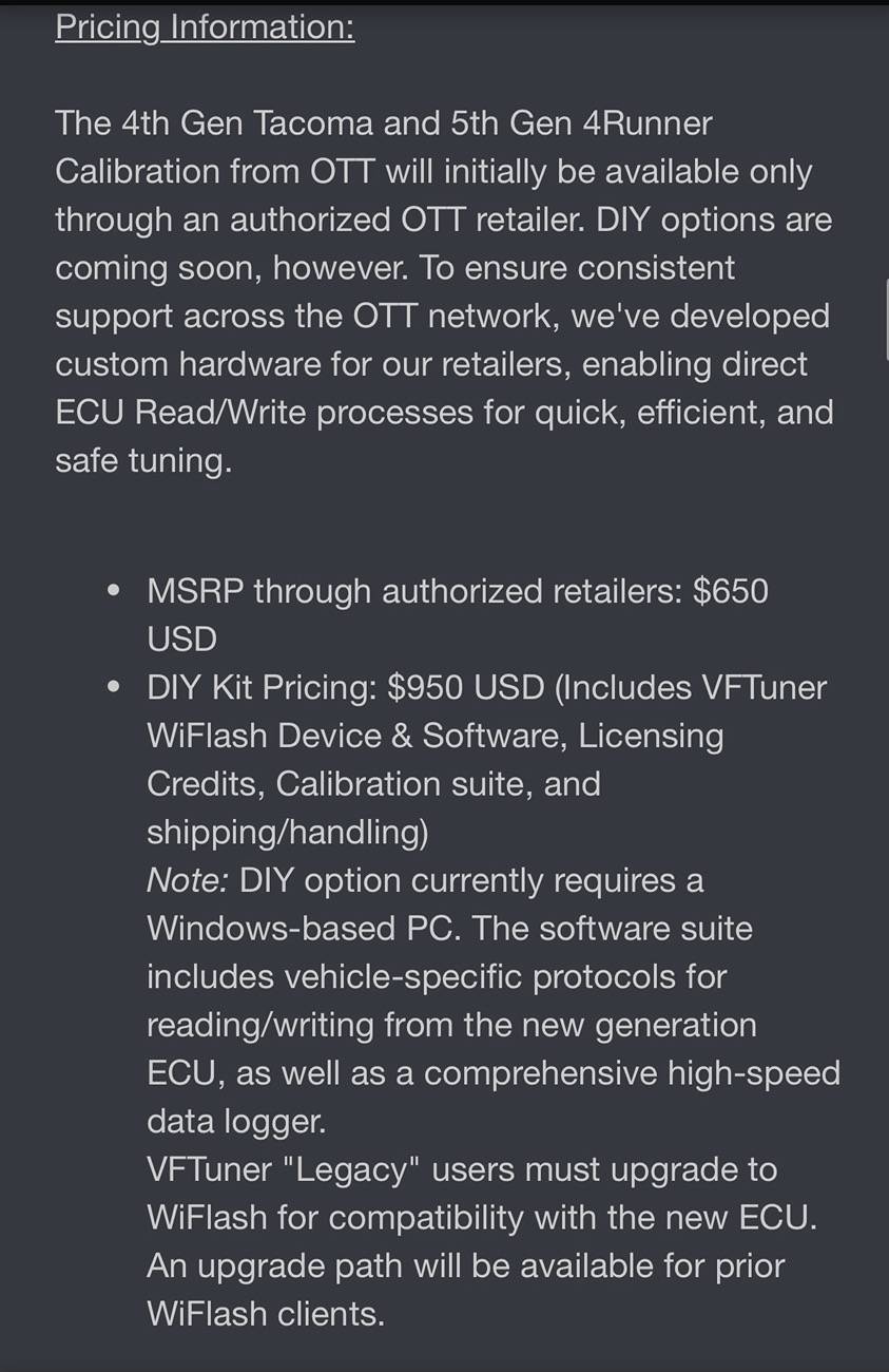

@JustDSM One thing that needs to be apparent, is that if you live in California you have to pay $700!!?

Our MSRP is $650.00 USD
We do not control or manage retailer pricing.

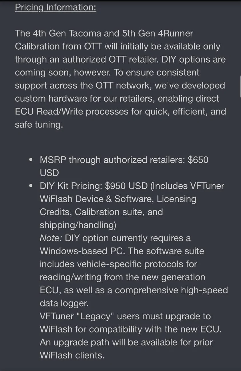

We do not control or manage or control retailer pricing.
Damn you CA. But right on. Going to get it tuned next weekend. I also was wanting to find out when stage 2 will be released ?
