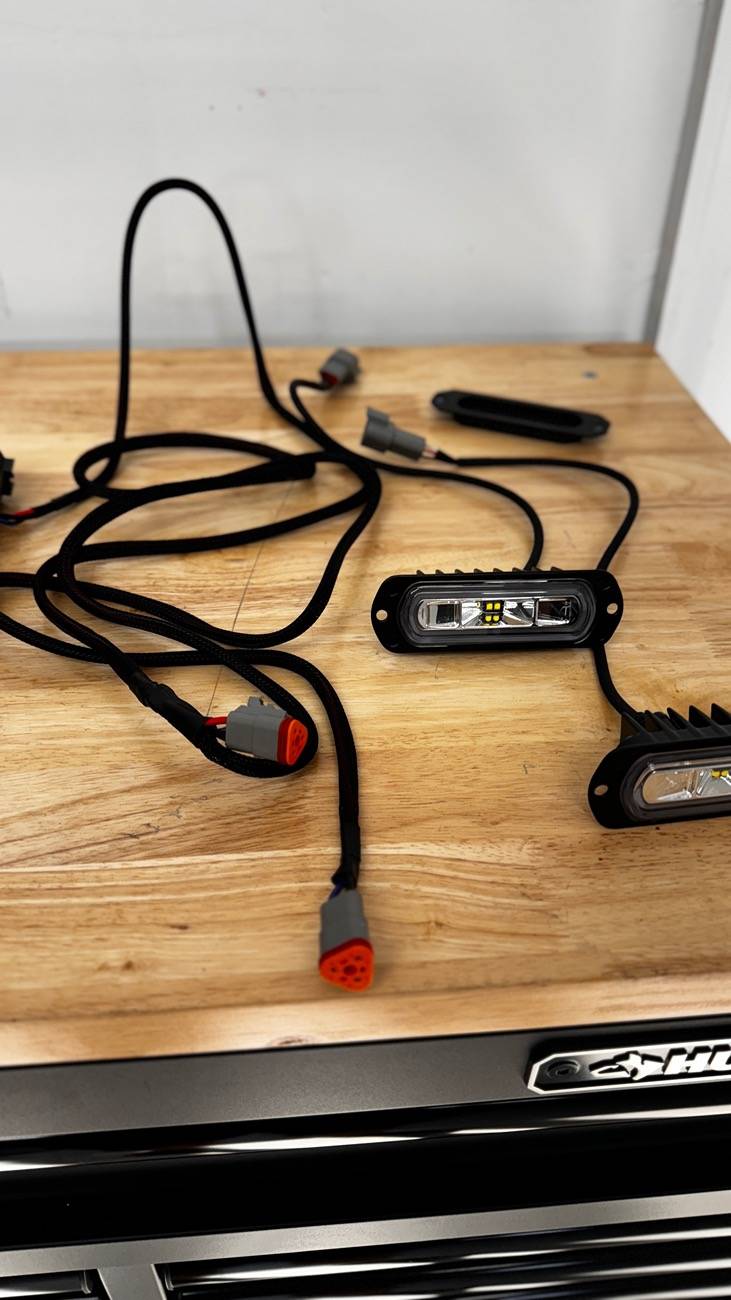

Rigid worked with Toyota on this kit to insert into the ARB rear bumper. They have blank inserts as most of you know to remove and you can replace with the lights.
The kit comes with a Y type harness. It will plug into each light and then it comes to a connector that plugs into the bumper area for power and ground to the main white light. The red backlight however is NOT connected and the wire for it is left loose. If you want to hook up the red backlight. It's optional, but you will need to splice it in.
Issue- Upon releasing the kit, after only a handful shipped... A customer notified Rigid that the connector on the truck was different than the one they had on the harness.
So what happened is, Toyota changed the connector sometime between the time the test vehicle Rigid had, and when they went into production.
So after being notified. Rigid stopped shipment on orders (to direct consumers and resellers) until they resolve the connector type issue. Rigid said they will have that resolved and ship those remaining supplies to all the suppliers and original orders in about 5-6 weeks.
So... that fully explains what you are hearing bits an pieces of. If you ordered the Rigid kit from us or Rigid or anyone else. It will ship once that is resolved in that 5-6 week range.

The only thing we need to be able to offer you guys this kit is to have a look at your Tacoma's tail light connector. (Remember, ours uses the tail light for both the running and reverse triggers which is different than the one Rigid uses for just the reverse trigger on the bumper).
If someone is willing to work with us and pop off their tail light, send some pictures and do a simple test with us over the phone or facetime to identify the connector type (of the tail lights) and the location of the reverse signal and running lights.
We will provide a $100 gift card/credit etc that can be used on your kit.
So. Once we have that, with someones help. We can begin shipping the kits immediately in the flush mount (for the ARB Bumper) or the under mount (for the others).

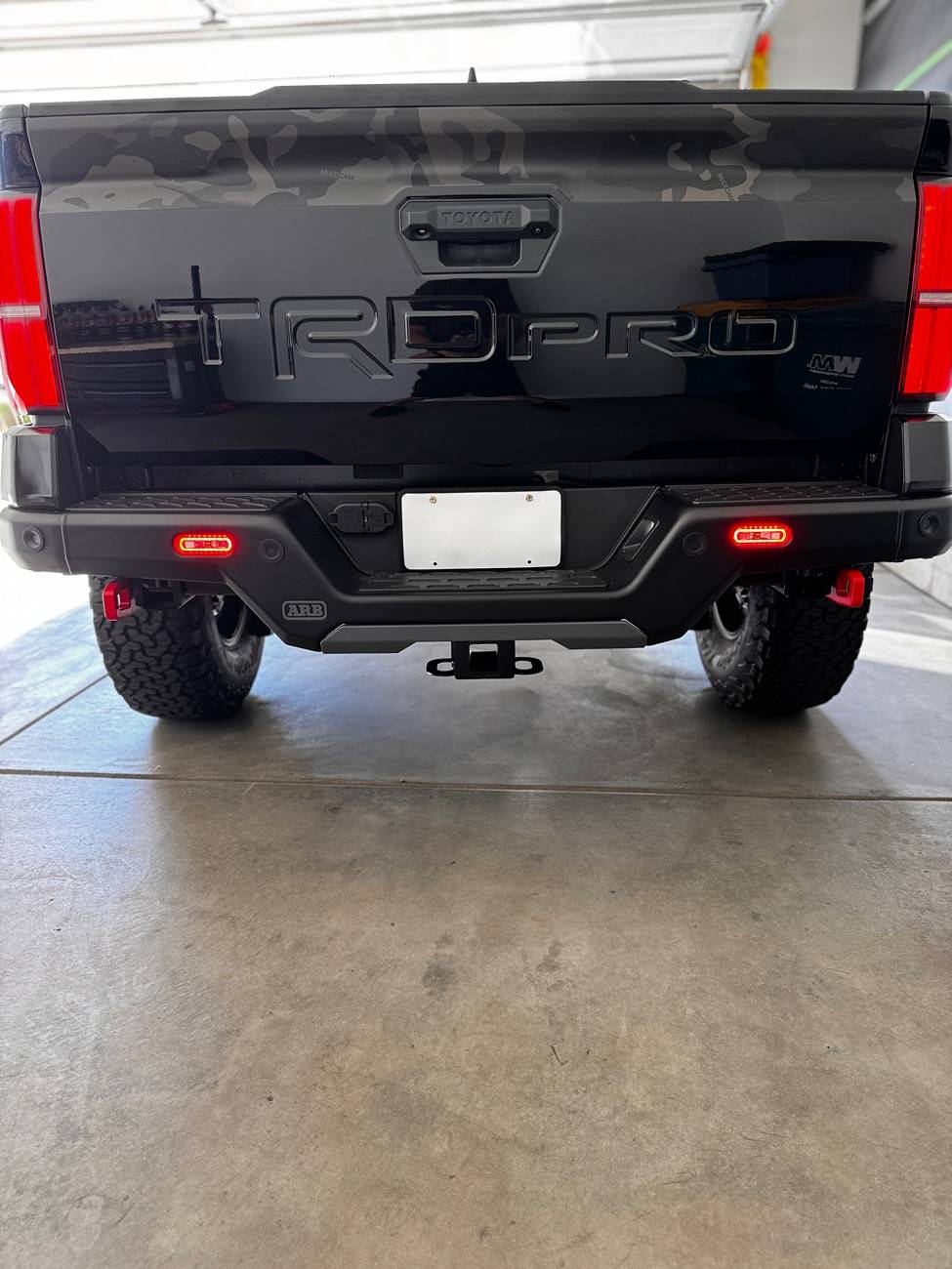

If you have even minimal wiring skills you can just modify a diode dynamics harness and add a dT connector to the rigid lights and then you save the aux switch for other lights.. I installed them this morning super easy even with adding the DT connector.
2024 Tacoma New Rigid Lights for ARB Steel Rear Bumper IMG_8833
2024 Tacoma New Rigid Lights for ARB Steel Rear Bumper IMG_8835
