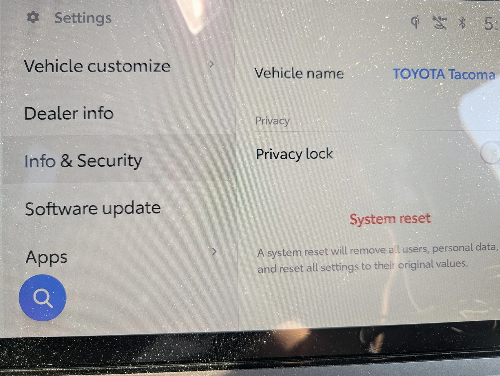

Which "reset" (explicitly by menu location) did you use? There are two, if not three of them buried in the infotainment. And each one does various levels of resetting, but mine doing a total "wipe".
Here's what I just re-tried:
Engine running
Parking brake set
Info & security | System reset
Gauges didn't change, but lost mpg and clock changed to Hawaii time and app notified me I was now removed from the vehicle

It's working now! Thank you for all the support and information, @stuckinsocal! I think the key was the infotainment reset. Here's the order that worked for me:
1. Removed primary profile in infotainment system and in the app
2. Set up connected services in app
3. Reconnected to the infotainment system (tire pressure display did not work at this point)
4. Reset the infotainment system
5. Set the screens like I wanted them, including the tire pressure screen on the second page right hand display
Reconnected my phone with Bluetooth
6. Selected the primary user again and activated it with my 6 digit pin
7. Turned off the truck for a few hours
8. Turned the truck back on and it stuck!
Note that I did this all while the truck was in park and running fully.
Also I have noticed that, if I shift out of park before the infotainment system connects, the tire pressure monitor screen goes away. Maybe that's part of the issue. Anyone else seen that?

I think the difference between you and me is the reset I used wiped my gauge cluster settings and infotainment settings. IIRC it is the same one you mentioned but it for sure changed my gauge layout back to default (I had it on casual or w/e and it changed it back to the default "tough" style - I also had it on single gauge and it went back to double). I think having the gauge cluster reset was a part of the fix potentially.
After reset, I set the gauges I wanted before doing anything with my phone. No profiles, no anything. With the gauges set I added my phone, via the infotainment and bluetooth (I also plugged into the vehicle using USB not not sure if that did anything) and put in my phone pin. I didn't initiate pairing from the app itself, but the infotainment. When I did it that way it did NOT reset my gauges after pairing my phone / profile.
I hope this helps, and good luck.

This is the setting I used. It should clear everything, including the dash. @bsquaredMTB if you recall did you use this one as well?
The "remove personal info" one that doesn't reset the dash doesn't sound like the right step to me.
Yep. I remember doing this too.

  12. Configured Gauge settings first, and configured Dials settings second
    1. On MID screen 1
      1. Allowed all dials to be permitted on left side (this pertains to all screens)
      2. Configured MID 1 (navigation left, fuel economy right)
    2. On MID screen 2
      1. Allowed all dials to be permitted on right side (this pertains to all screens)
      2. Configured MID 2 (trip A left, current drive right)
    3. On MID screen 3
      1. Configured MID 3 (trip B left, TPMS right)
  13. Connect Bluetooth, confirm pair, allow Android Auto
  14. On Infotainment, tap to Profile
    1. Noticed a "SAVE" text next to profile name
    2. Tapped it / profile name
    3. Prompted to confirm save (have never seen this before)
    4. Selected "Continue"
    5. Screen flips to "Get Started - Link Vehicle" prompts
      1. Have to perform entire VIN/QR link again, activate, decline additional
      2. Receive "All Set" / completed prompt
    6. Prompted to set up Bluetooth, selected "Yes"
  15. Powered truck off
  16. Powered truck back on
    1. All MID displays are back at defaults
    2. Configured everything again per Step 12 above
  17. Within Settings | Personal Info
    1. No devices linked
    2. No key linked
    3. (YET, I get the "welcome... profile loading" message on start up)
  18. Powered truck off
  19. Powered truck back on ~10 min later
  20. Did not auto-find my profile this time (full cold shutdown), displayed "Guest" as active profile
  21. Tapped my saved profile name, prompted me for my PIN
  22. Entered PIN and received "welcome... profile loading"
  23. Powered truck off
  24. Powered truck back on < 10 min later
  25. "Profile loading"
  26. Powered truck off, waited overnight
  27. Powered truck on, "Guest" loaded
  28. Tapped my profile, entered PIN
    1. dials remained rolled over to Trip B, not TPMS
  29. Activated device linked to profile and key linked to profile
  30. Powered truck off, waited overnight
  31. Powered truck on, my profile loaded
  32. Dial remained rolled over to Trip B
    1. Few more drives in and still, even if I want in park (with or without parking brake set) for multiple minutes, never loads dial back to TPMS
