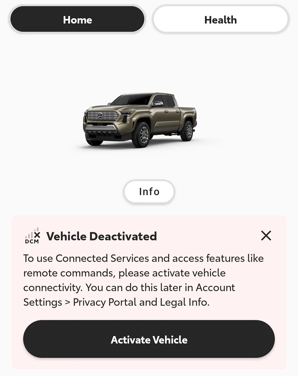

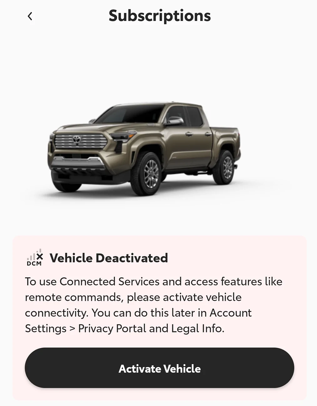

What do you lose or have to reconfigure on the infotainment reset?
I'm personally extremely hesitant to "undo" the connected services full opt out. Here's what I get within the Toyota app.

I lost my subscription to music lover and had to re subscrib when I disconnected my car. I think I lost the remaining partial month from my previous subscription.
