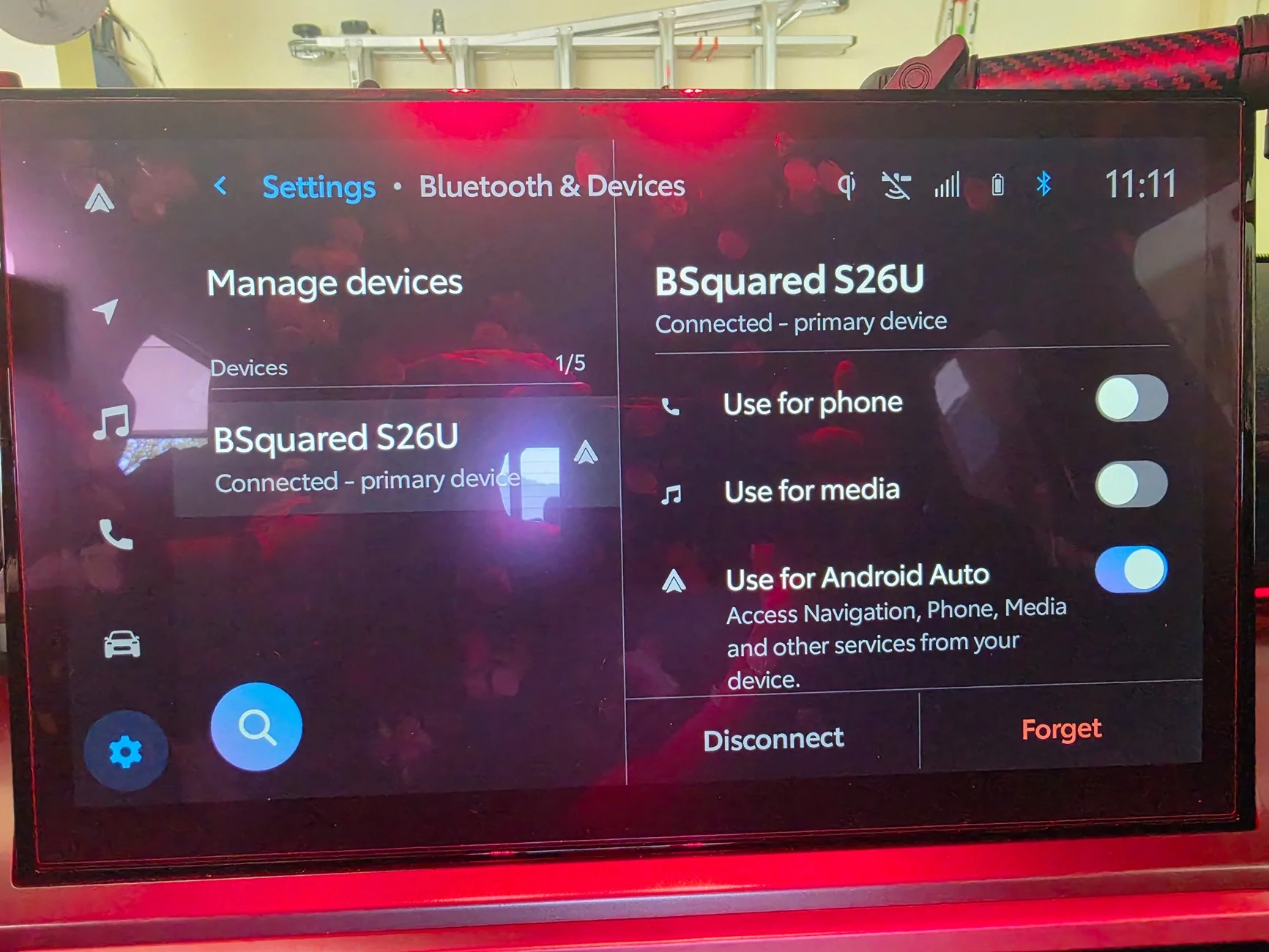

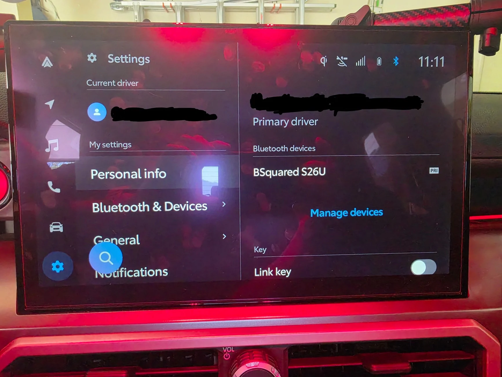

Something you might want to check @Baltimore. Is your phone the primarily linked device to your truck? I posted some photos from mine. Basically you want to go into the personal info setting and click Manage Devices. Make sure your device is the primary device linked to your profile.
Baltimore
Jul 23, 2024
690
393
Maryland
4g hybrid
yes. both the phone is "linked" to the profile as well as my primary key is "linked".

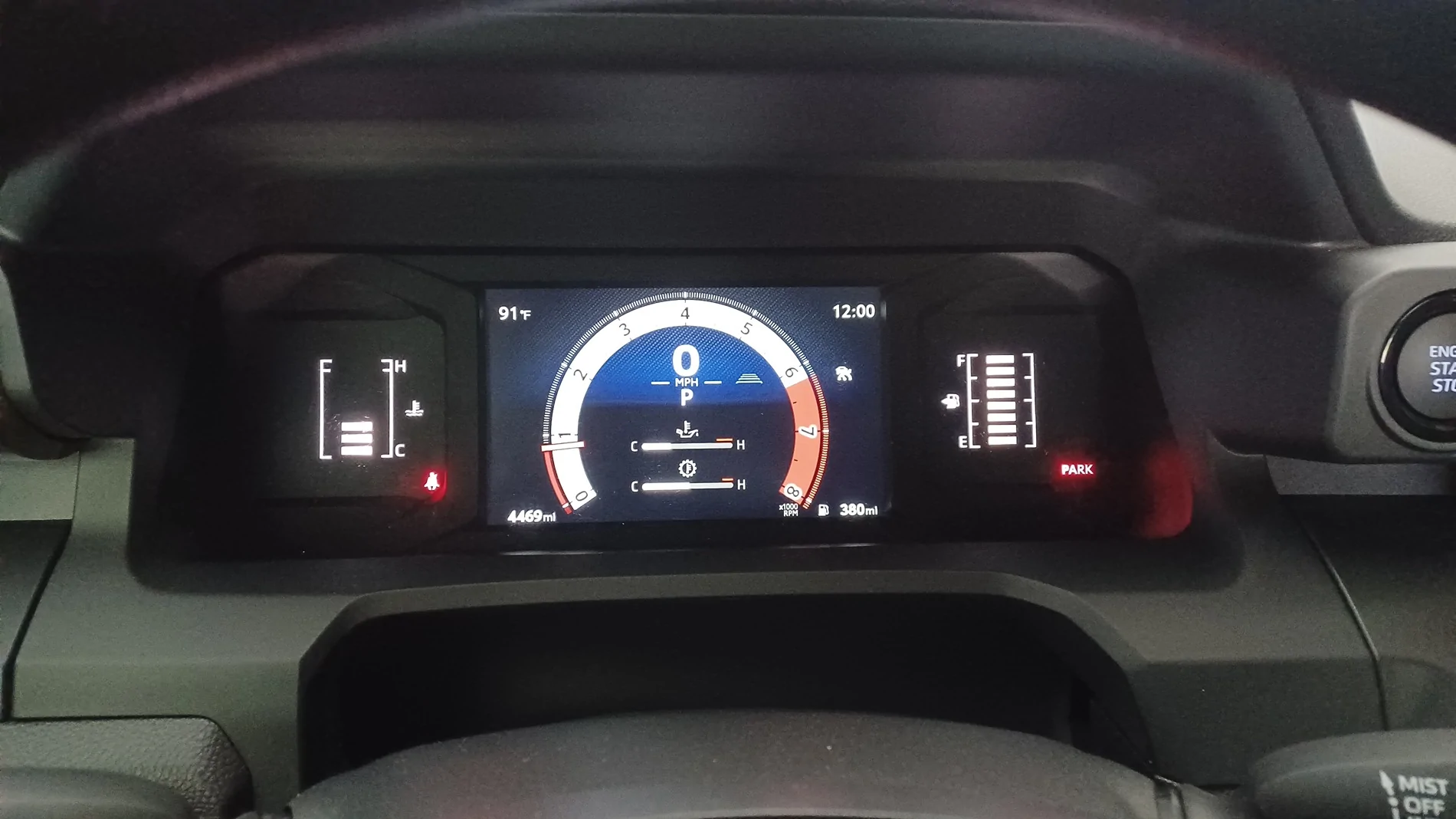

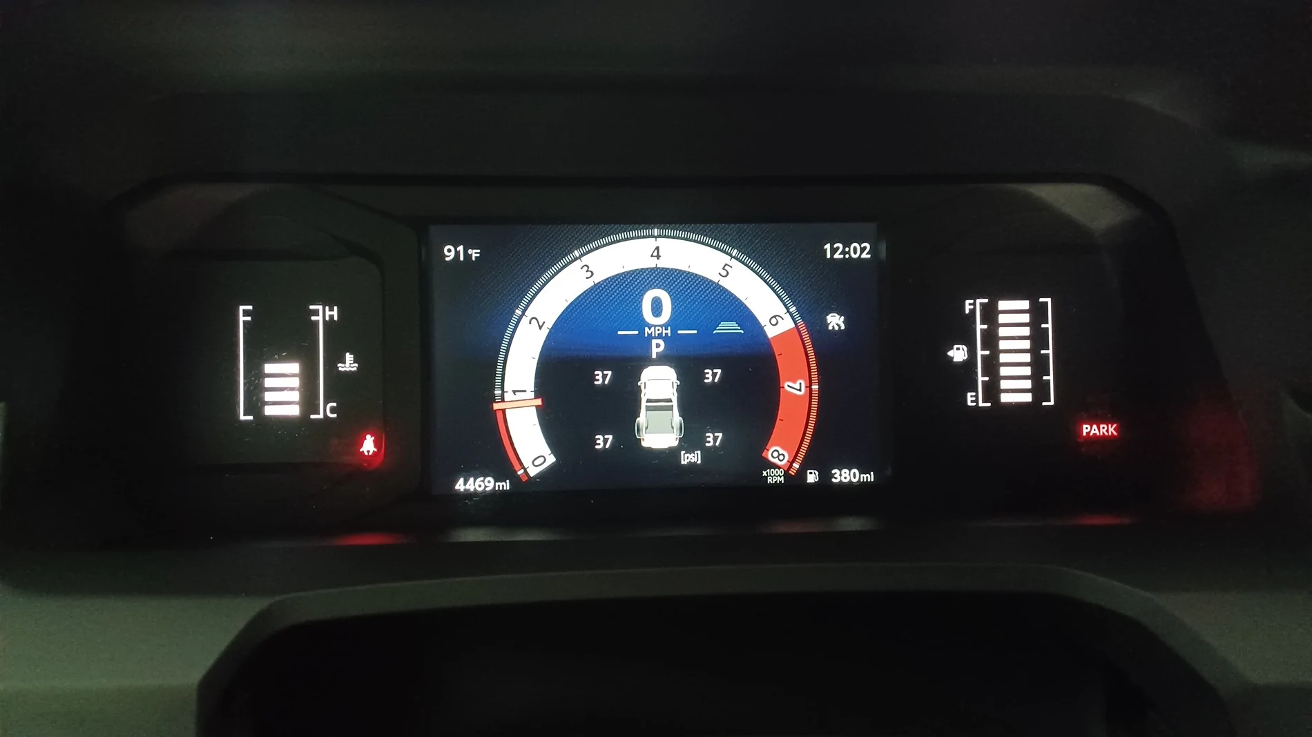

Are you guys saying that the tire pressure screen defaults to something else (trip B) when you start your truck?
Because mine does not do this. If I have it on the pressure readout, it stays that way the next time I start up. There will be just lines for the first minute or so until it reads the sensors. But it will stay there indefinitely until I change it to something

IDontWorkForTheWaterCo
Jul 11, 2026
409
505
USA
2026 Tacoma SR
Correct, it always defaults back to trip b (previous menu item in the menu).
Yeah, mine does not do that. If I put it on that screen, it stays on that screen indefinitely until I change it. As I mentioned, there's about a 1 minute delay before the truck reads the sensors, so it just dotted lines at each corner until it reads them.
My rig is an SR with the simpler instrument panel and a build date of 4/26. Not sure if either of those bits of info make a difference.
Jul 11, 2026
409
505
USA
2026 Tacoma SR
Could be a difference in not having the 12.3" full digital tach. Now that you mention that, wonder if it's related or coincidence that those also have a recall on them too.
Not sure. My wife has '25 Corolla Hatchback SE that has the combination analog and digital panel that doesn't appear to be part of the full digital instrument panel recall that effects the XSE and GR models.
My instrument panel has one digital dial gauge that I can use as a speedometer or tachometer. I typically keep it on the tach and use the digital speedometer in the middle.
This option is alway up if I want it though, no fiddling with it at each key start.
