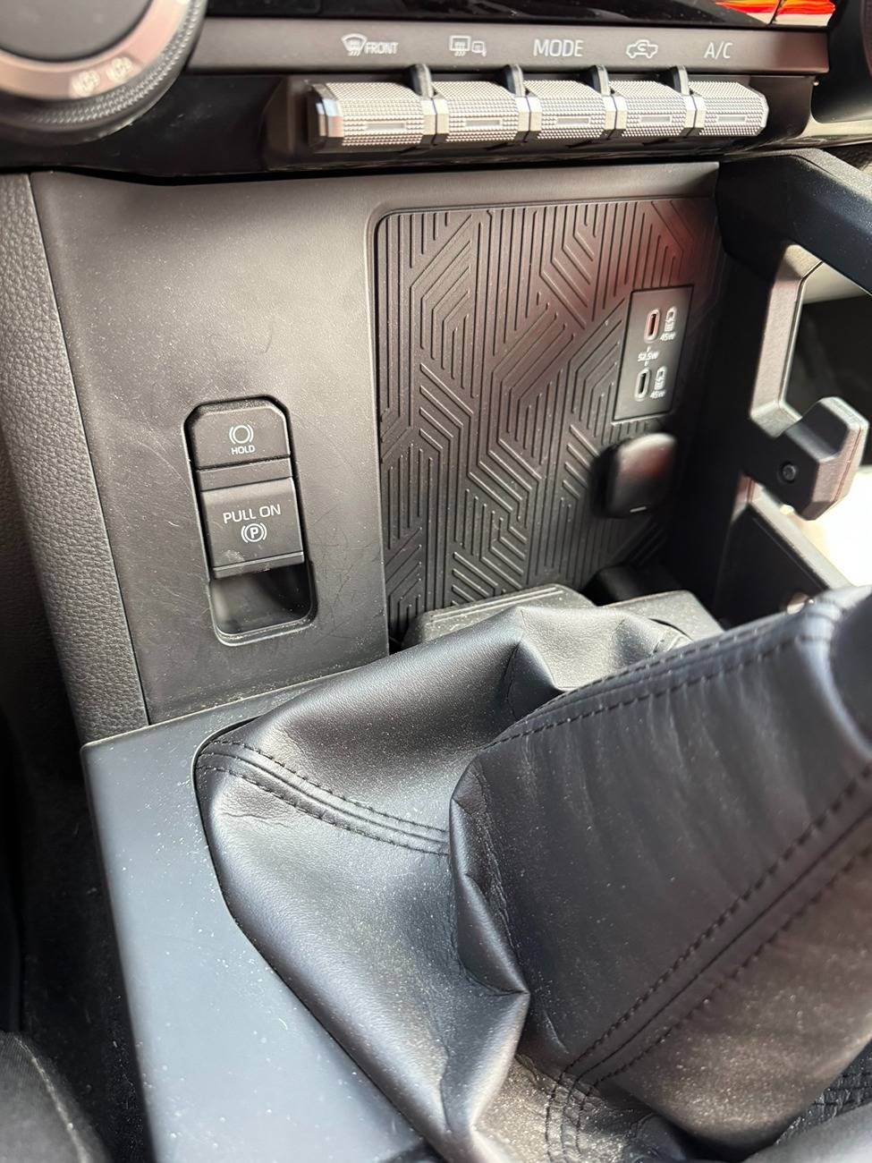

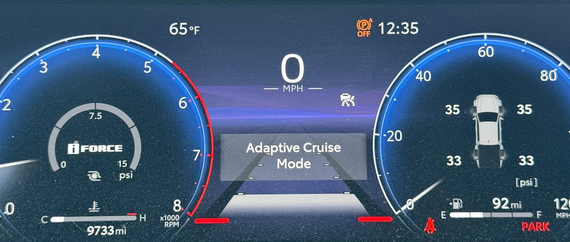

Definitely odd, and like I said, I don't know if that's just how it is on my truck or if it's the same with everyone else's. I have my parking brake set to manual because I have a standard transmission, and I'm used to setting the parking brake (this is my first electronic brake) whenever I park. Here's my default cluster gauge, and you can see the "EPB function off" icon next to my clock:
You could maybe try this too and see if it has any effect, but for me, it behaves the same regardless if the auto EPB is on or off. Just in case anyone here doesn't already know, if you want to change this setting, just push in the brake button next to your shifter and hold it for about five seconds. You'll see a message pop up in your gauge cluster telling you the Auto EPB Function has been switched OFF. To turn it back on, just do the opposite and pull the brake button for five seconds, and it will turn the function back on.
I've heard that some people have had issues of this function also resetting whenever the truck is turned off, similar to the TPMS gauge issue (but worse in my opinion since this actually affects the behavior of how the parking brake works). With it set "off", I like that I can easily take off the EPB without having to turn on the truck, and lets me move the truck with the door open. Good to know if I ever need to get my truck a rolling jump start for whatever reason. I also don't like having to start up my truck just to move it a few feet while I'm working in my small ass driveway, so this let's me avoid that as well. I dunno, it just always felt strange to have the truck automatically engage/disengage something that I've been so used to doing in every other car/truck I've ever owned with either the classic hand lever or the foot pedal.
