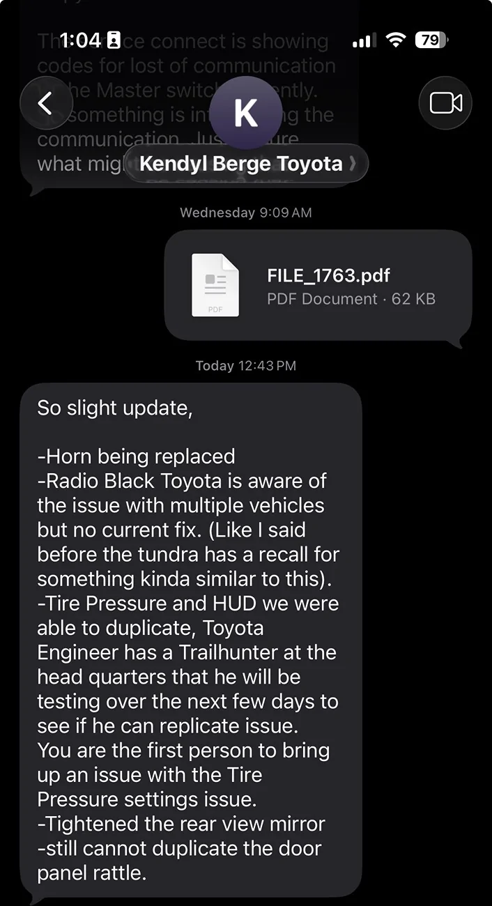

Guys, this is sad. “You are the first person to bring up an issue with the Tire Pressure settings issue.”
Glad to hear all those case submissions go into a black hole and Toyota isn’t tracking them as reported issues….
Maybe dealer level vs corporate level? That being said not a lot of hope. Also.... does this not affect everyone? I wonder what the difference is; maybe that Toyota app? salesman tried to get me to set it up but I canceled / denied a lot of permissions (I don't need an app for everything....)
I stopped using the app after the first free year membership expired. So doesn’t have anything to do with remote start either. It’s certainly a software/electrical bug. The blanket ‘radio screen going blank’ is also just hilarious to me. It’s a $65k truck guys like come on.
