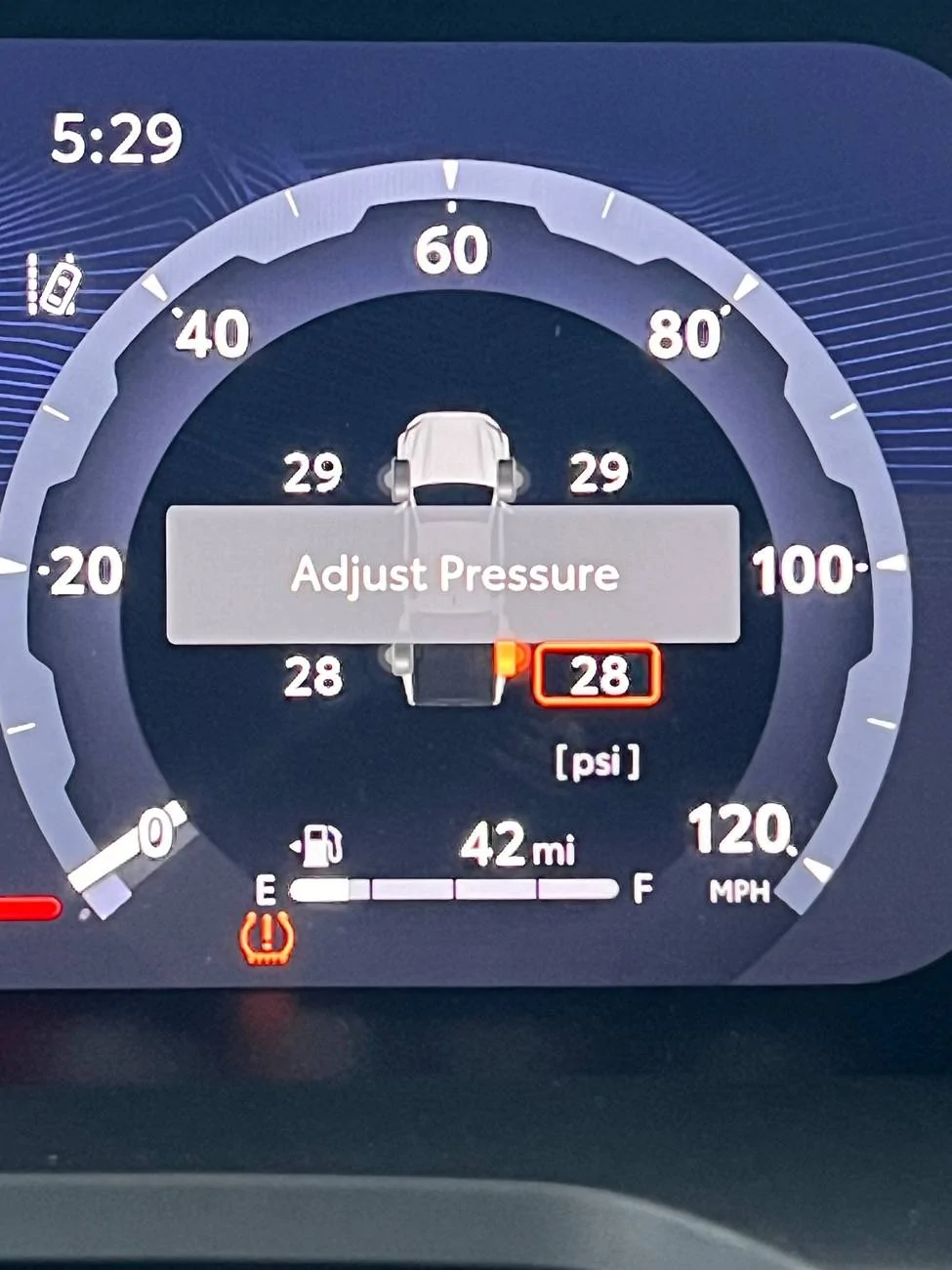

Exactly. Here’s another one. If y’all air down at all or if you start your truck on a super cold day - one of the tires might freak out on the tire pressure screen and no matter how high the pressure goes afterwards it keeps telling you to adjust the pressure. It’s super cold in Houston this week and this happened - but it picks 1 tire at random and persists - I realize 28 is low but in a couple days it’ll be back to normal and it’s also not so low that it should trigger the warning (when it first triggered it was 26) also when it warms up it’ll still have the warning - I’m sure I can reset it but why does it do this? I think the last time it did this I had to inflate it with more air to get it to stop freaking out (allowing the temp to rise and naturally increase pressure doesn’t work)

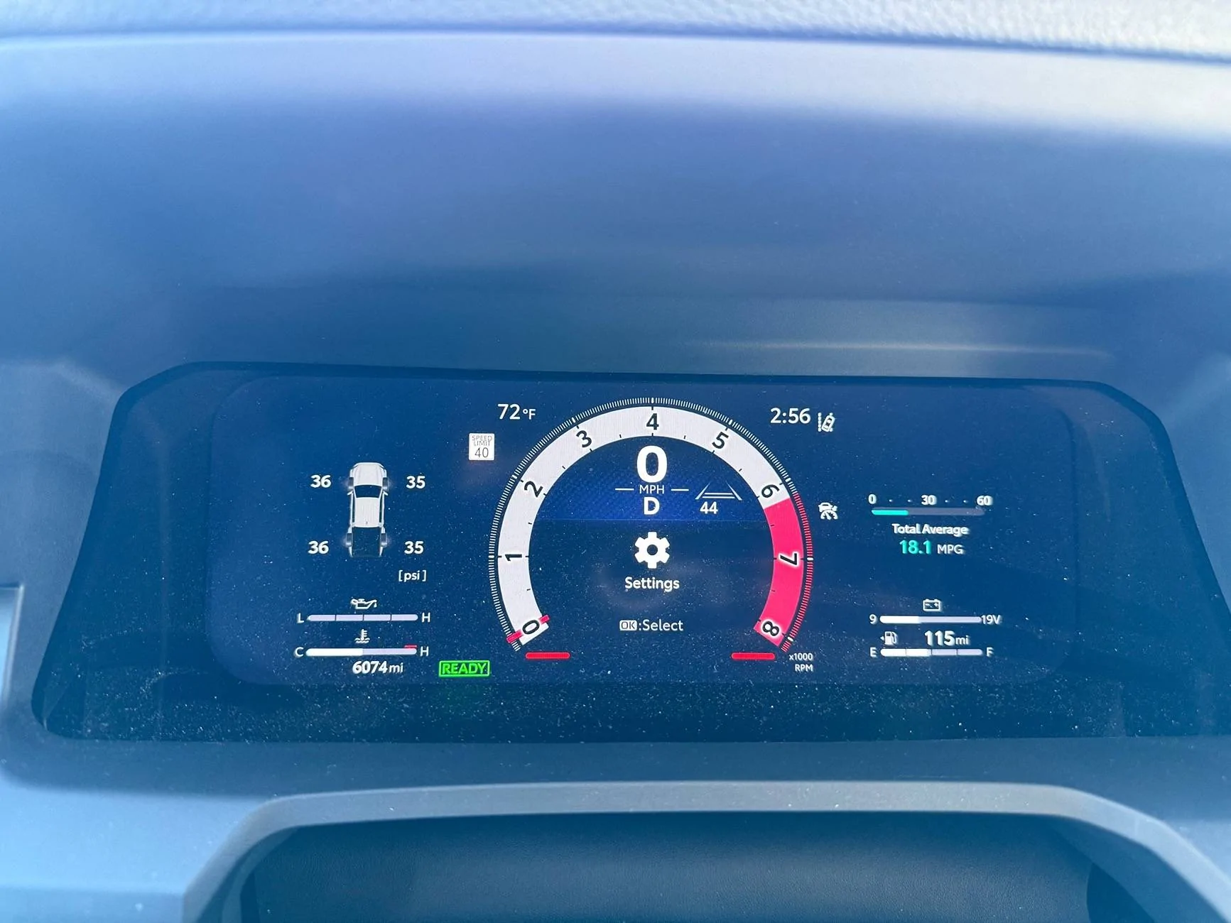

This is how I have mine set up. Sorry, tire pressure was set on the left not right. You can adjust what you want to show on the left middle and right. Absolutely we can meet up, it would be cool to see a fellow trail hunter owner in the Houston area. I have not seen many.
Here is a YouTube video that’s is pretty informative about customizing your instrument cluster.
