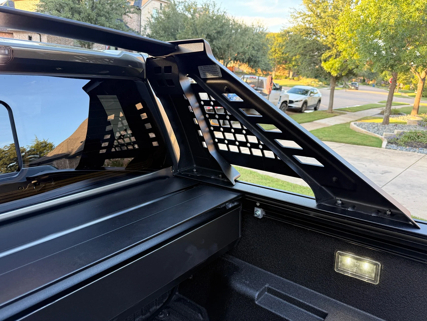

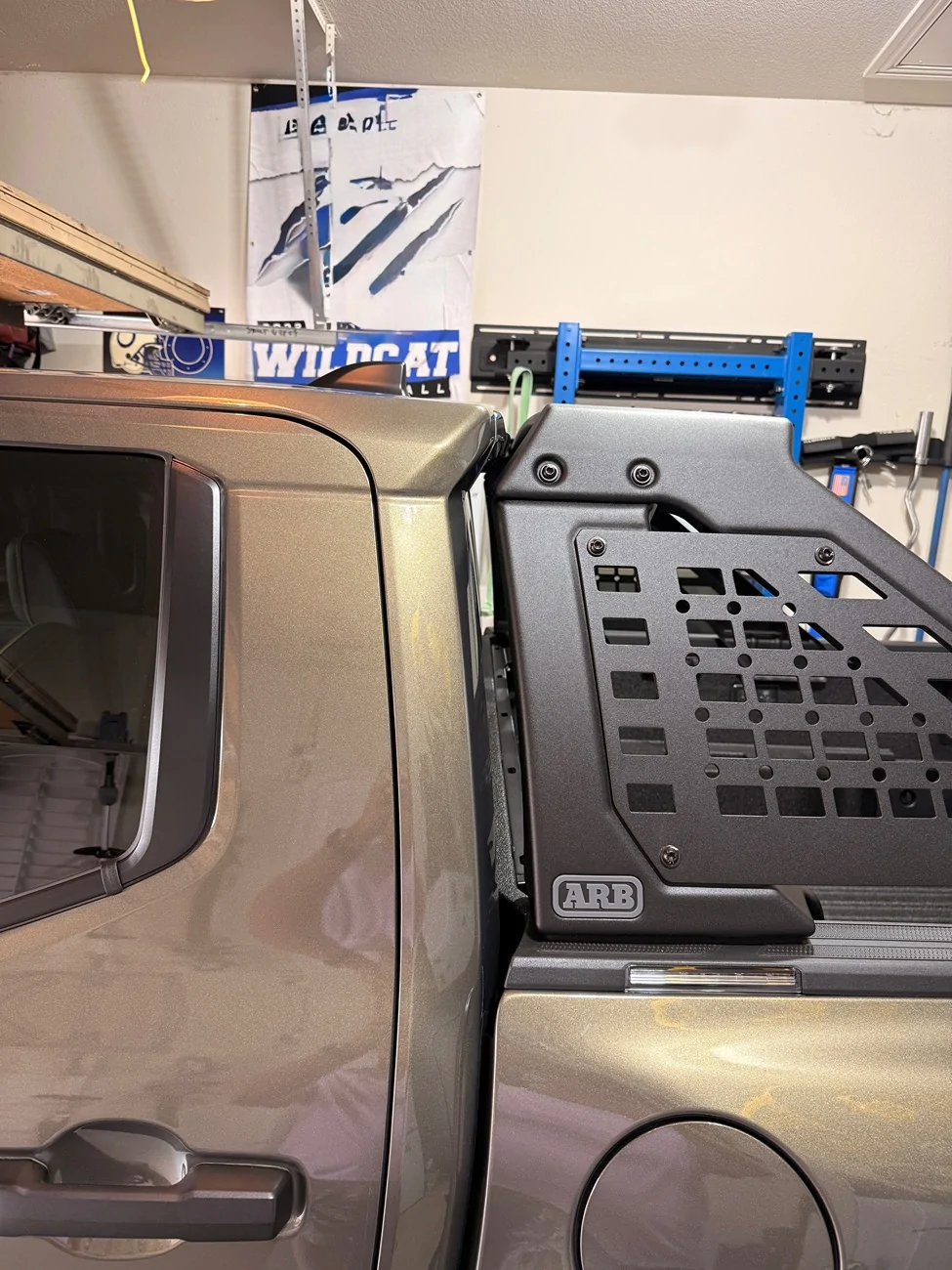

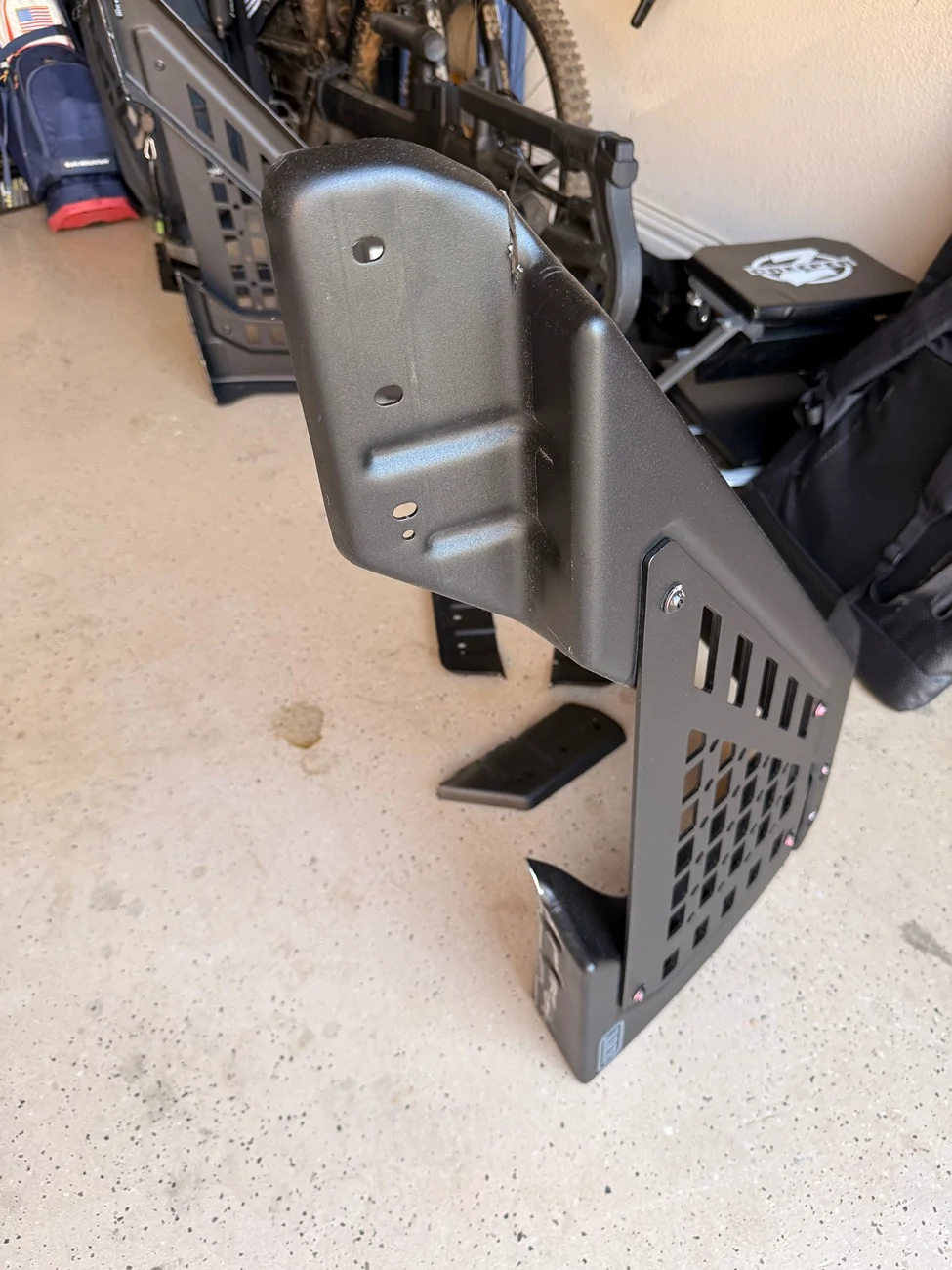

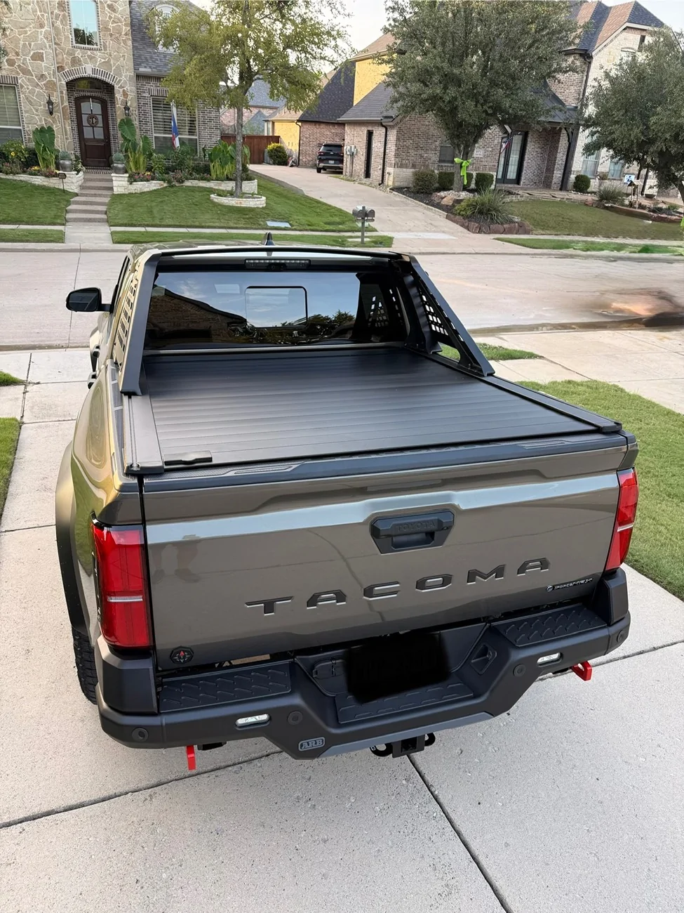

If you don’t like the ARB sport bar, you can move on to the next thread. I happen to like it but I wanted a tonneau cover too. I had 2 ideas to make both possible. The first idea was to make a plate that sits under the lip of the cover and allows you to bolt the bars on after cutting them up a bit. The second idea was more expensive and raised the bars up 3/4” higher, but it was easier, so here’s how I did it:
Remove the bars and cut all 4 mounting tabs off, flush with the base plate. Grind it smooth and hit it with flat black (or dark gunmetal) paint.
Install your favorite tonneau that has T-Slots. I went with the RetraxPro XR. The bonus with this setup is there is plenty of room to add track accessories later. Mark the T-Slot lines on the bottom of the bars and drill 2 holes in each section. I bought M8x25 T-slot anchors off Amazon and they worked perfectly. I would not go any longer, but you could go down in length to 18mm with no problems.
Toss the bars back on and you have the best of both worlds!

Great job. It looks exactly like the Youtube video that I had posted but had no idea what they had to do to accomplish it. How smooth (level) was it after the cutting?

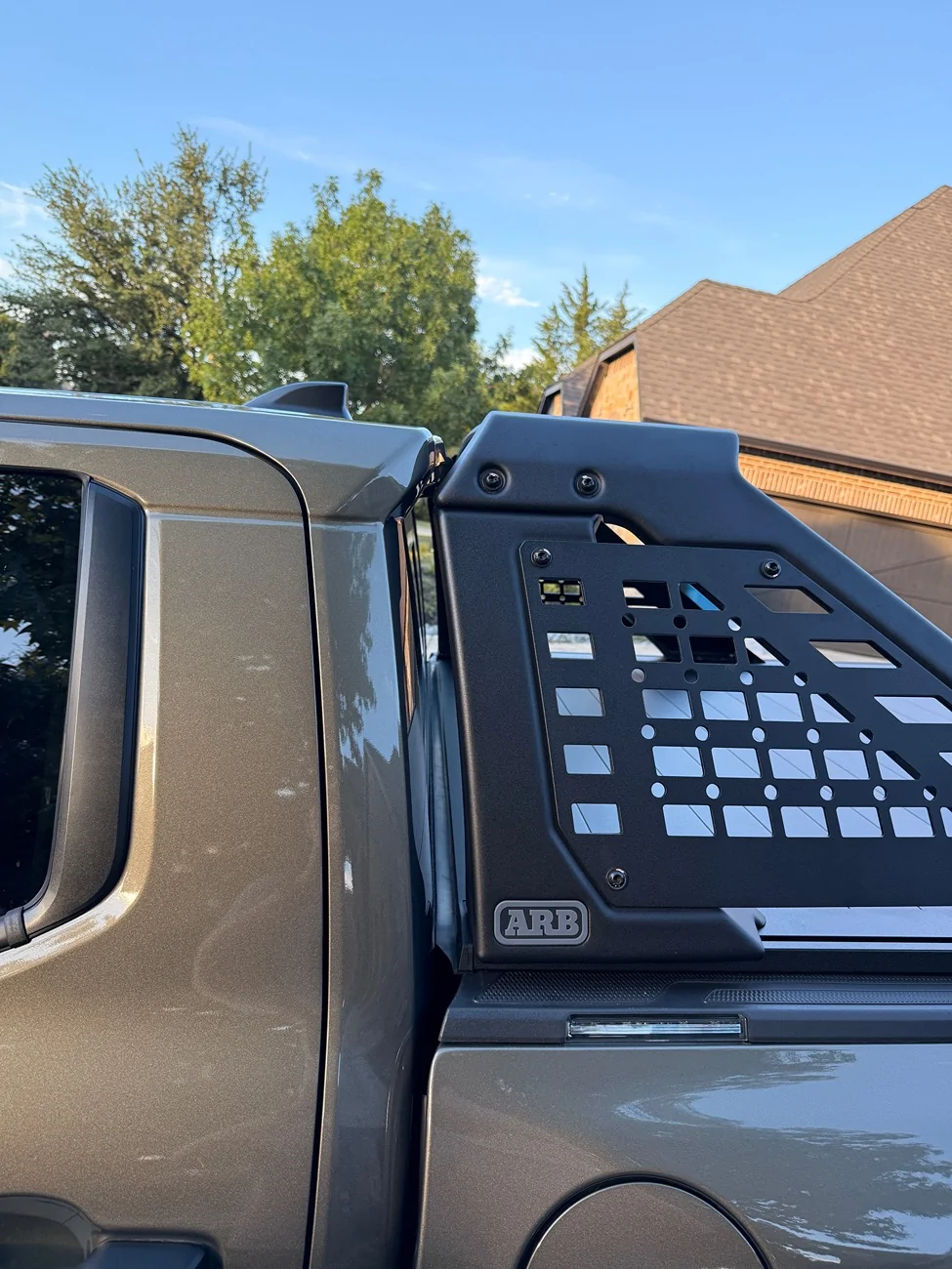

Perfectly level. I took my time grinding it flat and sanding it smooth. The last 2 photos show the after and before (I kinda sucked at the post) that show how much higher it is after the install.

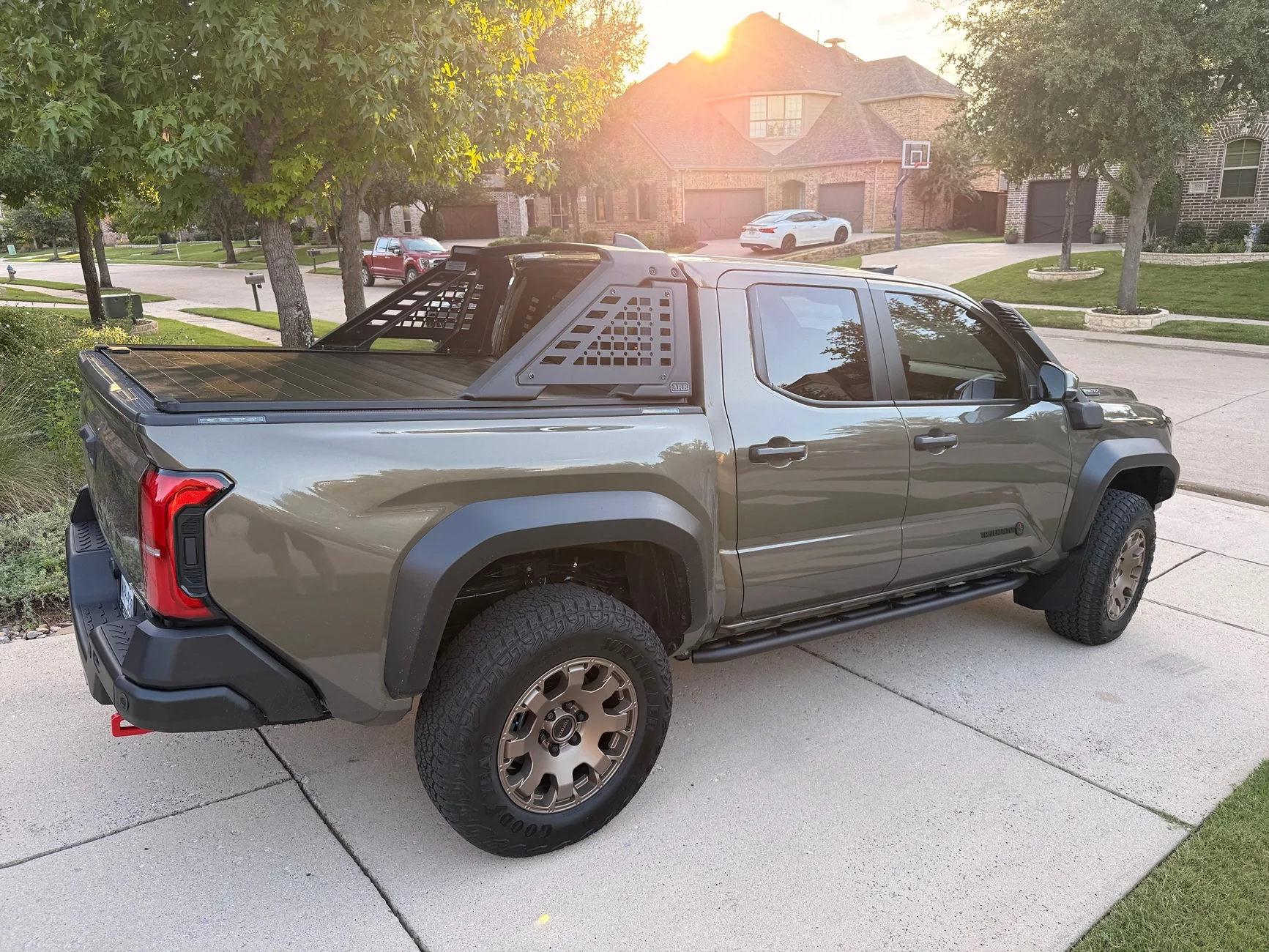

Measure and measure ten measure again before cutting. Looks factory. Is it me or does it look more narrow (just a tad) from the back looking towards the front of taco?

I squeezed the bars closest to the cab in about 1/8 - 3/16” on each side just to minimize to amount of overhang out from the tonneau track. But I don’t really think that made much of a difference. Unfortunately I didn’t take any before photos from that angle to compare.

I think it might be because they are not mounted to their normal mounting points that give it a different look.

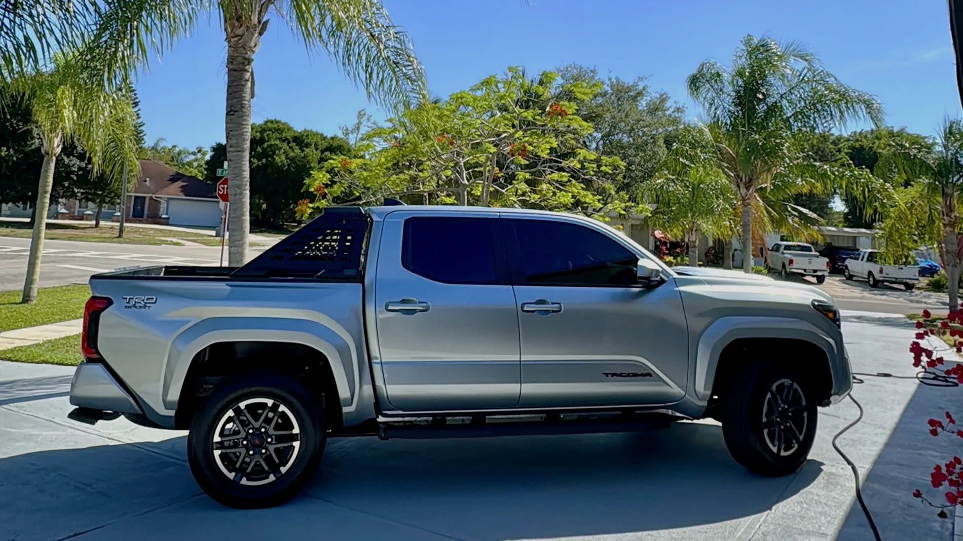

Thanks for the post, I added the Sport Bar to my Taco cause I like the look, then after getting it as I was installing it I thought "how can I get a tonneau cover on it now" LOL I was thinking of doing the same thing you just did but I like the flush roof/Sport Bar look. :headbang:
I was worried about the same thing. My first choice was a BAK roll top cover. Mount it sitting on top of a plate that connected to the rail system and had bolts going up for the bars, instead of the T-slots. That was just too much fabrication and I couldn’t find anything on the market that I was sure could work. RC makes a set of plates but I couldn’t be sure they would work with the cover.
In the end, I don’t really notice the extra height in the bars. It might actually be a bonus if I ever wanted to mount lights on the bar.

Hey,
Yeah, I see that being an advantage when adding lights.
