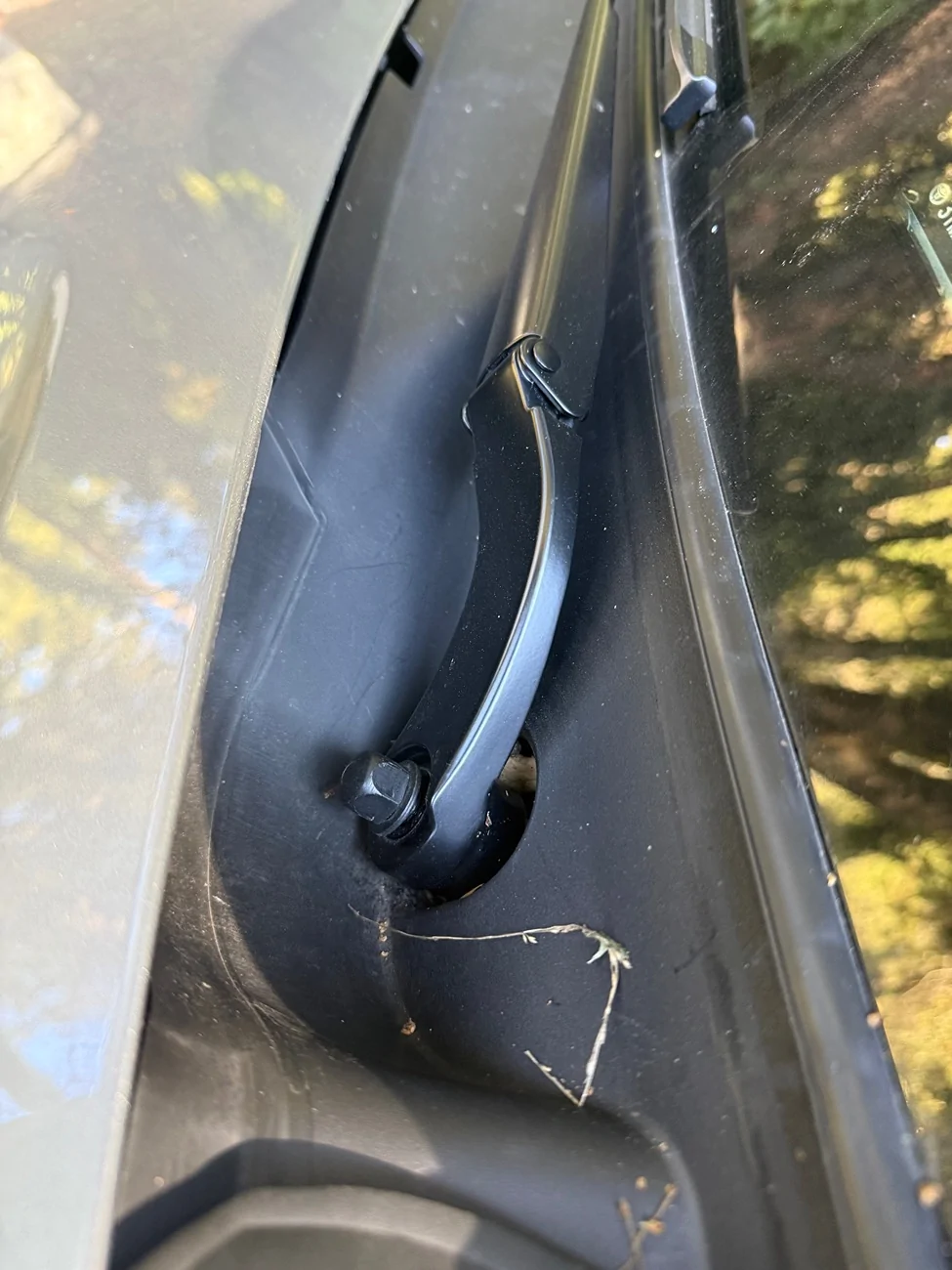

  1. Remove the wipers, 14mm nut on both. They weren't that tight but the wipers are clocked on a tapered, splined shaft. I used a little wiggle and a few taps from a plastic head hammer to get them to pop off.

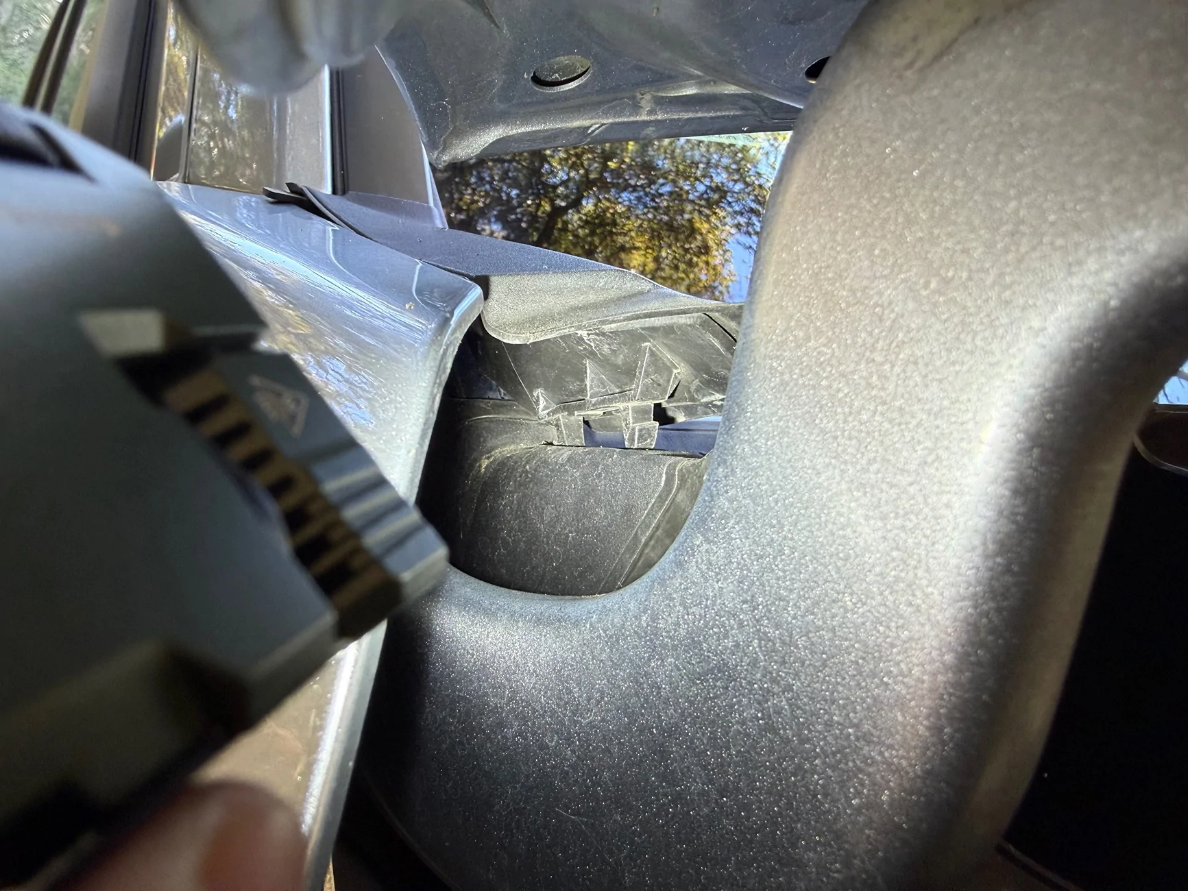

  2. The cowl cover has two plastic rivets on each end that you can use a flat head to pop up the center and then remove. The plastic corners of the windshield also clip into the cowl cover and simply pull up and out with a wiggle.
    2024 Tacoma Rodent Screen Installation DIY IMG_8872 2
    2024 Tacoma Rodent Screen Installation DIY IMG_8873
    (Once unclipped, I left these loosely in place)
  3. The cowl cover itself pulls out straight towards the front of the truck. In order to make this happen, there are clips on the engine bay side that need to be pulled up & disengaged vertically before it'll come forward. Unfortunately, I did not take picture of this since I was wiggling and pulling on it, however it is fairly robust. Start at each end and wiggle it loose. Once you have each end disengaged, and the center clips pulled up vertically; pull the whole thing forward (towards the front of the truck) and it should come out.

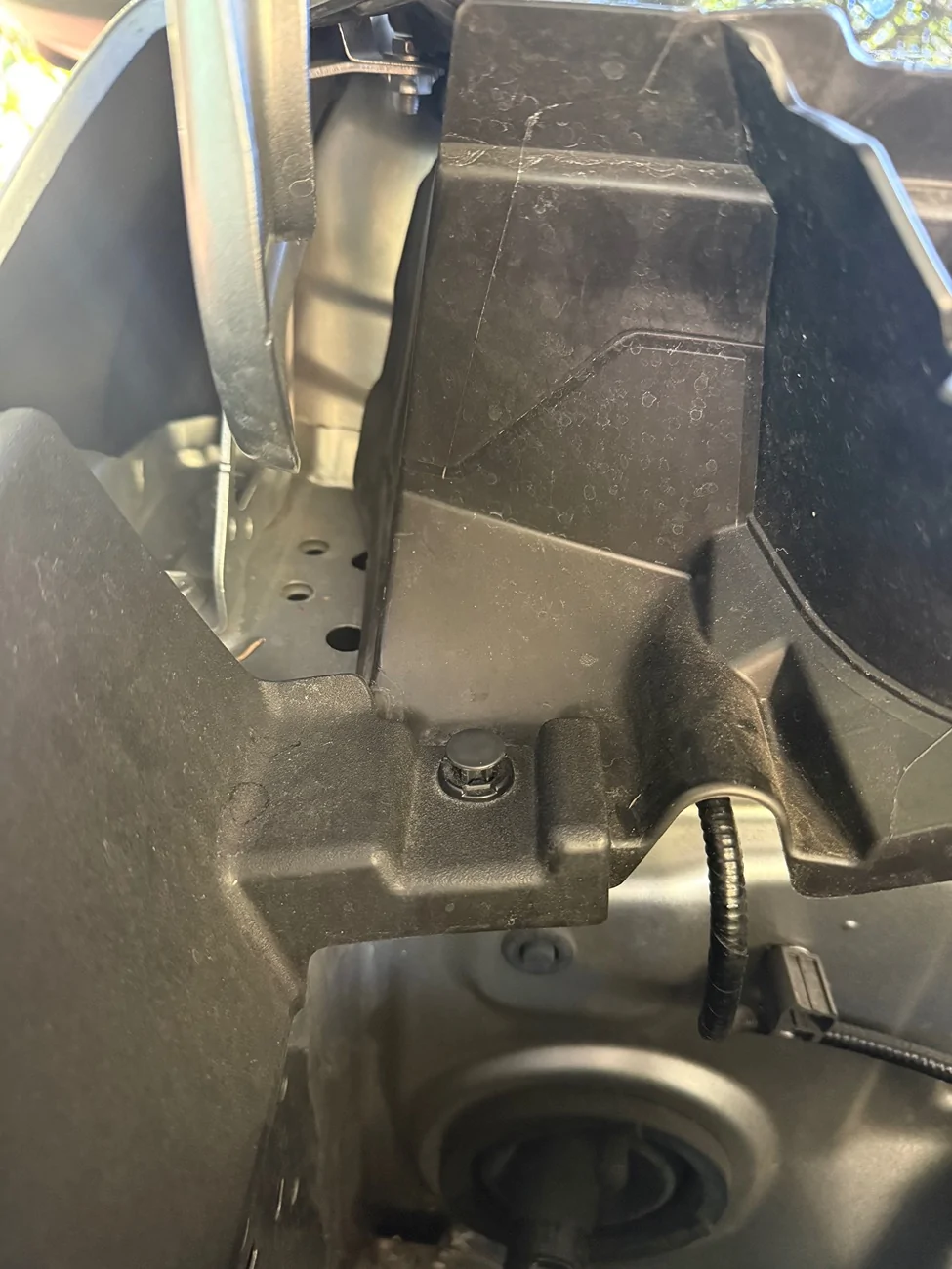

  6. Once I got it to approximate size, I put it on the HVAC intake and bent (used ball peen hammer, my hands, etc.) the remaining edges until snug around the flange. I double zip tied everything and that's that. Note there are also two holes on the upper firewall side that you can also thread zip ties thru in order to secure the rear, once again using the angled bit of mesh (kind of) shown above.

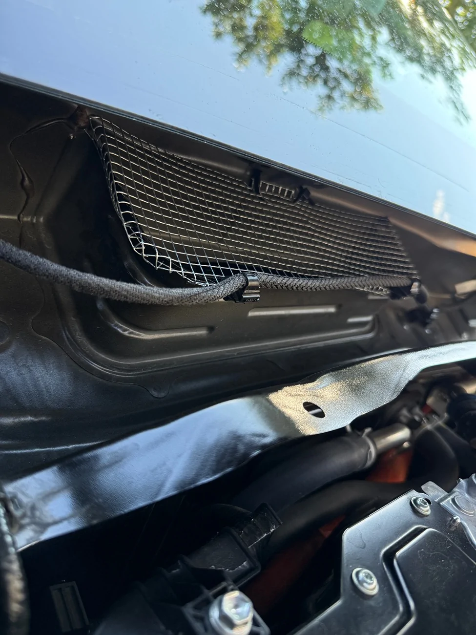

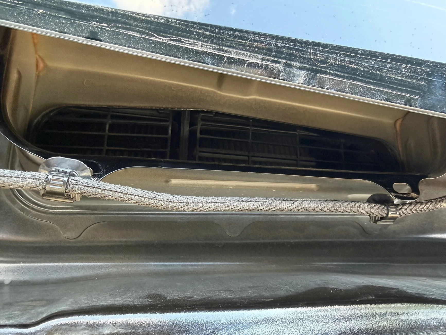

I often park my vehicles in an open, mowed field. Mice have always gotten into their cabin and engine air filters. With my Tundra I finally blocked the opening with stainless steel screening…… that has been successful so far……

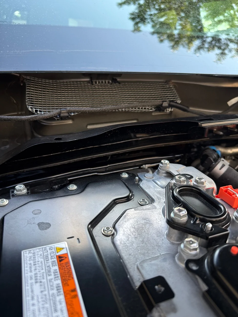

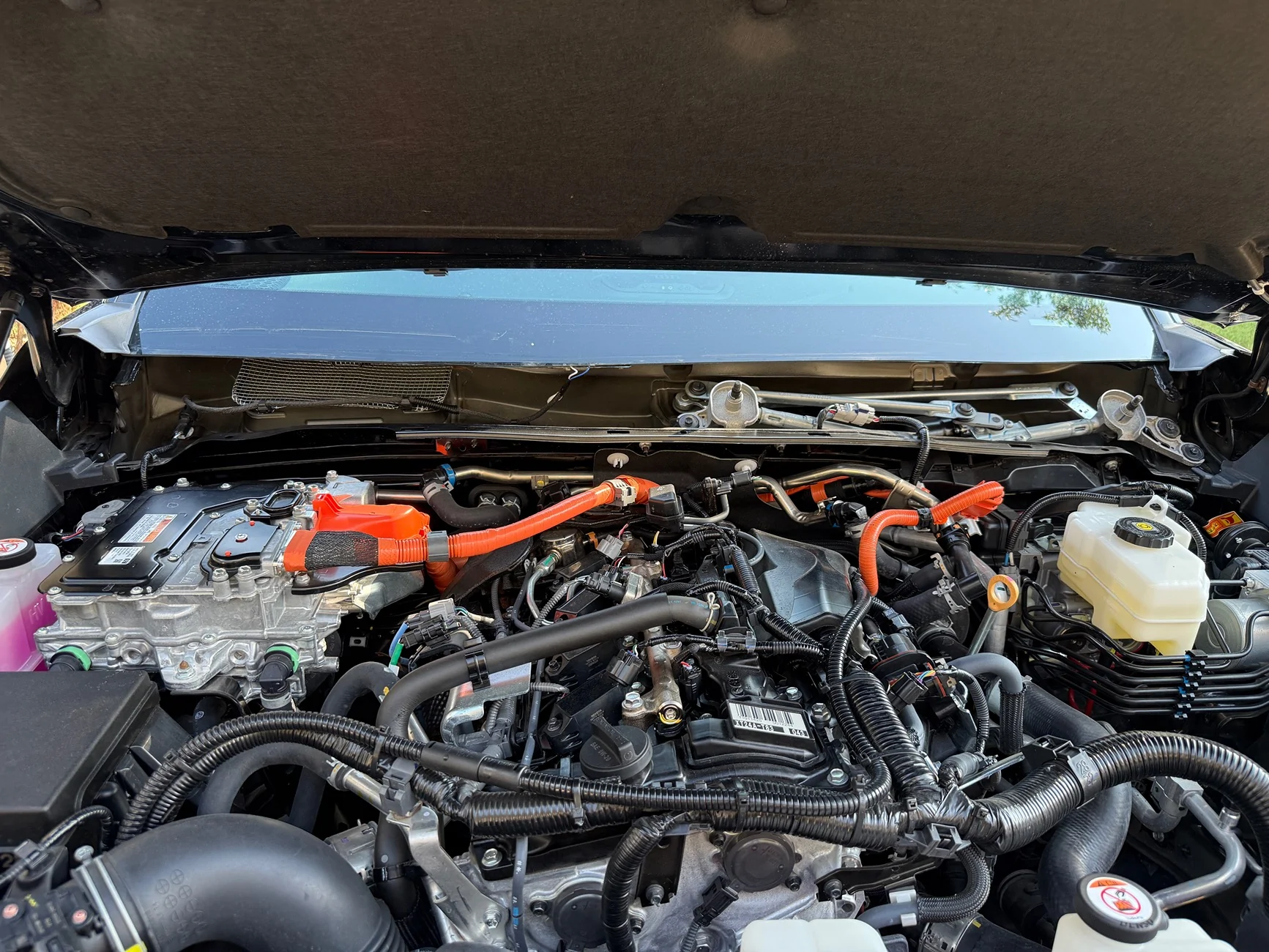

This is a must do mod. The risk is just too high not to do it. Last night my truck was parked outside at my campsite….opened the tailgate this morning and there was a mouse in the truck box (I have a tonneau cover). So that was a close enough call for me!
Disappointingly so though, this should be standard equipment from the factory. It is a truck, and gets used and parked in remote places and situations. Ford has it. What say you, Toyota?
