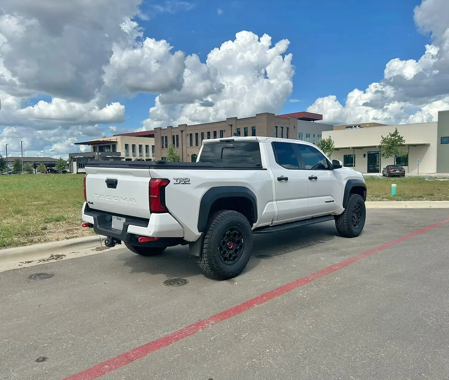

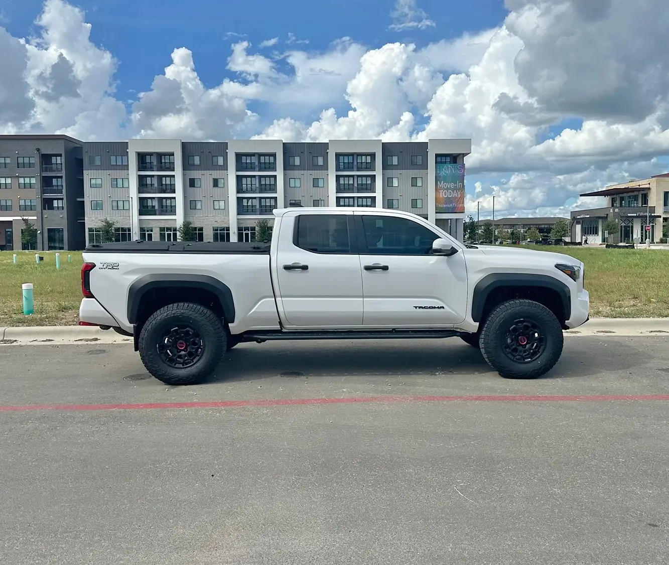

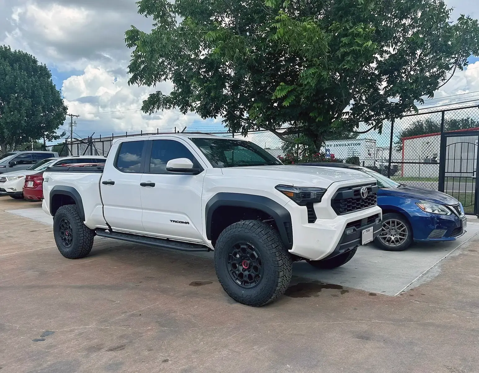

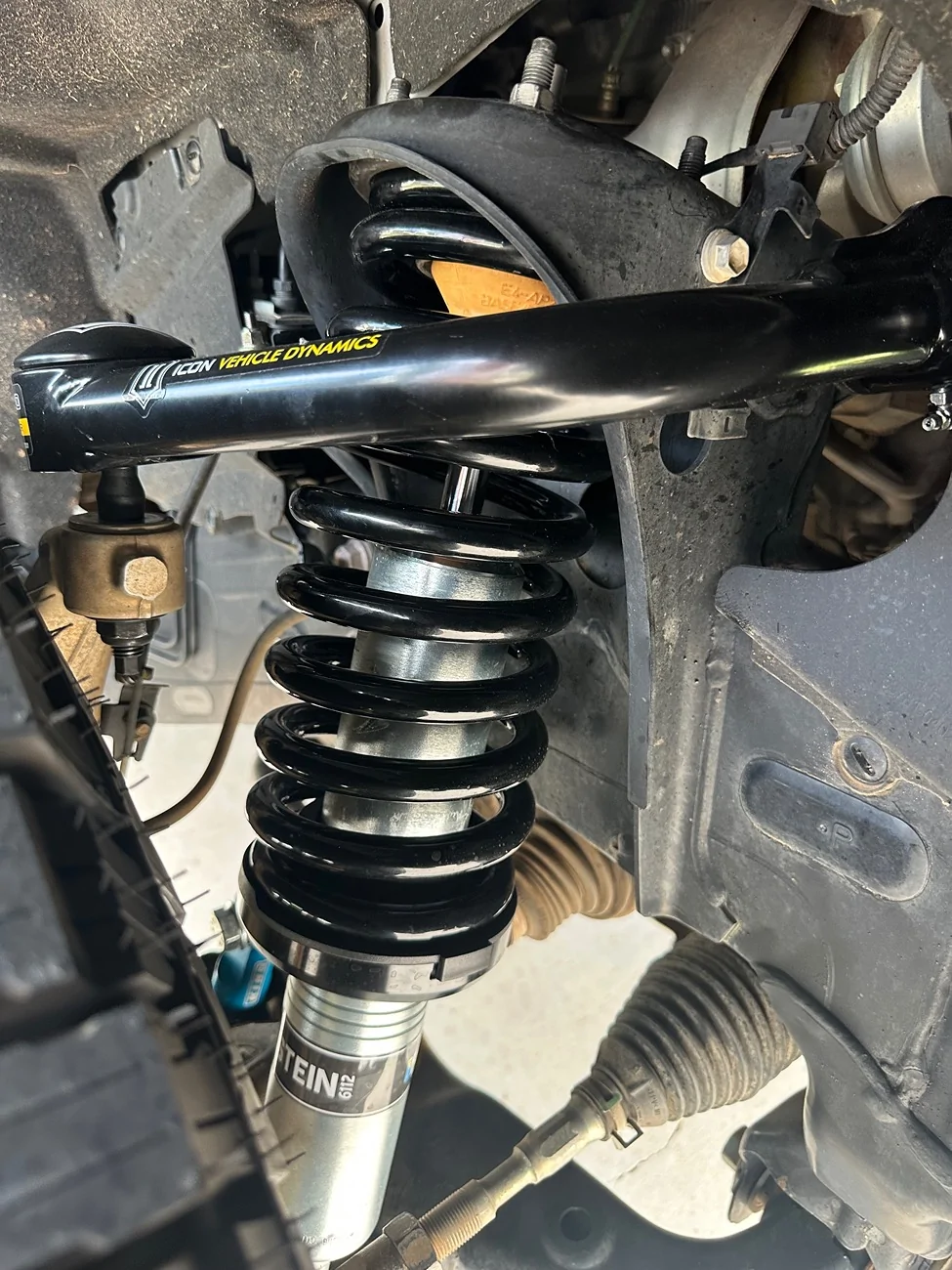

After 2 years of ownership and 30k miles finally bit the bullet and did a suspension overhaul. I was running Peak 2 piece front collar kit before all of this.
Icon UCAs
King Sway Bar Links
Dr KDSS Track Bar Correction
Perry Bump Stops
Bilstein Suspension 6112 and 6100
Dobinsons Rear Springs C59-817V
Tundra TRD Pro Wheels
Falken Wildpeak AT4W 35/11.5/18

It was about 3k shipped, not terrible considering other coil over setups alone can be much more (i.e. certain Fox systems). I held out as long as I could with stock shocks haha!

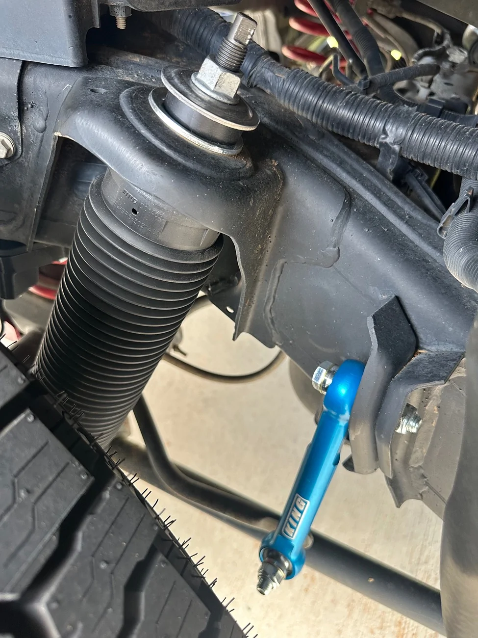

You probably know this, but if not: if those end links start squeaking get yourself some graphite lube. And if they start mad creaking the replacement bearing is a Com10.
Thank you! My mechanic mentioned something about this but I totally zoned out.

Looks great! I’m looking to upgrade to the 6112’s in the next few months. What’s your initial impressions on these vs stock. How’s the ride feel on-road/off-road? Anything come up that you’re were or weren’t expecting?

Thank you! Compared to OEM off-road way better. Nothing unexpected, beefier, less dips, more control, height is nice too. Haven't gotten the chance to take it off roading but based on how it feels so far probably an upgrade. Now I will say I think the price is exactly where it should be. I did alot of research on how the 6112's were for the previous gen Taco and Tundra. If these were any more expensive though I would definitely question it.

Do you find them to be stiff? That seems to be a common criticism of Bilsteins.
taco.b0ut.it
taco.b0ut.it
May 15, 2024
58
75
Austin, TX
2024 Off-Road Long Bed
Not really but it’s subjective. Drives well on road. Only a tad bit stiffer than the 5100s on a 2021 4runner.

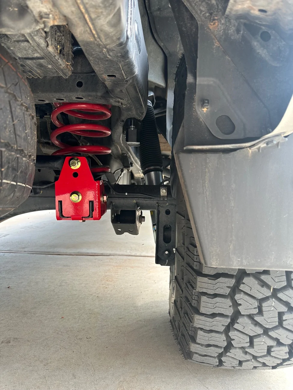

With the trackbar relocation bracket, which I'm considering, why did you go with the higher hole? From what I could see, unless you were 3"or more in the rear you only need the lower hole?
taco.b0ut.it
taco.b0ut.it
May 15, 2024
58
75
Austin, TX
Nice work man! I almost pulled the trigger on those but didn't want to wait for them to be available and wanted something to handle more weight so I ended up with the OME MT64s.
Nice! OME was a consideration as well.
I was definitely 3 inches higher in the rear. Drives well now. I actually had the rear springs installed first without anything else and the rear would hop it felt like.
