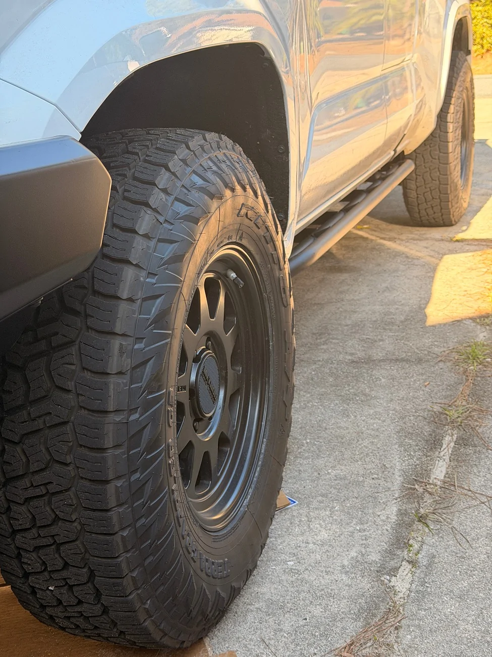

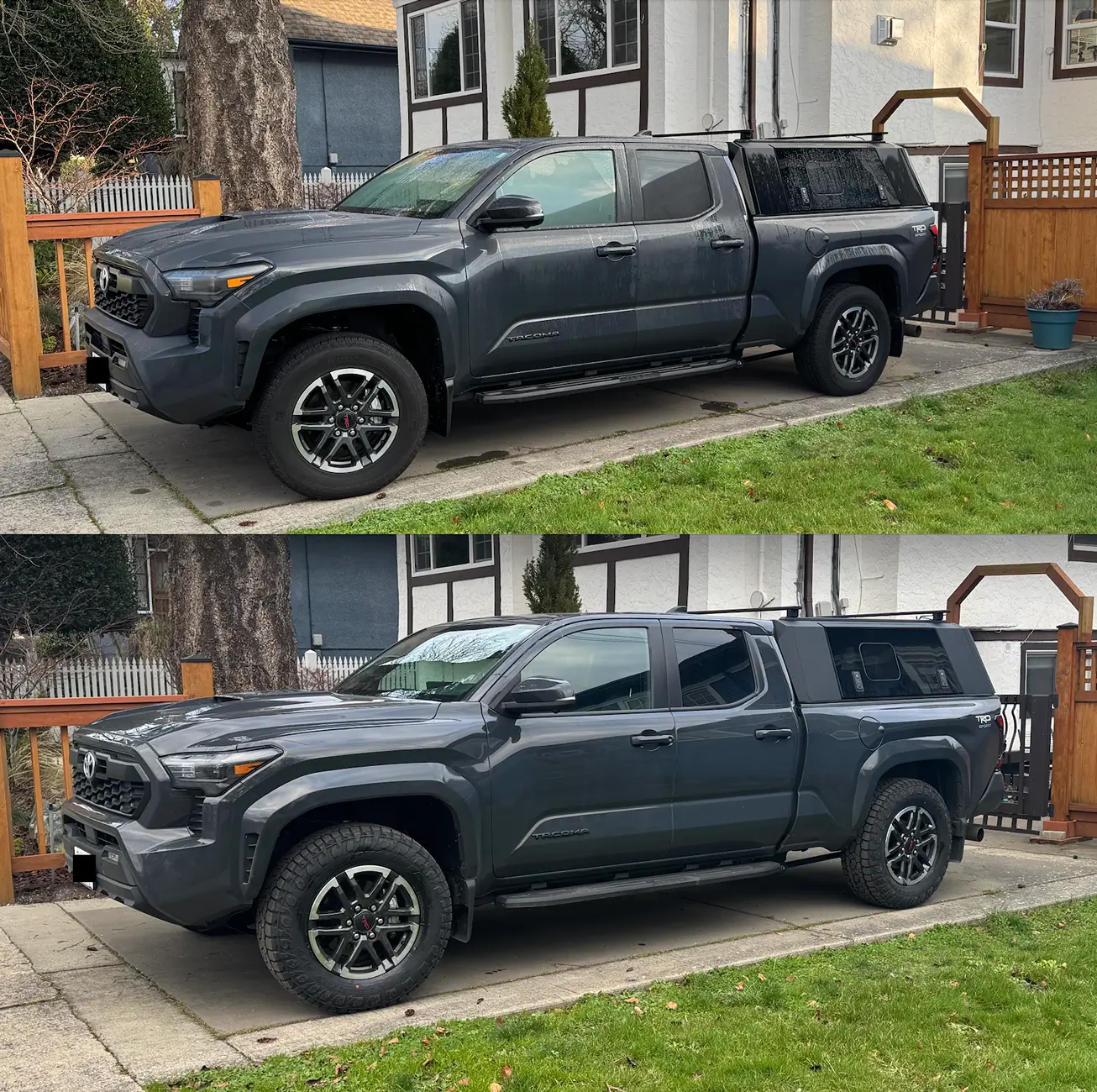

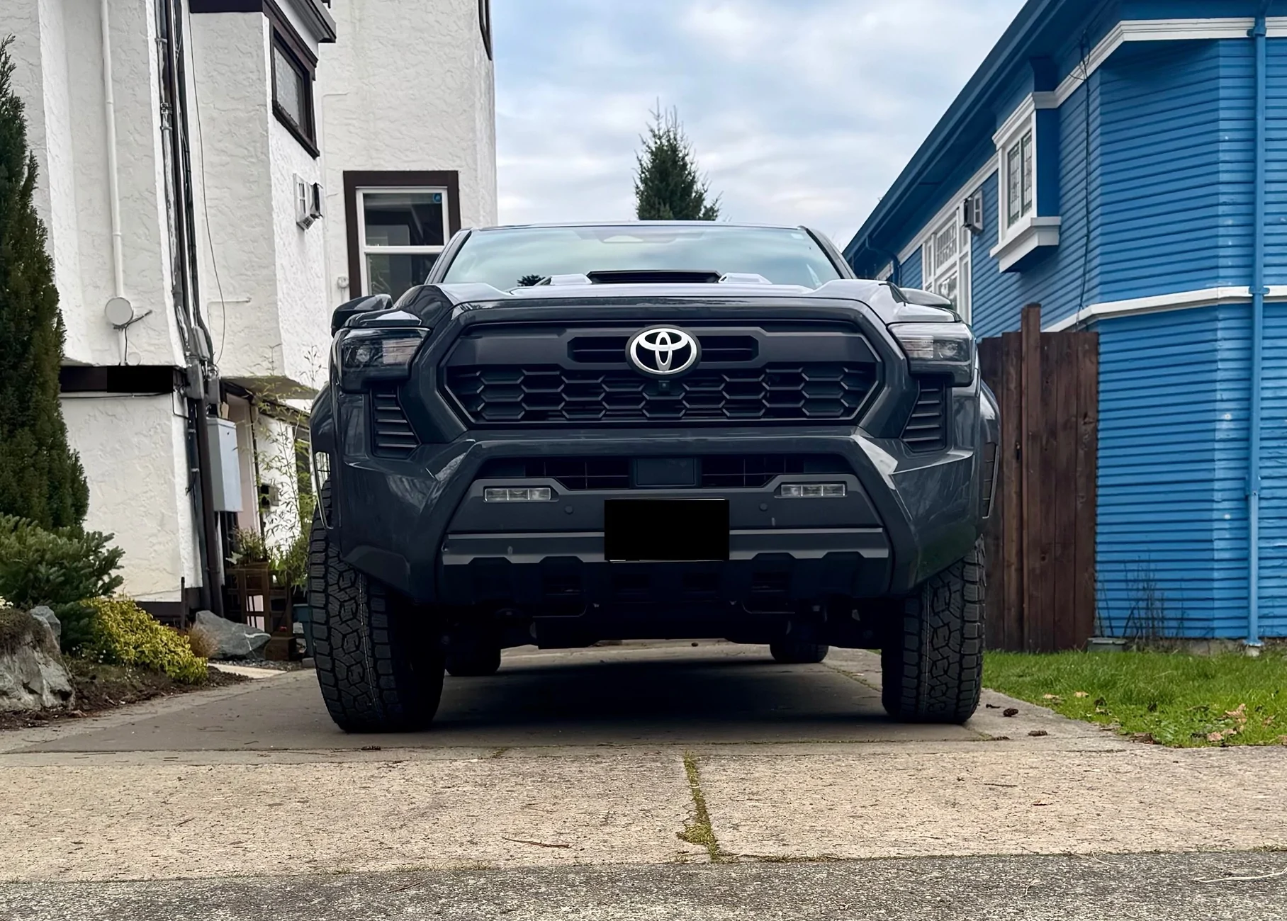

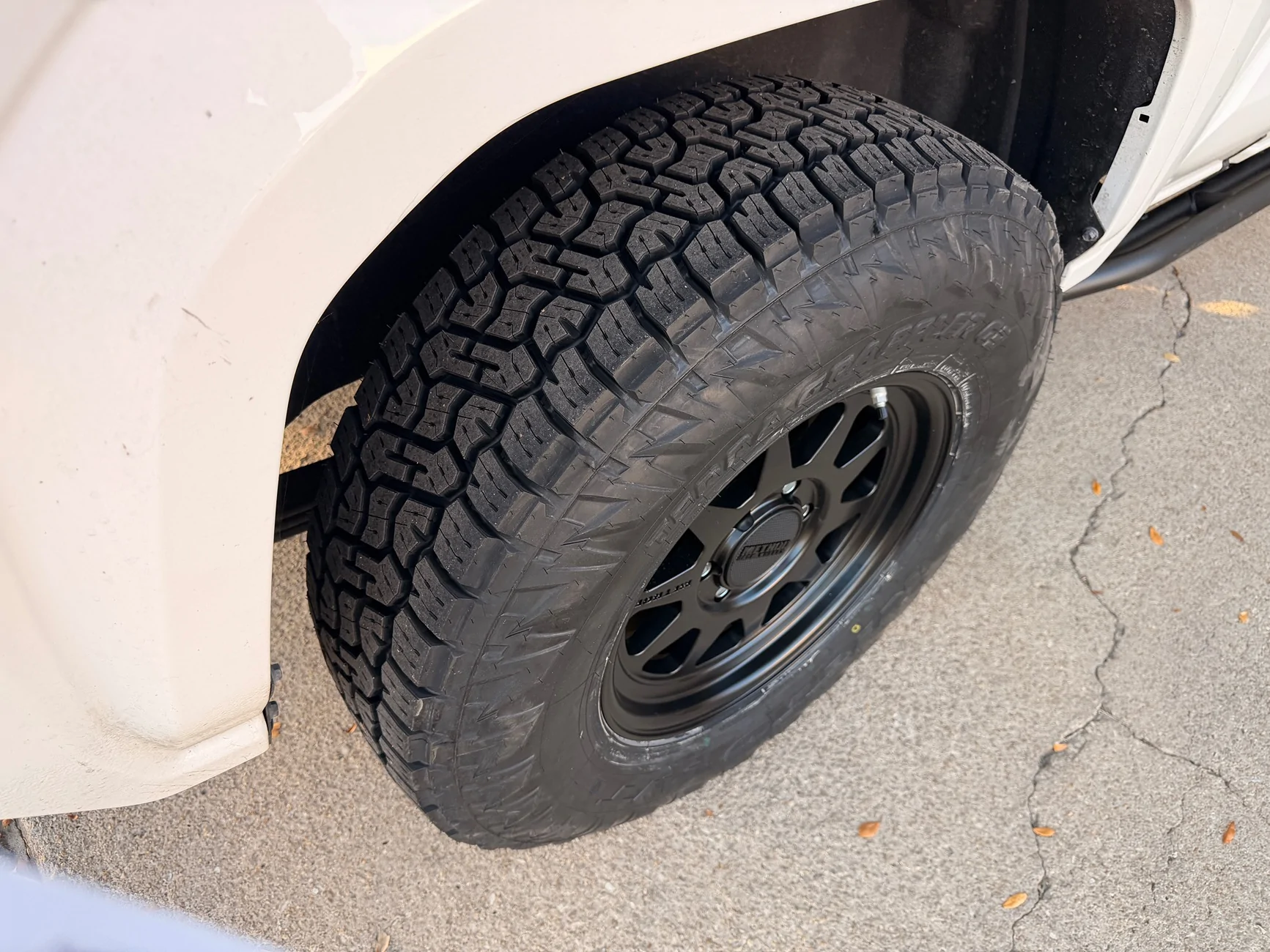

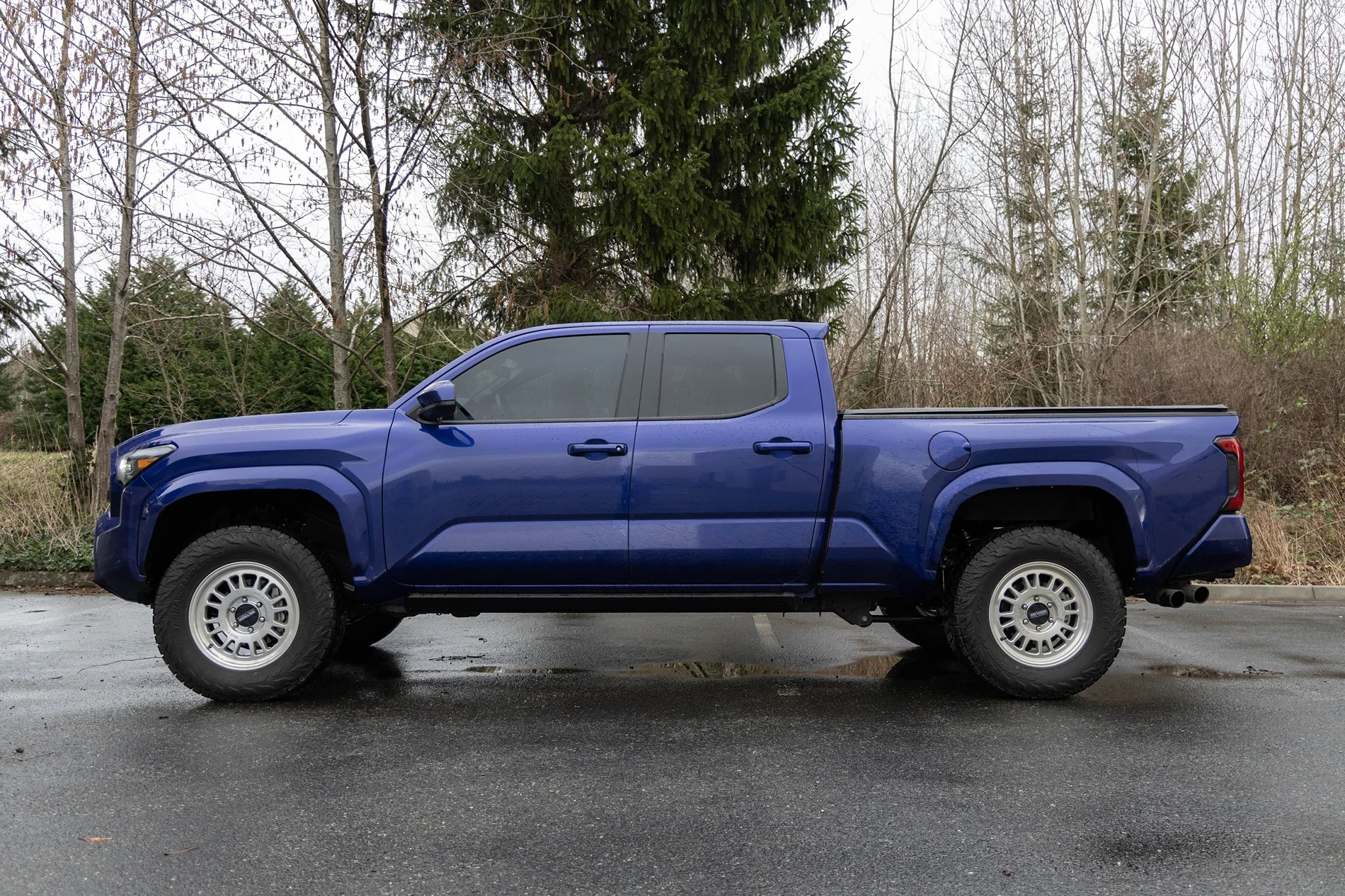

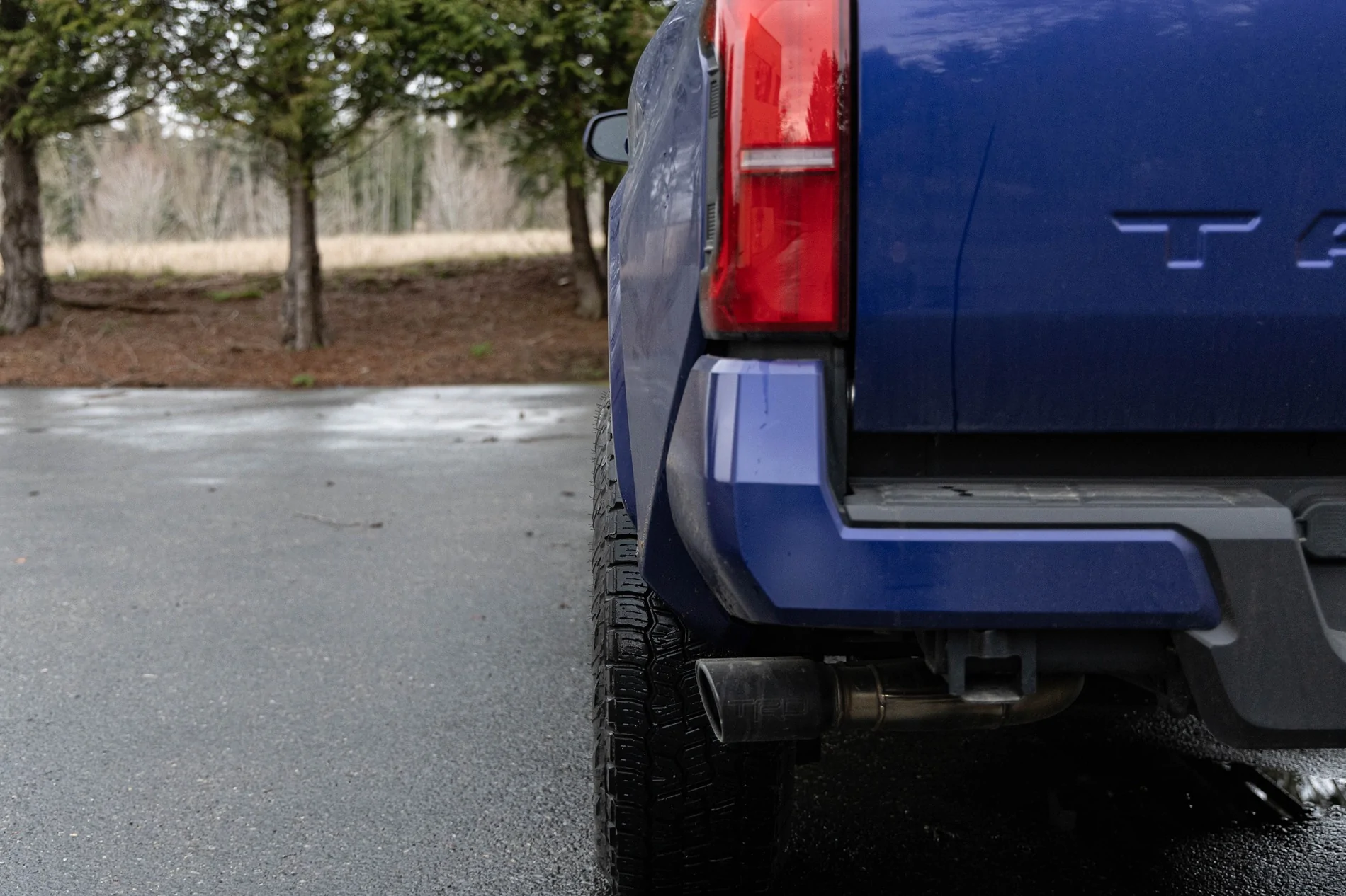

I finally tied it all together with the tires. Was stuck between 33s and 35s, ended up pulling the trigger on the 285/75/17s.
Suspension wise, the truck has Bilstein 5100 shocks with the snap ring on the middle slot, which I wanna say is right at or under 2ā€ in the front. The rear has a 1ā€ spacer, but I’m also using my air lift bags to help it about an inch or so due to the 220lb topper.
I haven’t yet stretched her out, but no rubbing during normal driving.

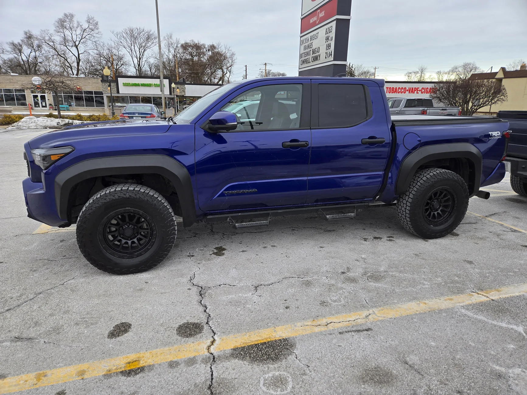

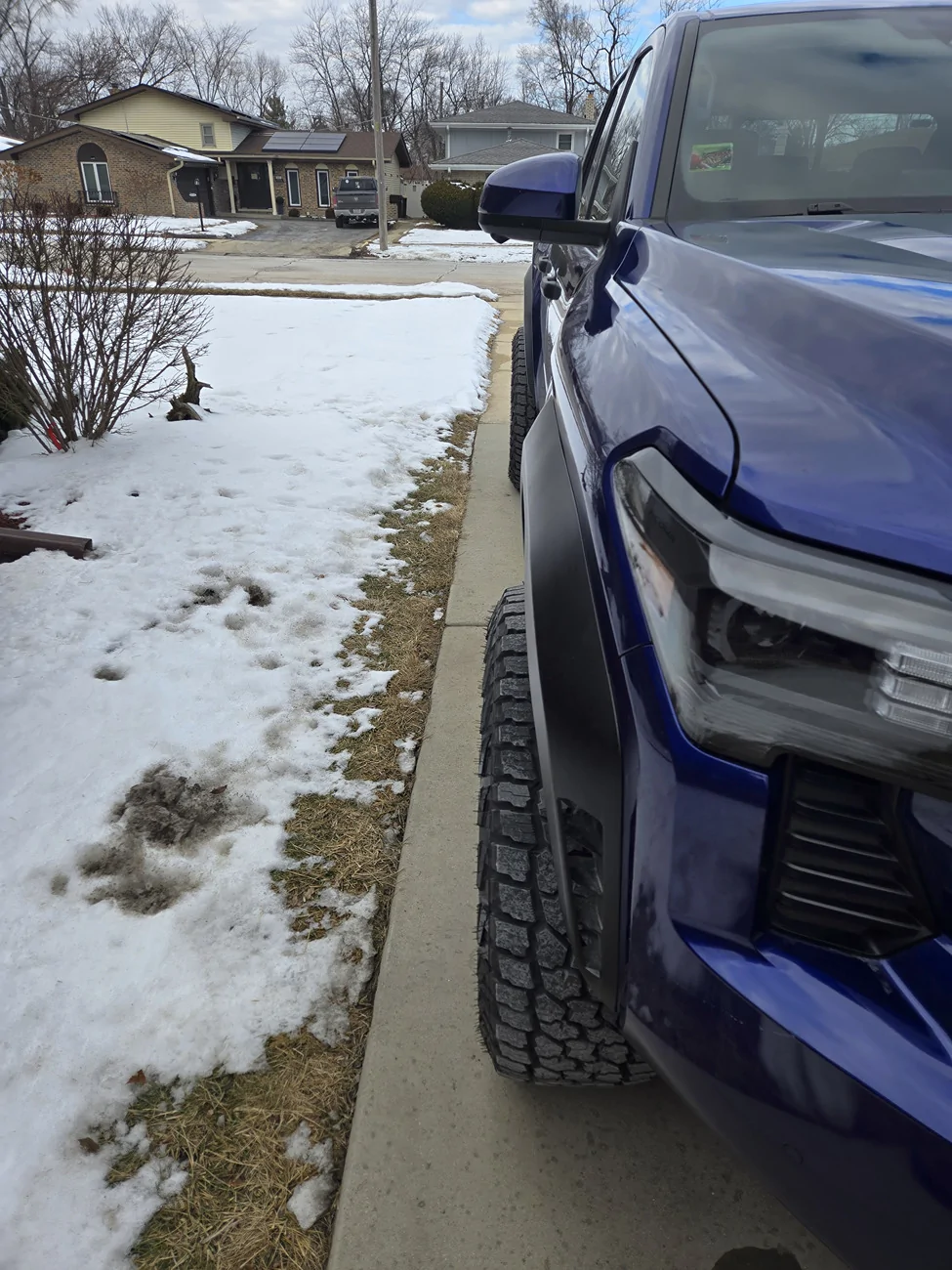

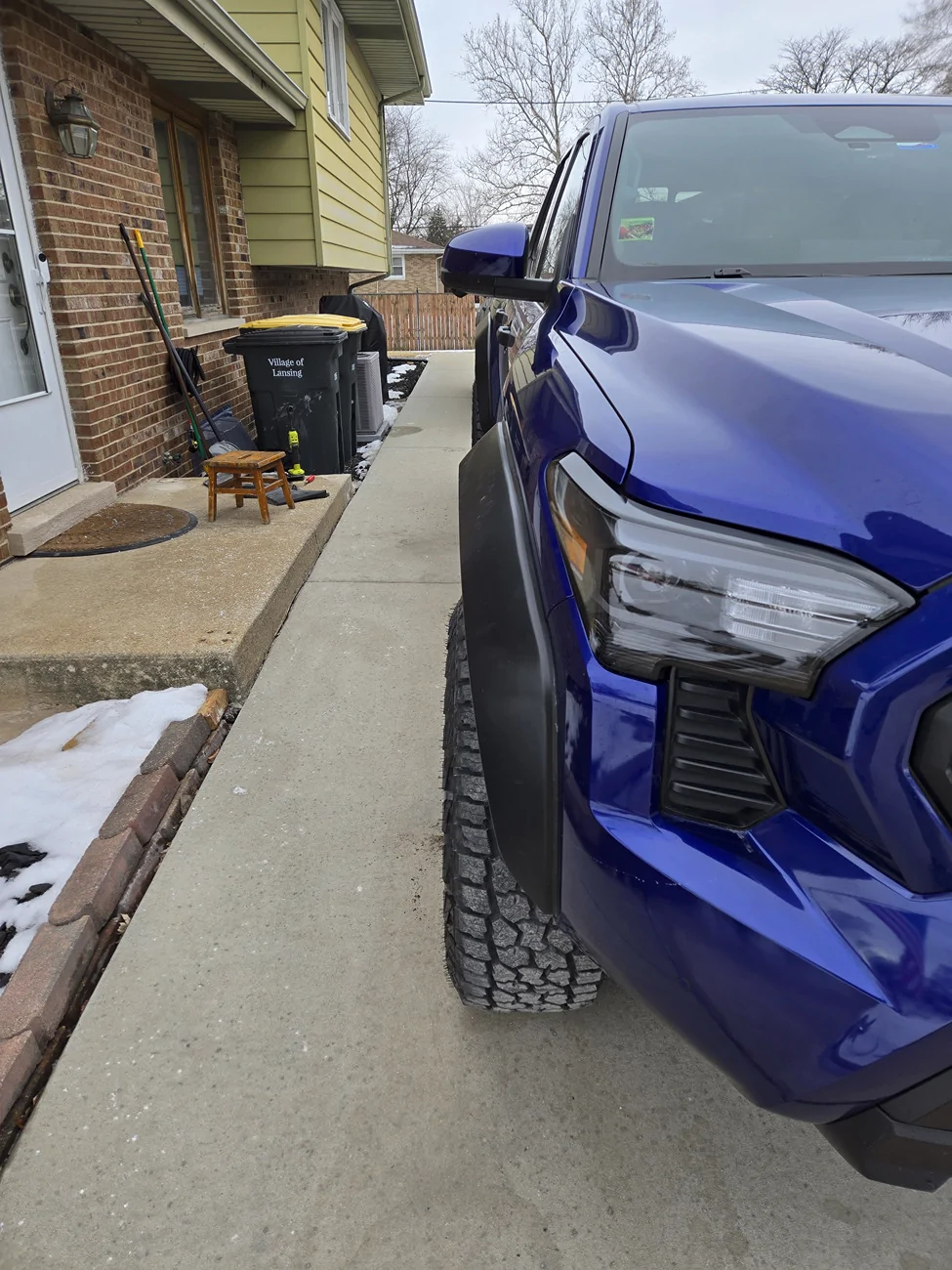

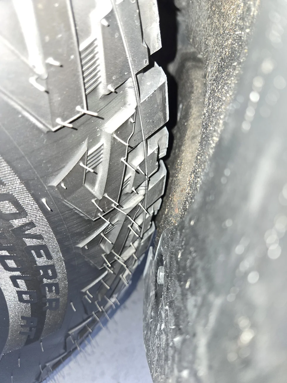

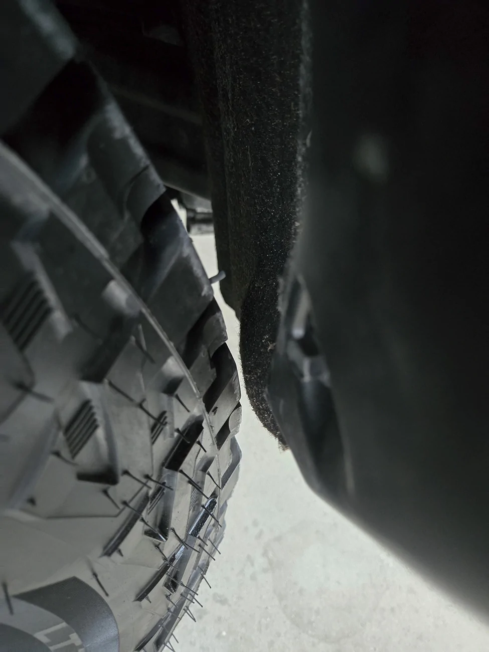

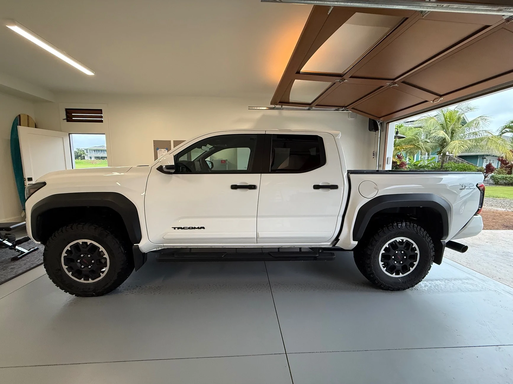

Just finished the fender flares in my driveway earlier on this nice winter day....
2024 Tacoma Off Road, stock suspension.
American Outlaw Spike 17 x 8.5 0 offset BKMTXX wheels.
Cooper Discoverer Stronghold AT LT285/70 17 126S E1 BSW tires.
Rough Country Sport Style Fender Flares for Toyota Tacoma (2024-2025) - 1.75" Extra Tire Coverage, UV-Resistant ABS, Flat Black.
Important note: the factory wheel flares MUST be removed as well as the mudflaps for the Rough Country flares to go on the Off Road variant.
Wheel and tire work courtesy of Discount Tire in Highland, IN.
Pictures are of "tire poke" before & after, front tire fore & aft clearance (tight!), and a side view on a grocery errand.

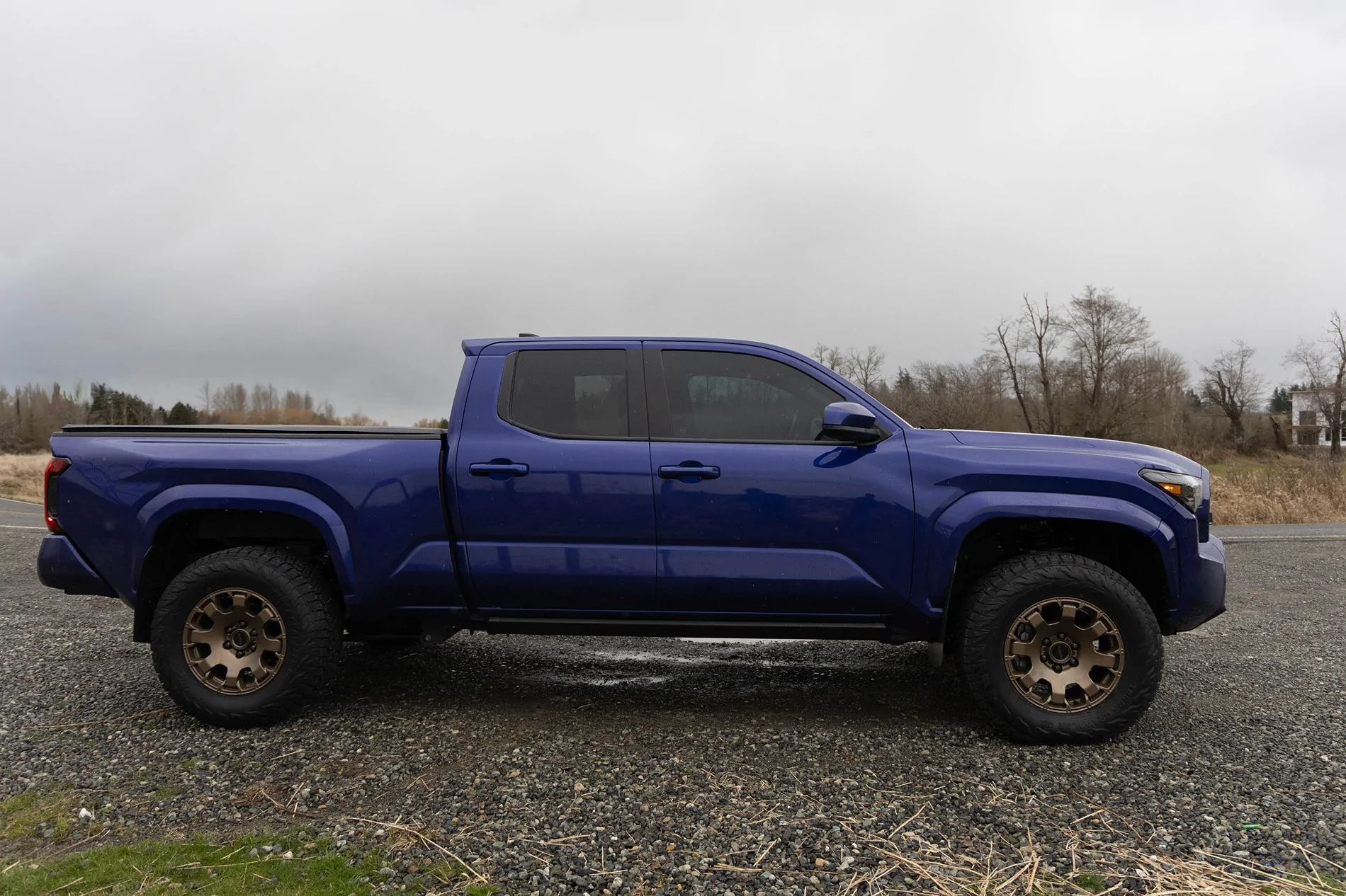

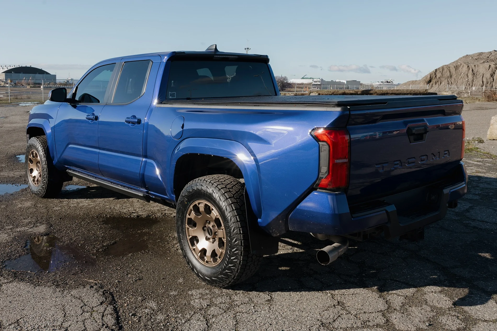

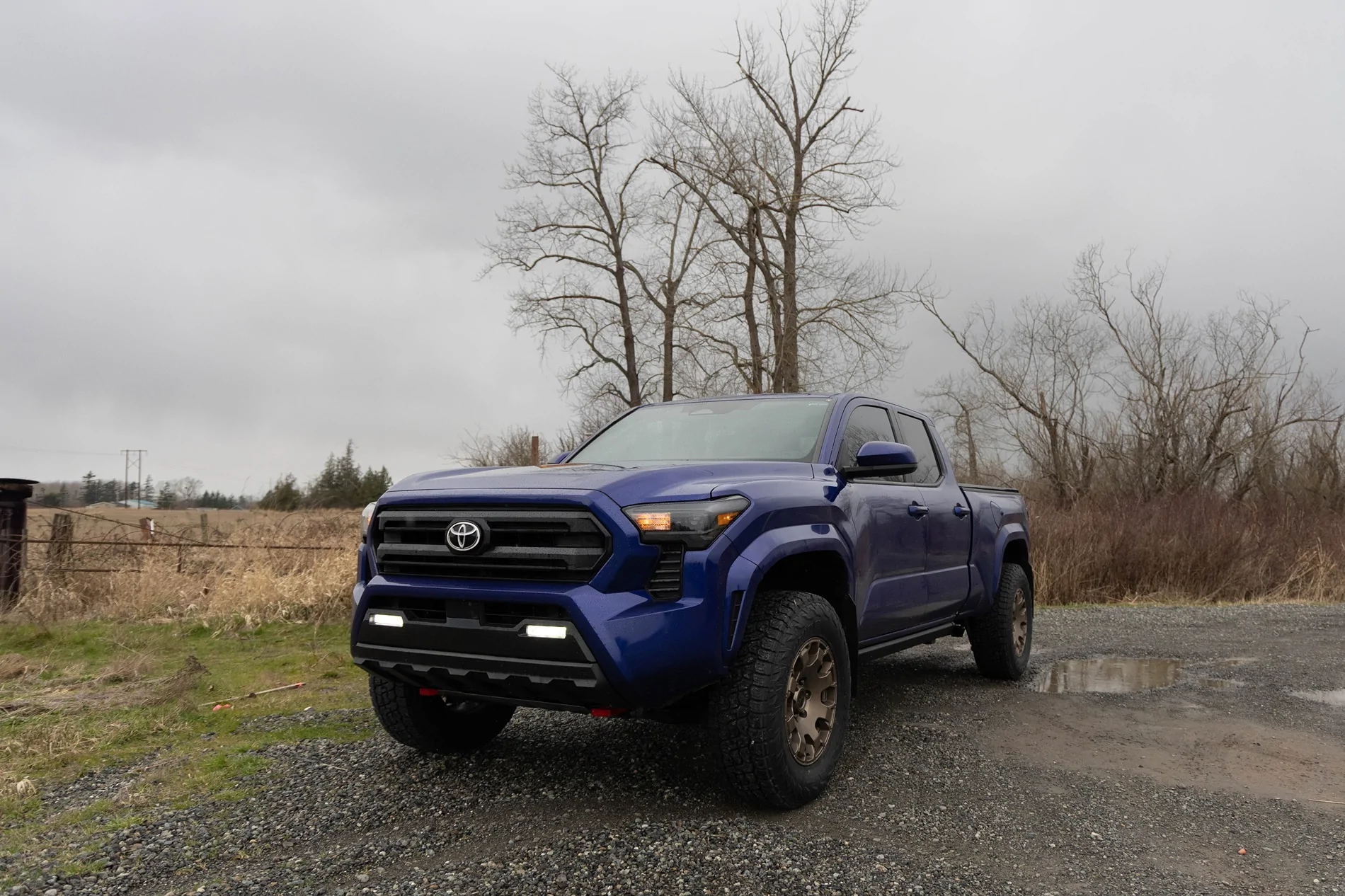

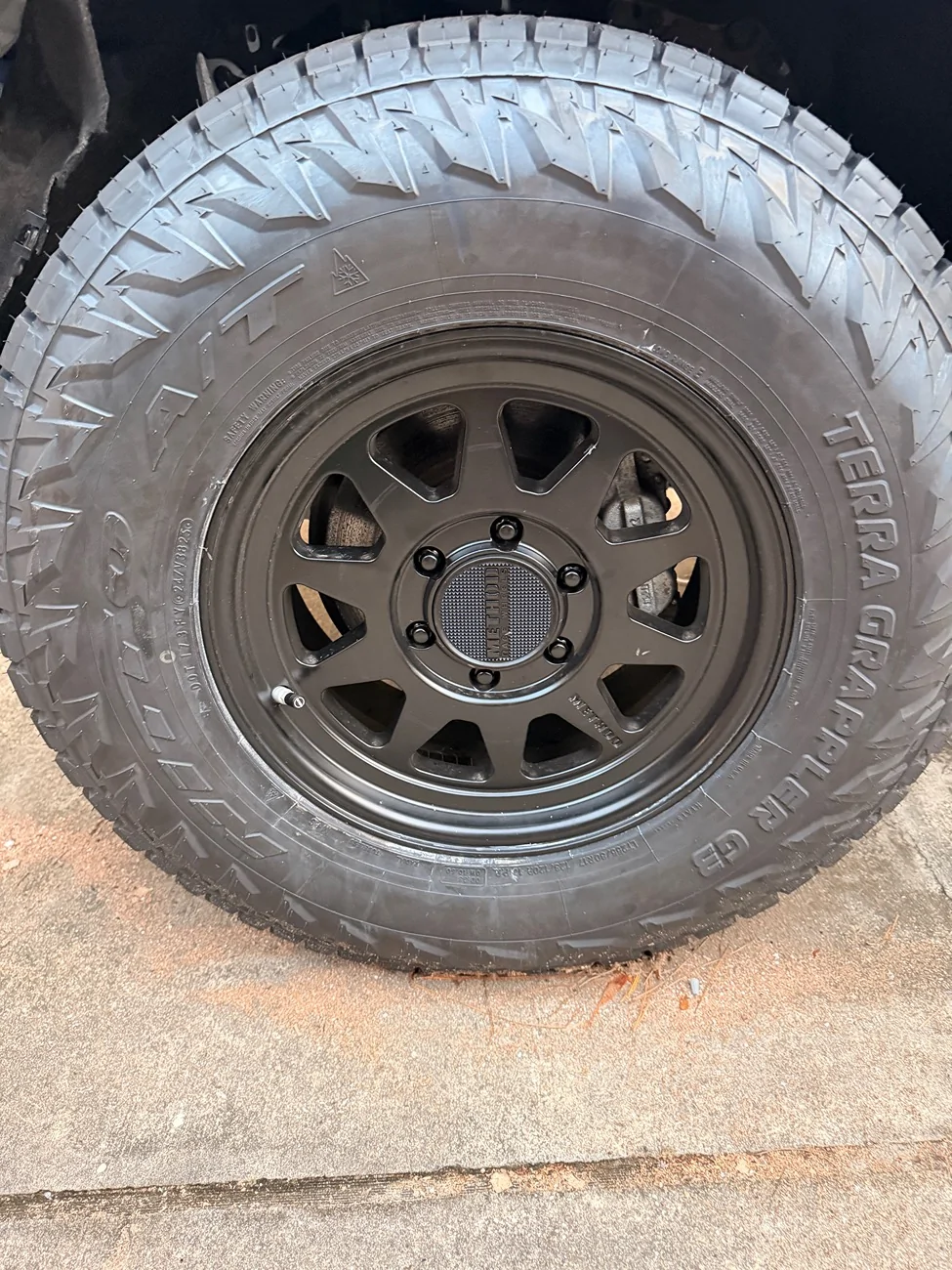

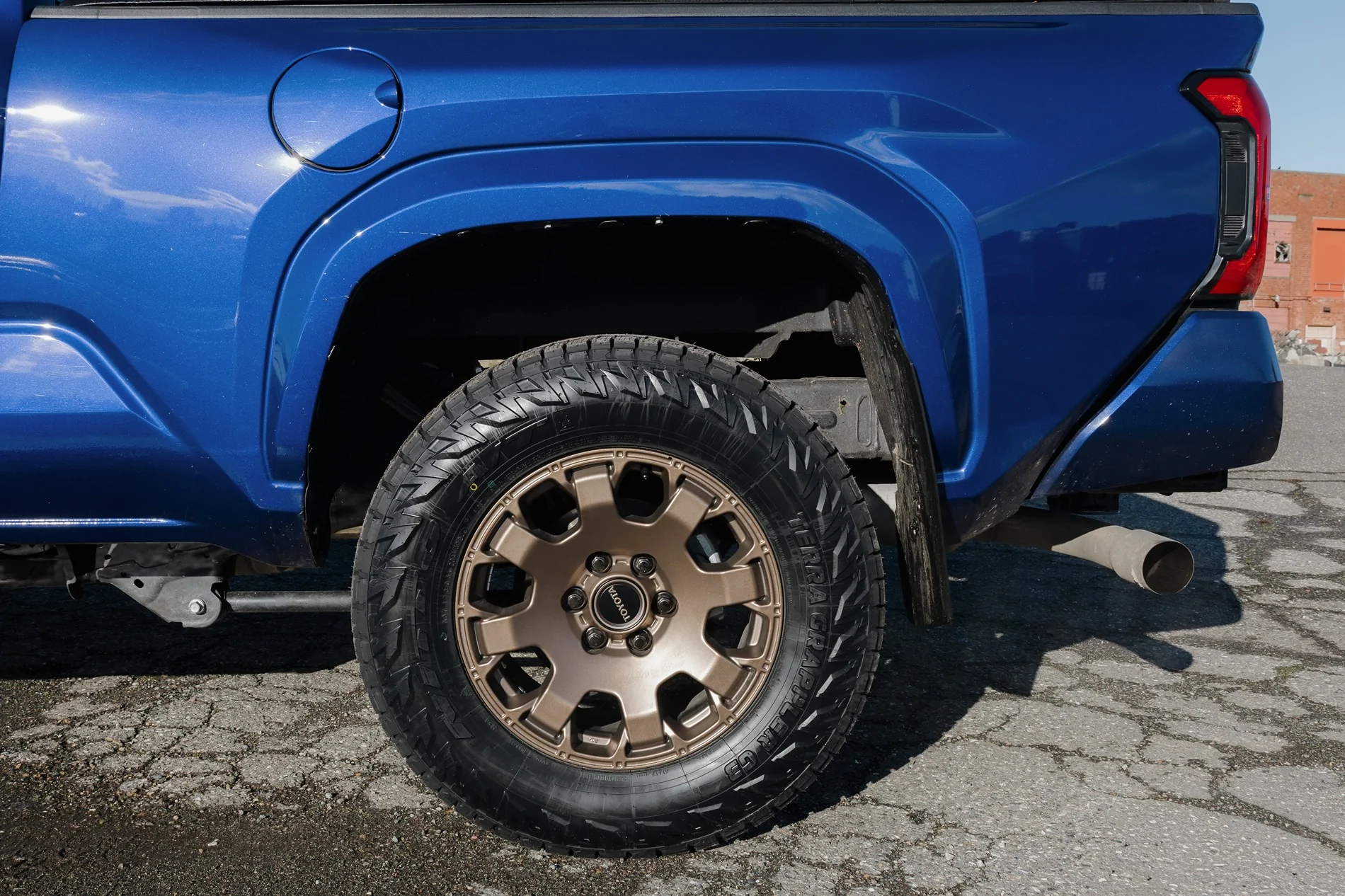

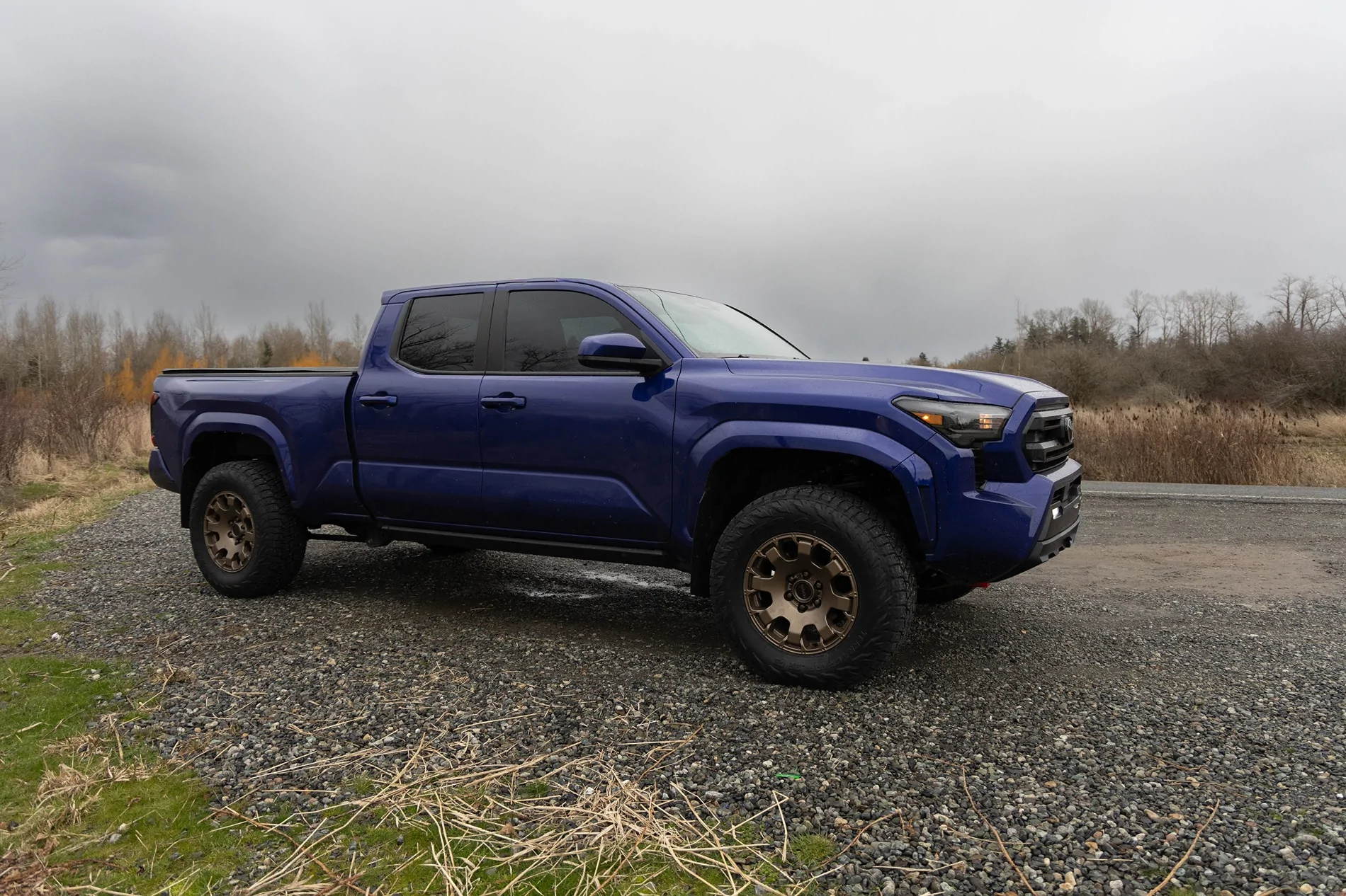

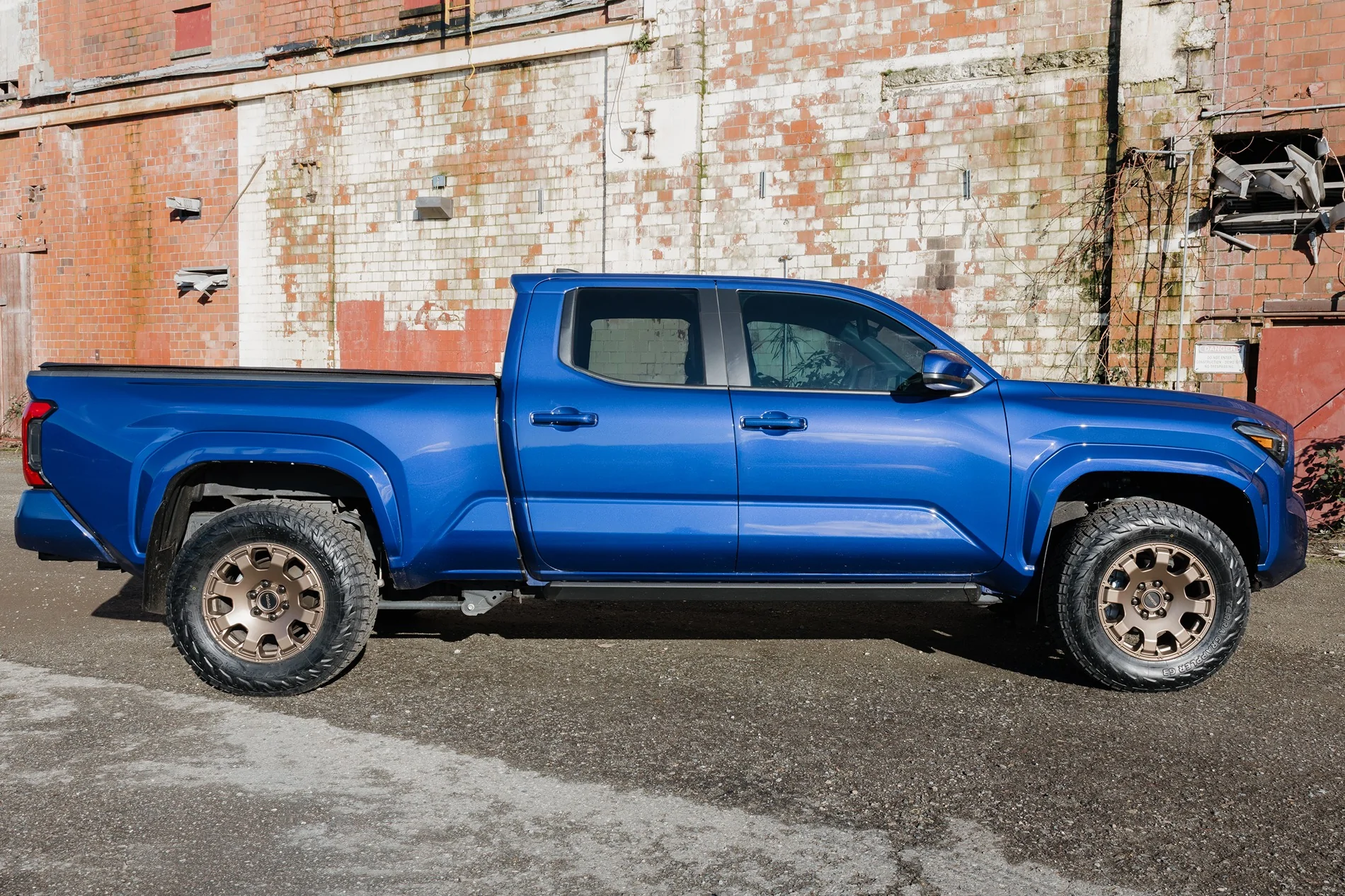

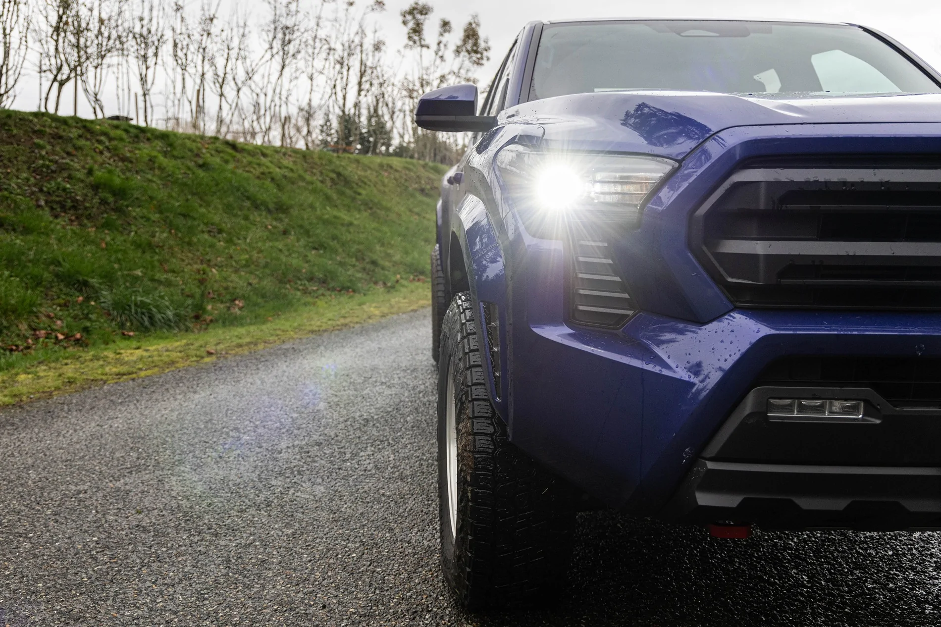

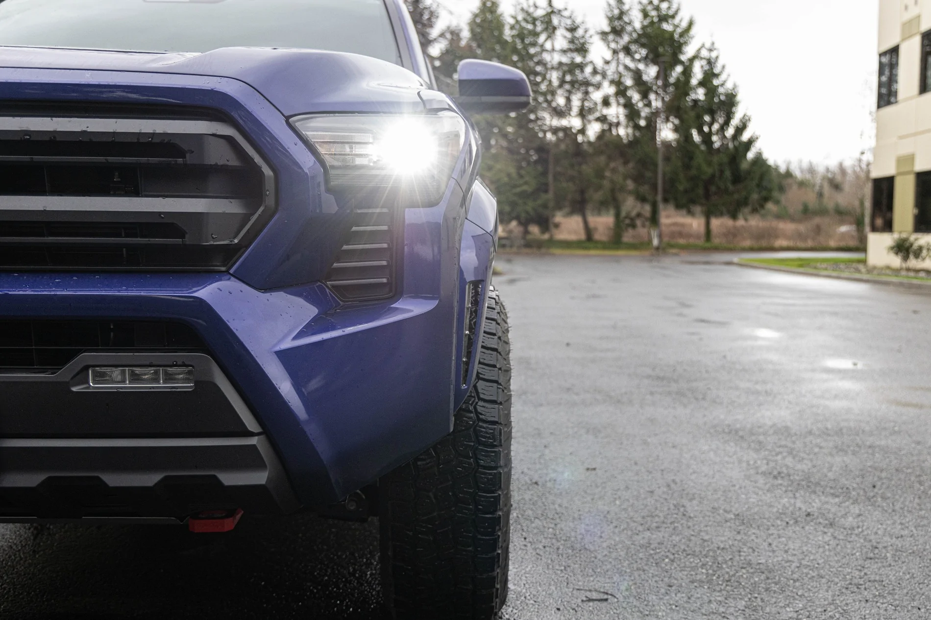

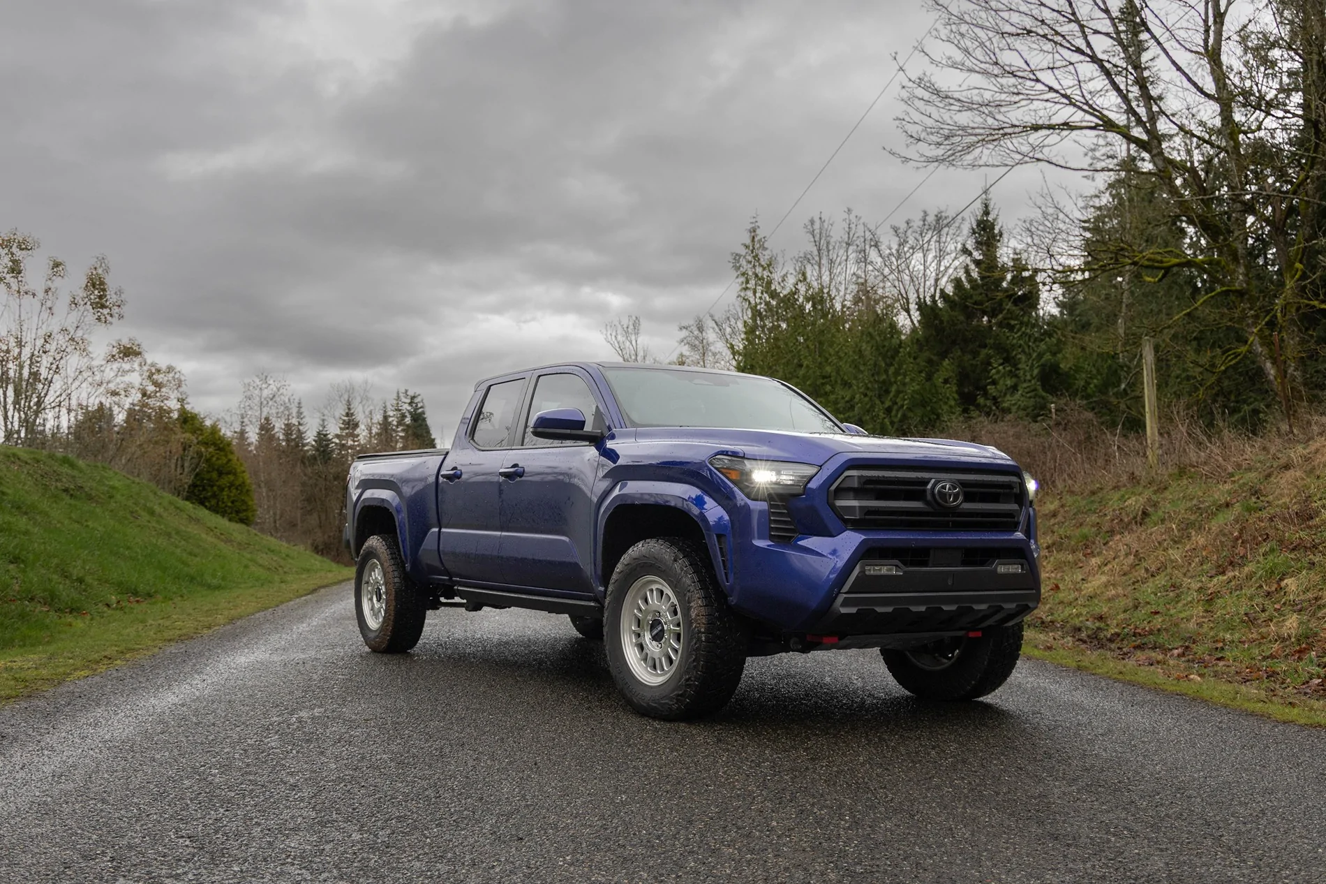

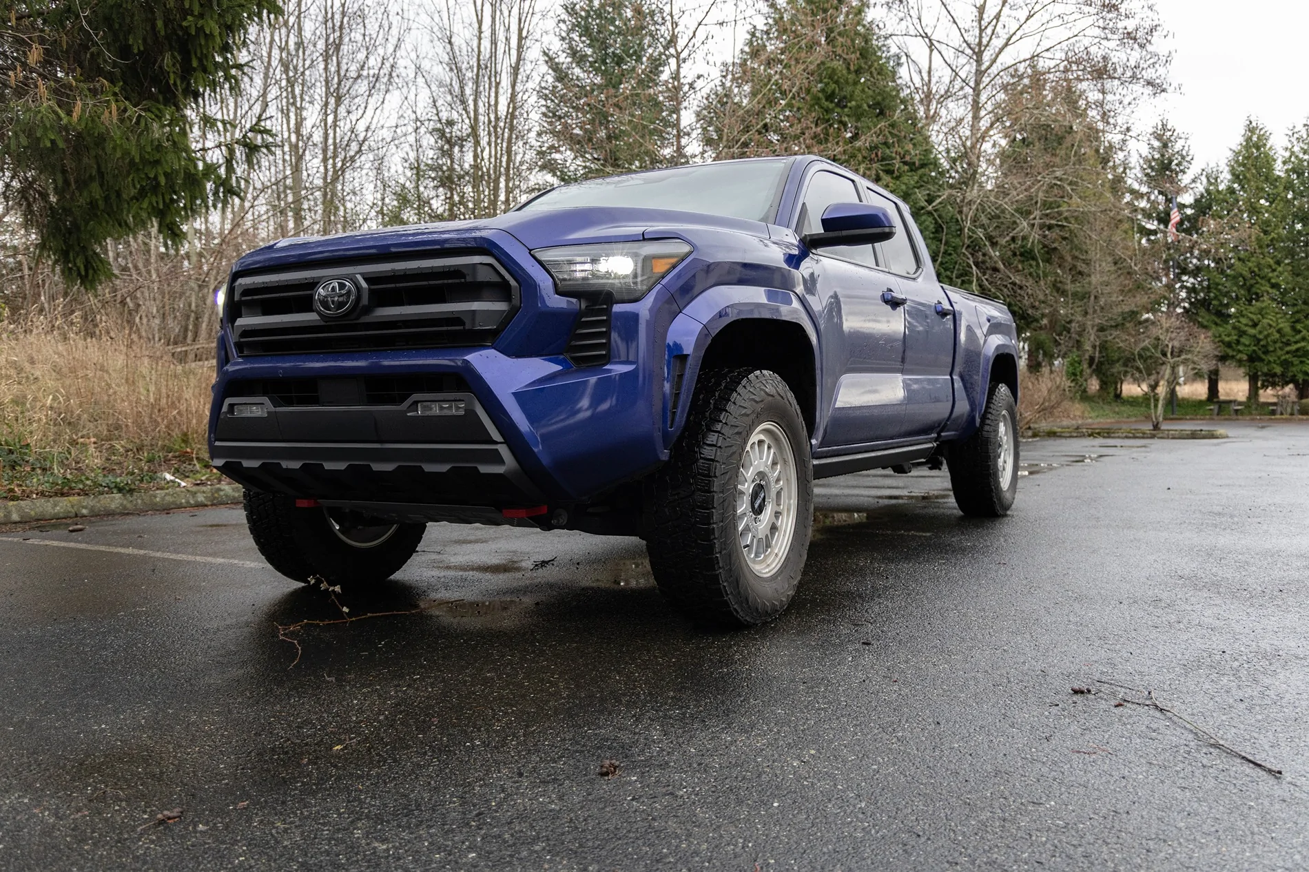

Updated:
2025 SR5 DCLB 4X4
Toyota Trailhunter Wheels 18x8.5 + 20mm offset
Nitto Terra Grappler G3 Tires in 275/70R18
Bilstein 5100s on 1st perch setting in the front + Apache Offroad 1/2" rear spacer
