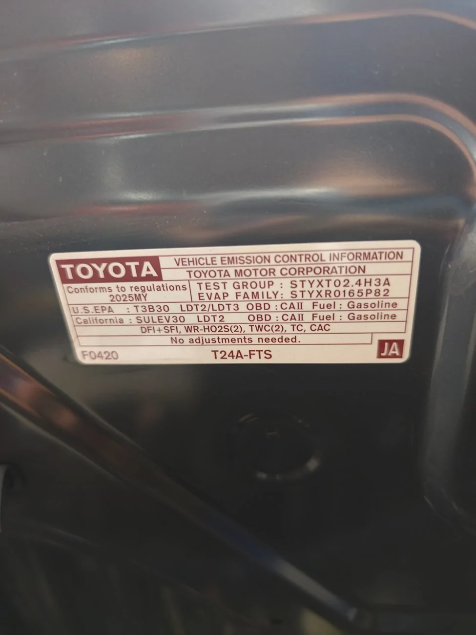

How Toyota got away with only PCV and cats as the emissions equipment on the T24A-FTS is also very impressive.
2024 Tacoma Oil/Fuel Dilution Concerns... IMG_20251113_170251_1
No EGR, no secondary air pumps, just PCV and cats.
I don't know how they did it lol

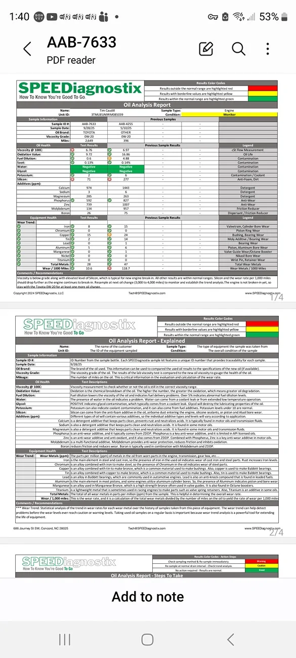

Here is my last two changes. Notice the first change was 396 miles, column to the right. Fuel dilution much better and contributed to proper driving to seat the rings.
2024 Tacoma Oil/Fuel Dilution Concerns... Screenshot_20251114_134011_Samsung Notes
