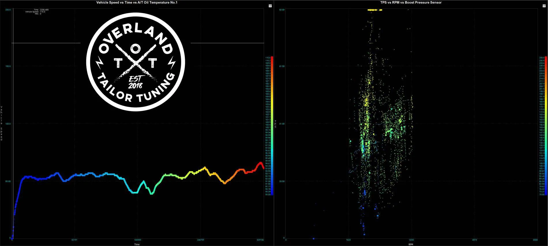

Sure thing!
I'd like to clarify/provide some context here just to keep everyone on the same page and keep any future comparisons in perspective.
The "as delivered" run shown below (Red) was on 85 octane. Here in Utah that is "regular" grade fuel due to our elevation. Not 87 octane as most other states will use as their "regular" fuel grade.
The "premium" run (Blue) was on 91octane.
The "Beta" calibration (Green) was also on 91 Octane, with the same peak boost level as the OEM tune.
A few additional details that might be worth pointing out:
At present, we're unable to effectively "gear lock" the transmission to get full RPM sweep curves showing the full extent of changes from 2,000RPM-Redline. This makes it impossible to effectively show any TRUE gains below 3,500RPM as going "WOT" at any RPM below this will command a downshift and completely ruin your run. This means any pulls with data below 3500 (at present) should be scrutinized, as it's challenging to be consistent with part throttle pedal application from run to run. It would be VERY easy to make something look like it's delivering much more "torque" than is present - you're simply seeing the operator using a greater percentage of the available torque by variance in pedal how much pedal was applied at that specific RPM, than a true representation of the actual output delta.
We've elected to present only data that shows true back-to-back gains where the operator consistently produces repeatable results (foot to the floor).
I'd also like to reiterate that our goal for this calibration is to retain the ability to safely run 85-94 octane fuels in all environments, including towing to the vehicle's maximum rated capacity. Be mindful of this when considering tuning options for your truck. You may find many require premium fuel, or they were never properly tested in all conditions or towing.
We are.

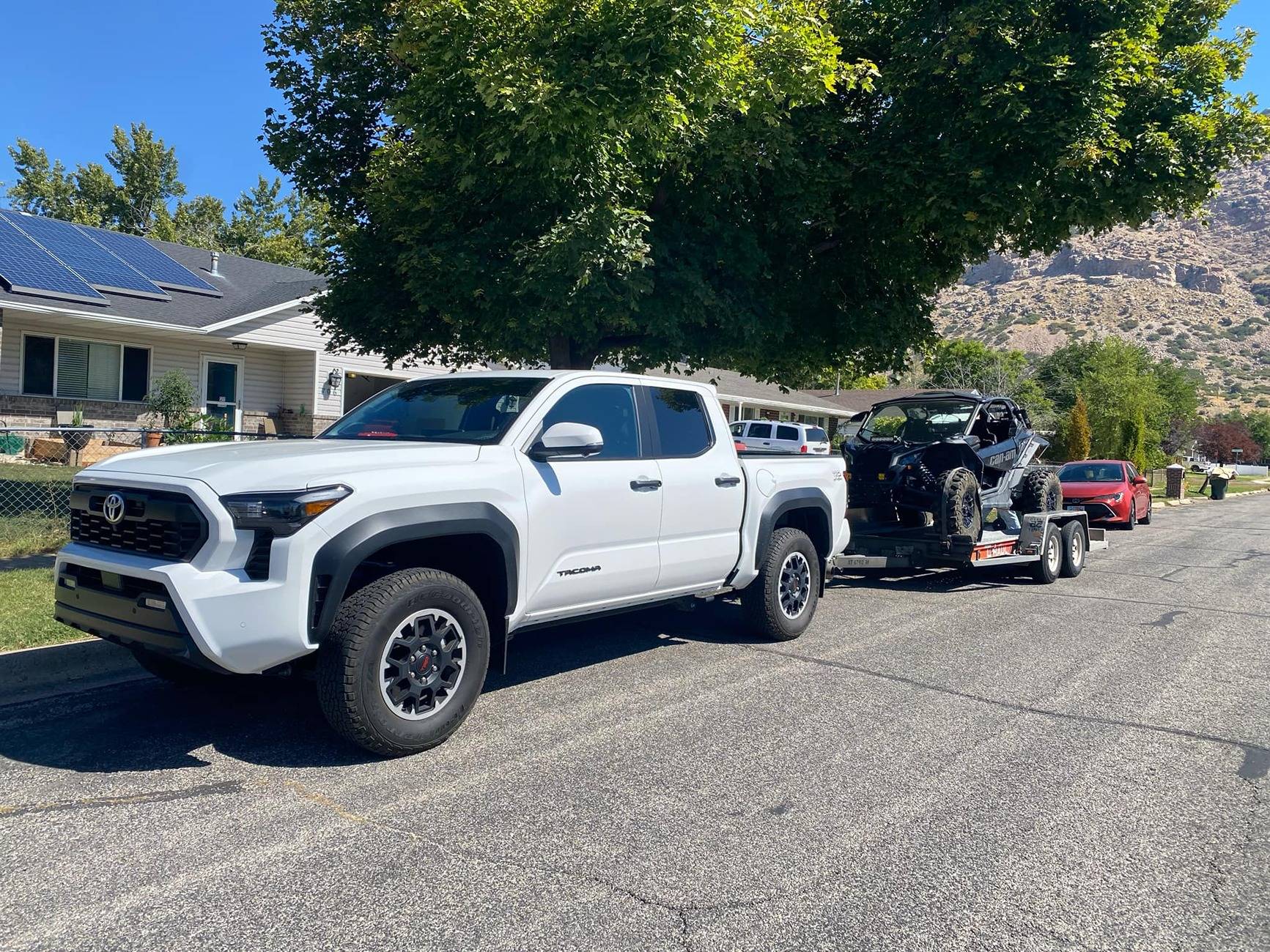

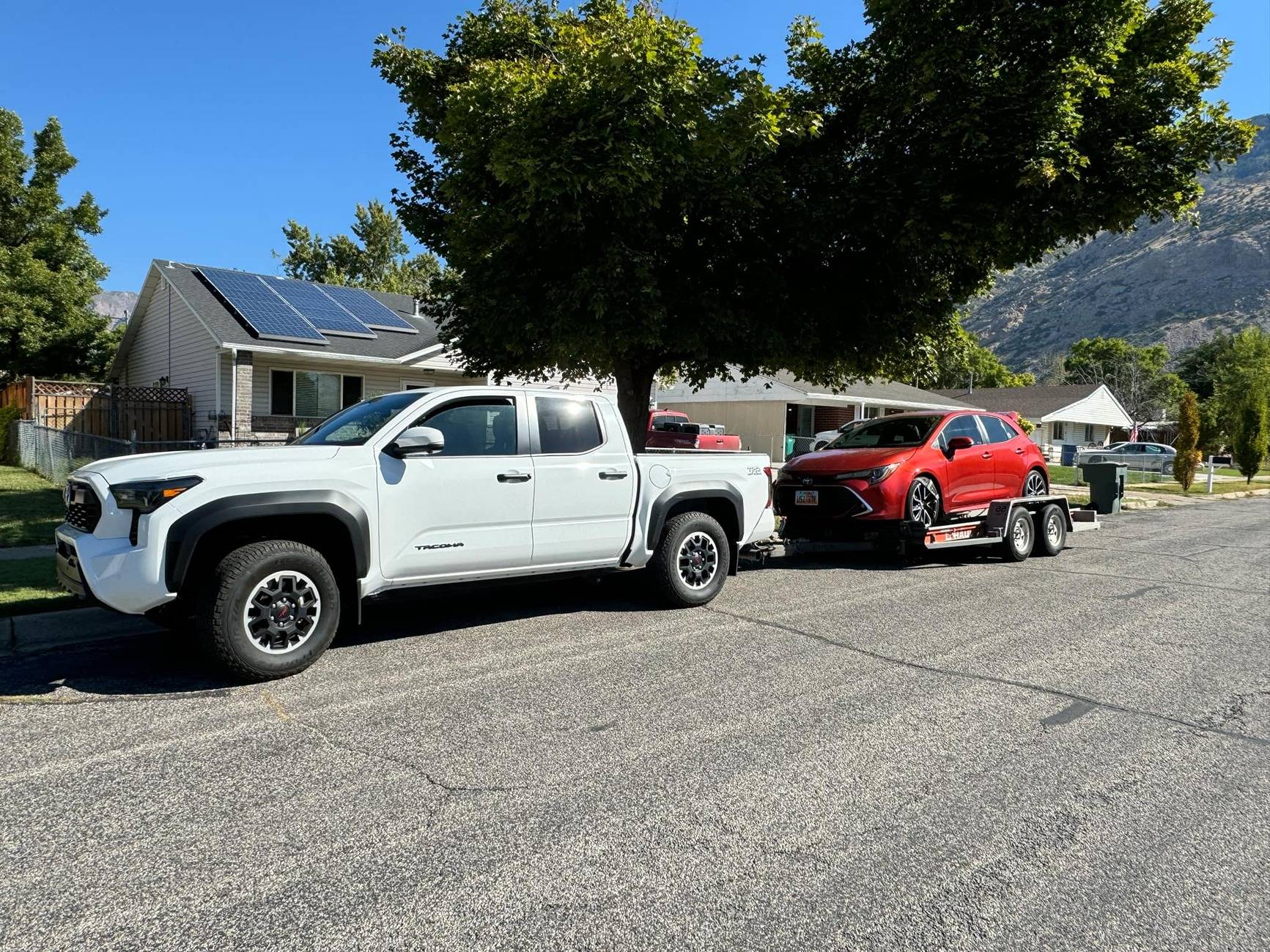

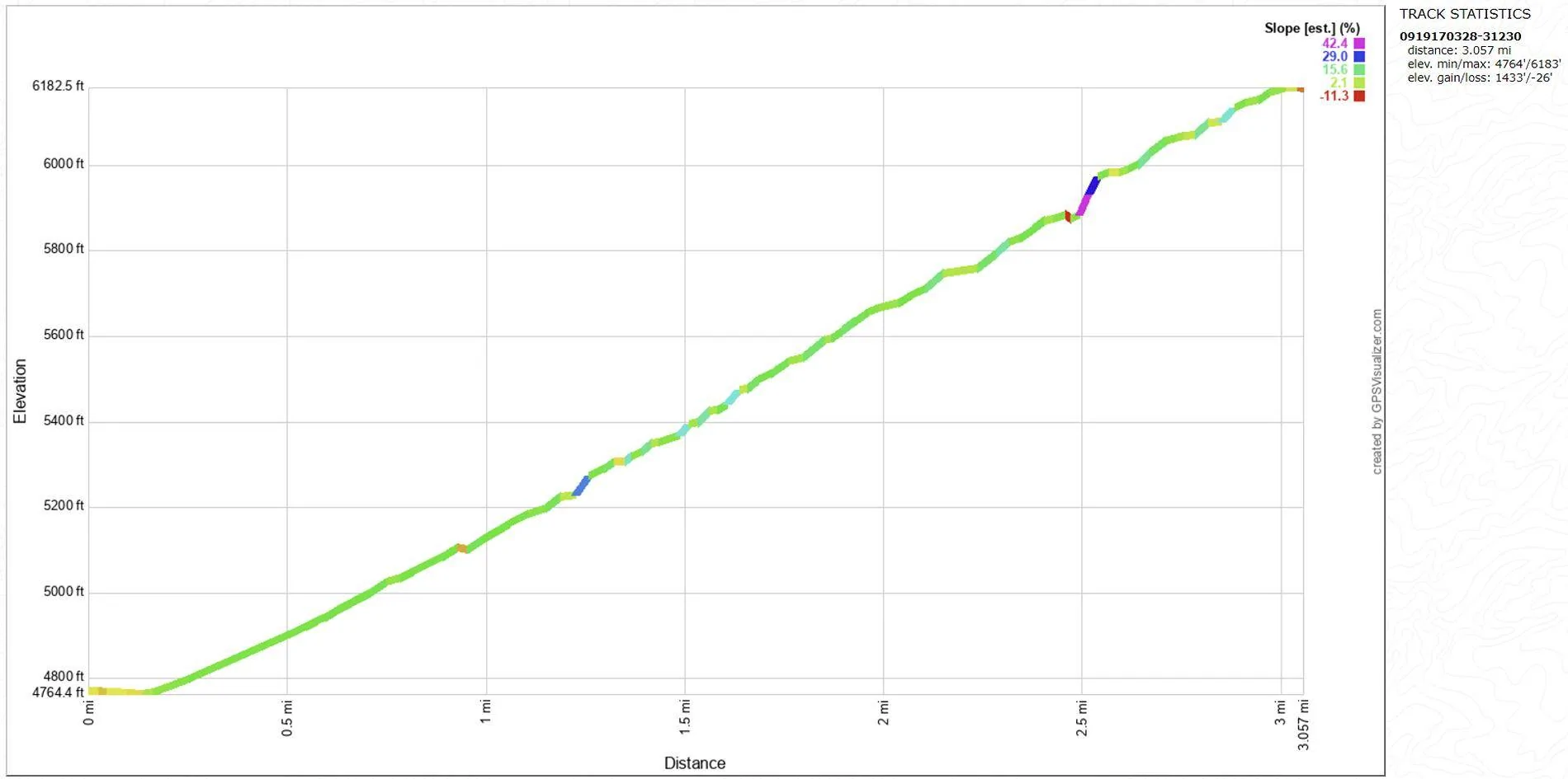

Testing 3700lb and 6000lb payloads:
Putting the truck through the ringer:
