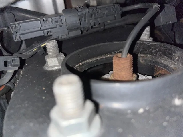

I have a 2024 Limited non-hybrid model. Can anyone tell me if this issue applies to the Limited model also (AVS). Also, I am not clear exactly what is failing based on all of the pics. Can someone point it out to me please?

@CEtaco There is a good picture of the top hats that fail in post #128. You could compare that to the top hat in your Limited to see if it is the same. I think it might just be Off Roads, but I'm not sure.

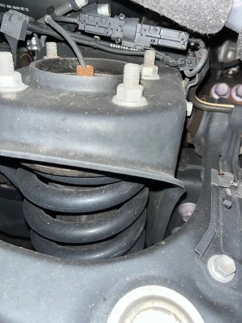

Thanks everyone for the responses and the information. I took a look at my Limited and both of the fronts look fine as of now. However, the top post of each strut where the AVS wiring comes out is heavily rusted. I will be mentioning it to them at my next scheduled service appt. Has anyone else noticed this? I believe it's just cosmetic at this point.
