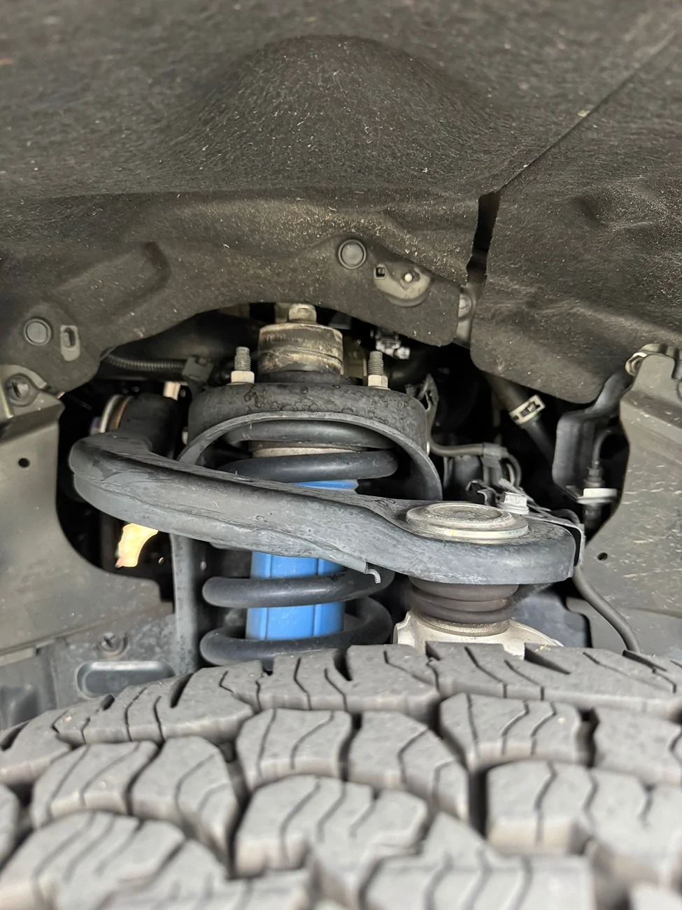

Just got a 2025 offroad premium, does anyone know if this problem has been fixed in the 2025 models? I just took a picture of the Top hats they look the same as the 2024, not sure may if the part is updated?
Same

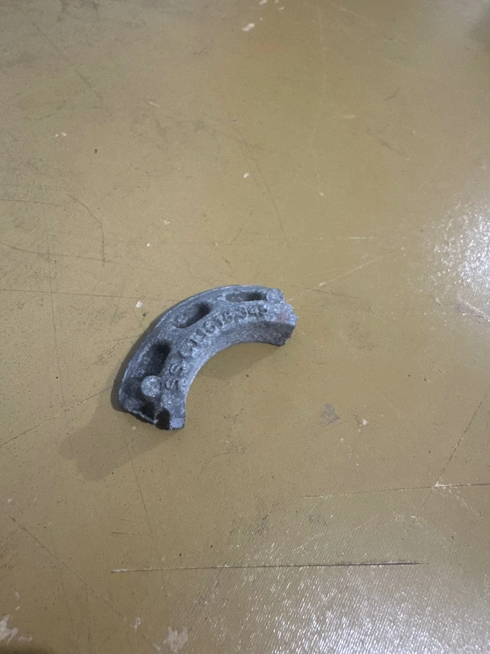

Had this happen to my truck; 2025 TRDOR w/16k miles. I ran over some kind of small animal carcass on the highway….
I ended up ordering the dobinsons steel strut mounts which should fix the issue once and for all. In the meantime, am I hurting anything MORE by driving the truck? I feel like the only issue is the obvious tapping noise, and the loss of dampening on one side…
Even as a Toyota fanboy, this is so frustrating and stupid - why Toyota? Why make such a key component so weak?
