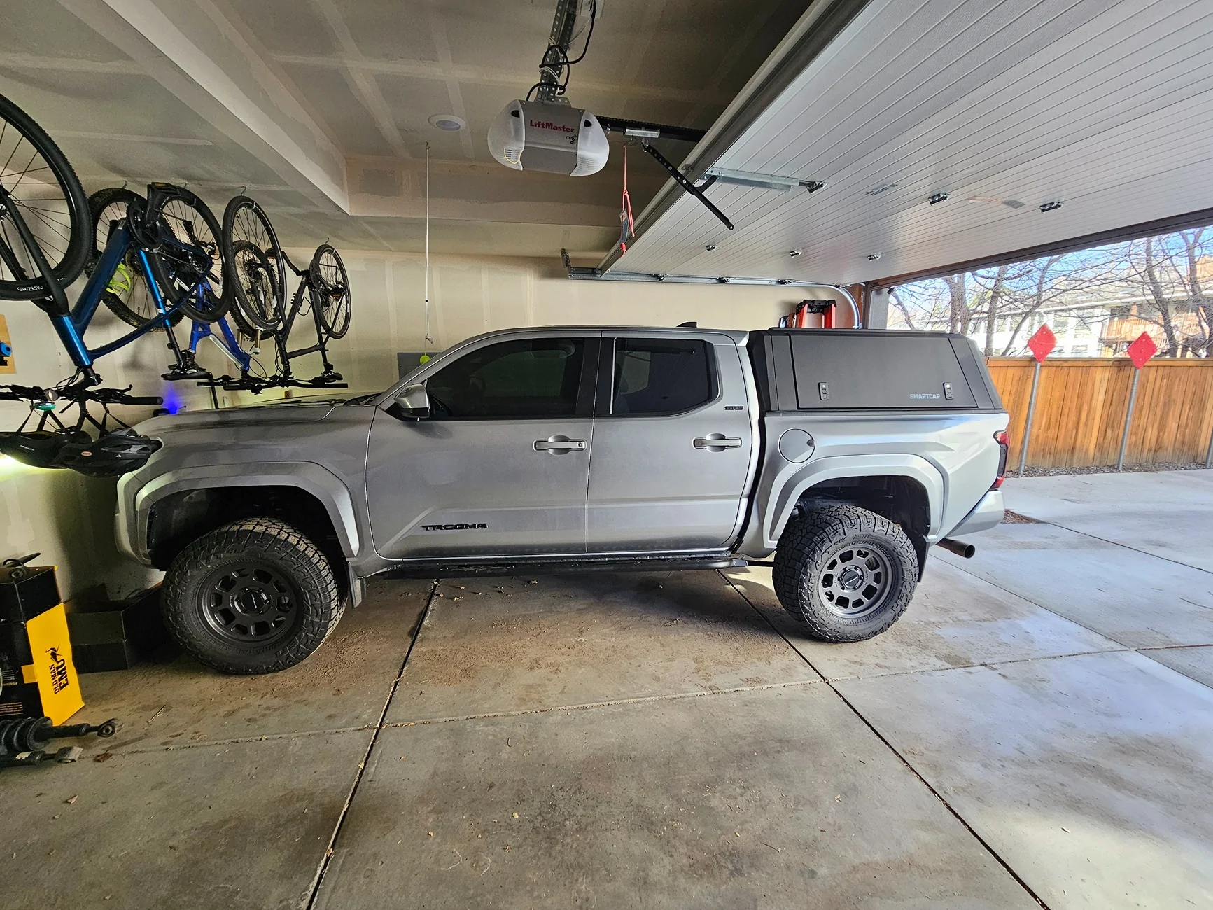

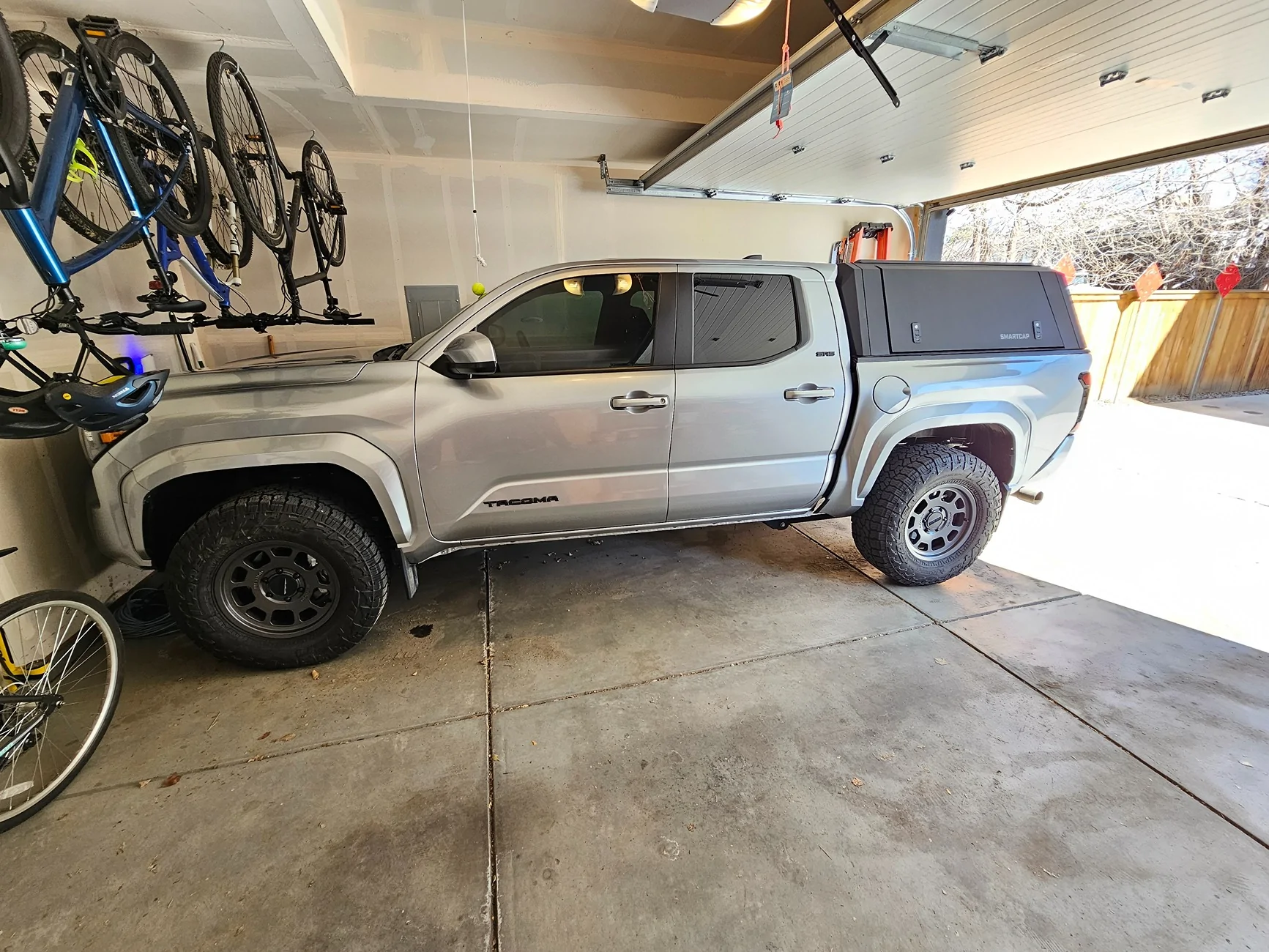

Good day everyone!
I'm looking at upgrading my suspension and would like y'alls input on overlanding setups.
I've currently got a Smartcap, DIY platform and rock sliders totaling about 440lbs constant weight with plans of an Engine/Gas skid. No plans for a bumper or winch (yet?).
I have a TRD OR long bed and dont want to spend top $$ unless its absolutely necessary. I'm looking at the MT64s from OME but considering the 6112/5160 setup once I get more info about the 6112s when they come out. Looking to get through this year before dropping the $$ on the suspension with UCAs (Icon delta joint over the OME). BP51s are also a consideration but they are def more $$.
I've exhausted youtube and called shock surplus and they just regurgitated their youtube stance. I welcome all your input, good bad or ugly HAHA.
I purchased the MT64 full setup, including the OME UCAs. They have rear springs rated for 440lbs. Getting installed in a few weeks so will let you know how it rides. I have the same setup as you (smartcap, sliders).
I originally was going to go Icon Delta Joint Pro, but read too many negative reviews regarding constant maintenance amd squeeking. Seems like the polyurethane bushings aren't ideal. That's why I went with the OME UCAs
