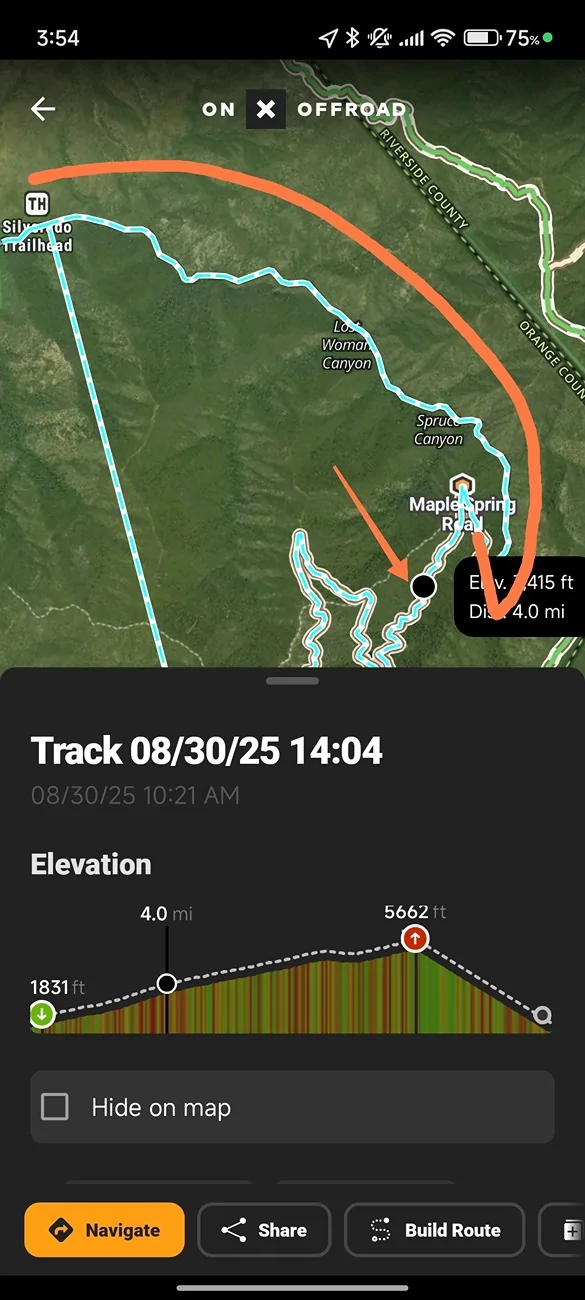

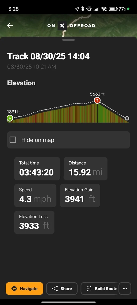

Figured I'd contribute, since the unmentionable other site has.. issues.
  • Transfer Case: 2Hi, 4Hi, or 4Lo - 2Hi then 4Hi, then 4Lo
  • Transmission Shifter Position: “D” or manual selection (S1, S2, S3, etc.) - S2 in 2Hi, S1 in 4Hi, D in 4Lo
  • Drive Mode: Normal, Eco, Sport, etc. - No drive mode options on SR
  • Vehicle Speed: An average speed is great, but more detail like “~15 mph most of the time, varying from 5–20 mph depending on terrain” is even better. - Trail was 10mph towards the bottom and 5-7 mph towards the top
  • Duration: Approximately how long you were operating in that state before the overheat occurred. - Entire drive was 4hr, no overheat occured
  • Additional Weight: Estimate of weight over stock (aftermarket gear, camping equipment, etc.) present at the time. - Full CBI skids, one passenger, some water, Diode light rig, maybe 200lb of stuff, full tank of gas
  • Tire Size: If different than OE. - 265/70/17
  • Transmission Cooler: Fitted Y/N. - N
  • Other Details: Ambient temp was about 87, saw 85 to 90F depending on where we were on the mountain.
Orange section on map was 2Hi, poorly paved road/dirt, black dot was the switch to 4Lo when trans temp hit 240F. Trans temp stayed 230F when in 4Lo to the peak. So 1560ft in 3.9mi (elevation and distance) at the black caused the trans temp to hit 240F in mix of 2Hi/4Hi. Approx 7% grade at 10mph.
I'm not really interested in aftermarket solutions here for this but hopefully this data is useful. Just interested to see what you guys find out :like:
First half of this is correct, after the peak the app died.

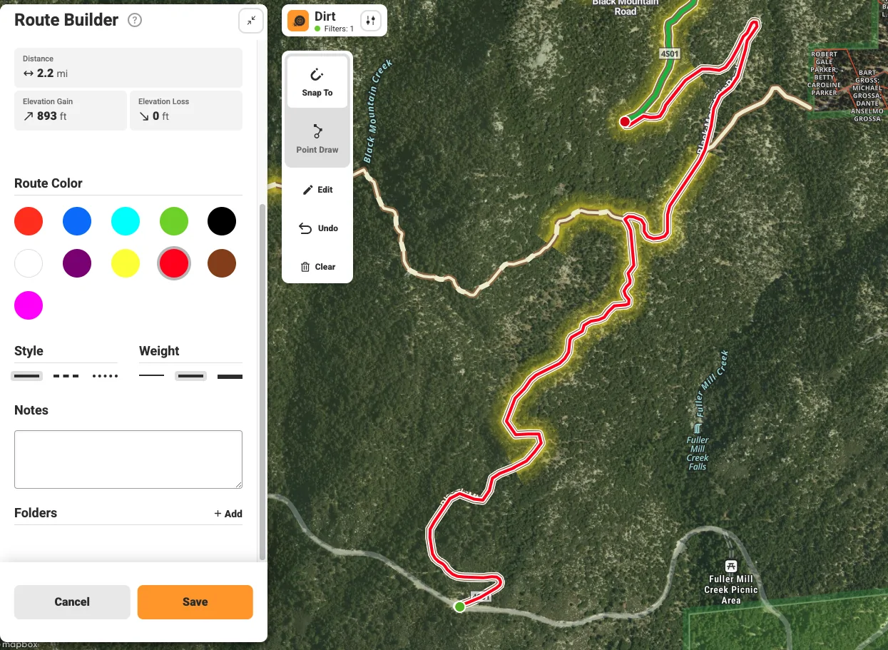

  • Duration: 10-15 mins into the drive, 2.2 miles on OnX, about 900 ft elevations change (map below)

I first noticed my temp issues on the Black Mountain trail outside of Idyllwild, CA. It was a hot day, about 95-100 when coming up the mountain roads, and about 85 when we reached dirt and got on the trail. This was the trucks 2nd time out for a quick overnight camping trip. It's first trip was the week before. I drove it up Coxey road on the back side of Big Bear CA, in even warmer temps, alternating between 2Hi and 4Hi, in D position, and did not experience this issue. Weird, but that trail has a bit less grade to it.
On Black Mountain, I had the truck in 2WD since the trail is quite easy. There is some grade to it and it slowly switch backs up the mountain. Only about 10-15 mins into the drive and 2.2 miles according to OnX, the trans temp display in my gauge cluster was getting very close to the redline, prob about an 8th of an inch away from redline on the gauge. By referencing the TFL video above, I would estimate I was around about 260-270 degrees at that time. I pulled over and let it cool for about 5-10 mins. That location is the end point of the red line on the map below.
When we resumed the trail still in 2WD, the temps quickly rose back to that same position, and it felt as if the gears were slipping a a bit, so I pulled over again to cool. As we resumed again, I shifted to 4WD and left it in the D position, although slightly better, the temps rose quickly again so we pulled over. Finally as we neared the first group of yellow post sites of that trail, I figured out that if I had it in 4Hi and kept in mainly in S1 and S2 as needed, the temps would stay in check and not rise further. Since the trans was already hot, I was never able to get the temps back to the center position under the gear icon in the cluster, but I was able to keep them from rising further as we made our way to the end of the trail and camp. Coming down the mountain the next day, I did not have any issues.
