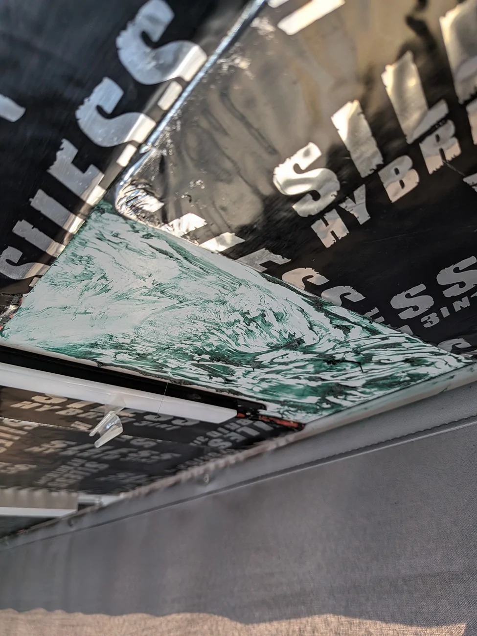

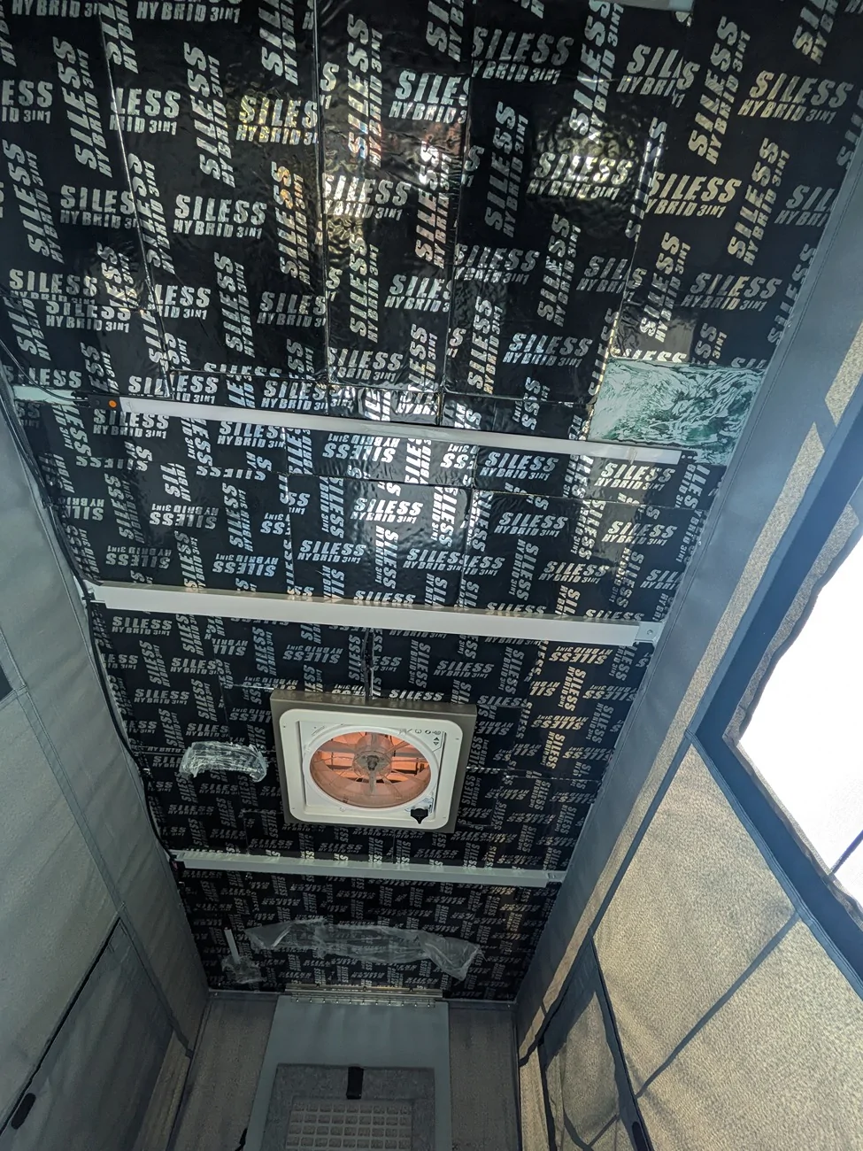

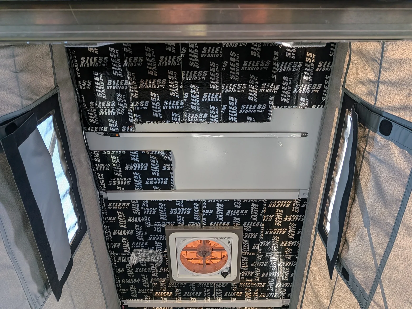

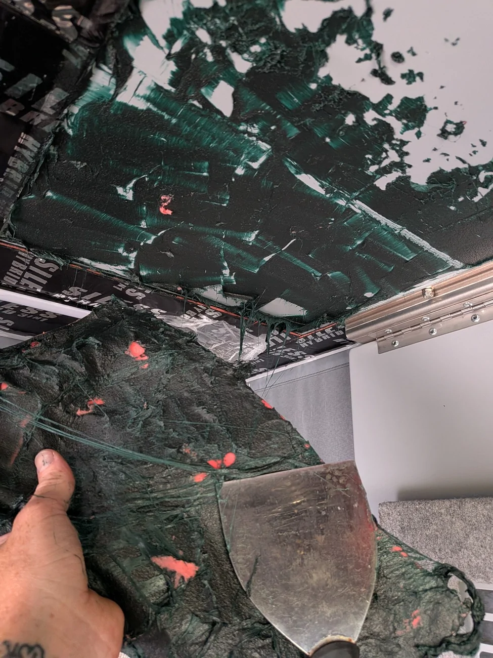

I bought my Topo Toppers Badlander second hand. The owner was in a cooler climate and decided to "insulate" the top of the interior with Siless 3 in 1.
Two problems:
1. It doesn't really insulate and I want to replace with a light weight and effective insulation.
2. The butyl from the backside of the siless is pushing out when the topper is closed now that it's warmer and smashing cheap green butyl into my tent fabric and bedding.
So it has to go.
Any ideas ? Rubbing alcohol does nothing. Read about dry ice, so that would be my next course of action, but you guys usually have some slick ideas.
Took me 30 min to do this terrible job on one square with a plastic scraper and alcohol, so that's out.

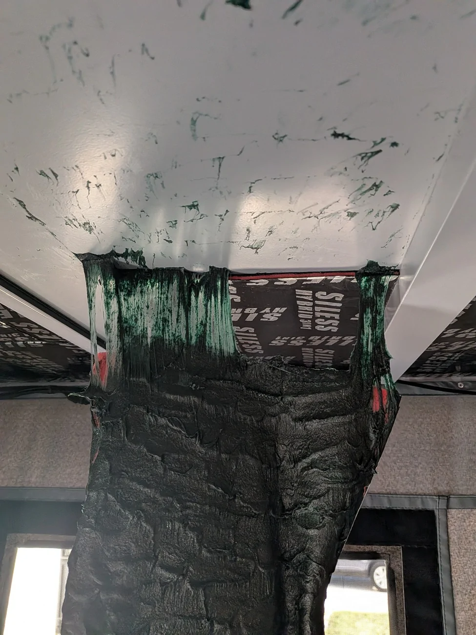

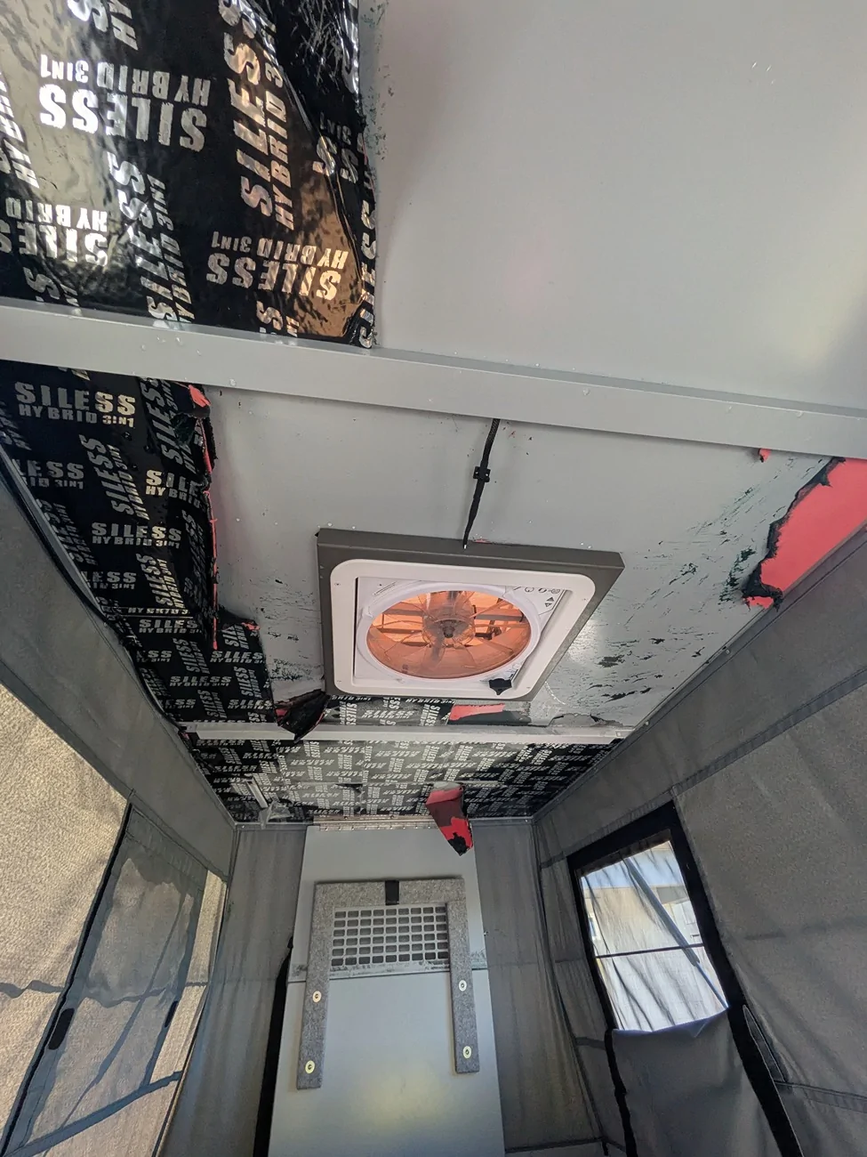

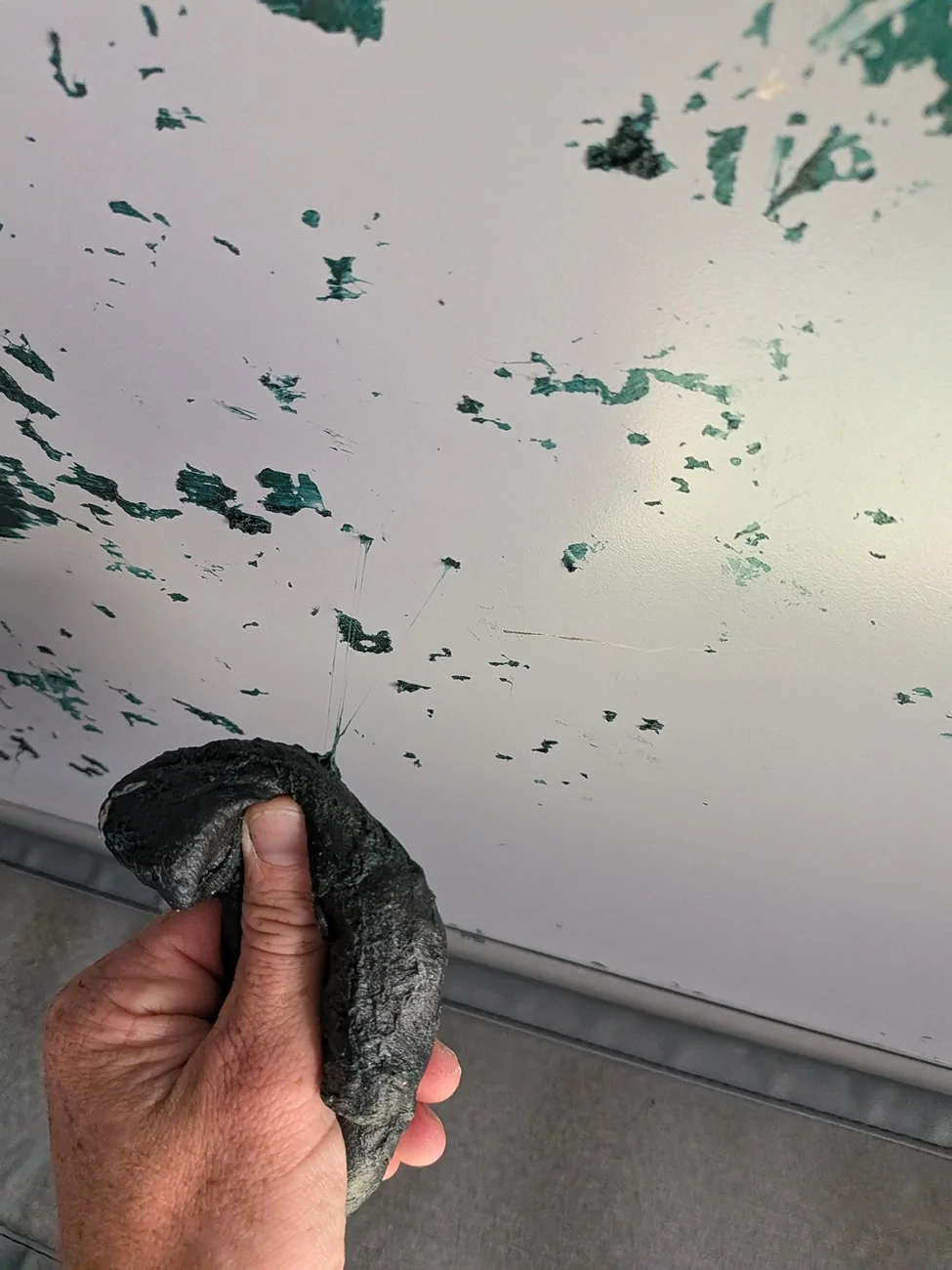

Alright, so dry ice was a good thought in theory, but didn't work well here. This siless 3 in 1 has a very then layer of adhesive butyl, then a thin layer of foam, then another thin layer of butyl, then a cover film. The bottom layer was so thin I wasn't able to get any large chunks off after freezing. It was very tedious just chipping away at it.
I ended up letting it heat back up in the sun, then scraped each square off with as much butyl as possible, then rolled some higher quality butyl into big balls and just dabbed the remaining/left over butyl on the ceiling until I got it all off. It was very time consuming! Now I just have a little bit of cleanup left.
I would suggest you never use this garbage. It was a good thought by the previous owner for easy insulation, but it didn't insulate much and as soon as it got hot the butyl turned to goop and started oozing out onto the tent fabric.
Anyways, appreciate you all and all of your ideas. This was a pain in the ass.
