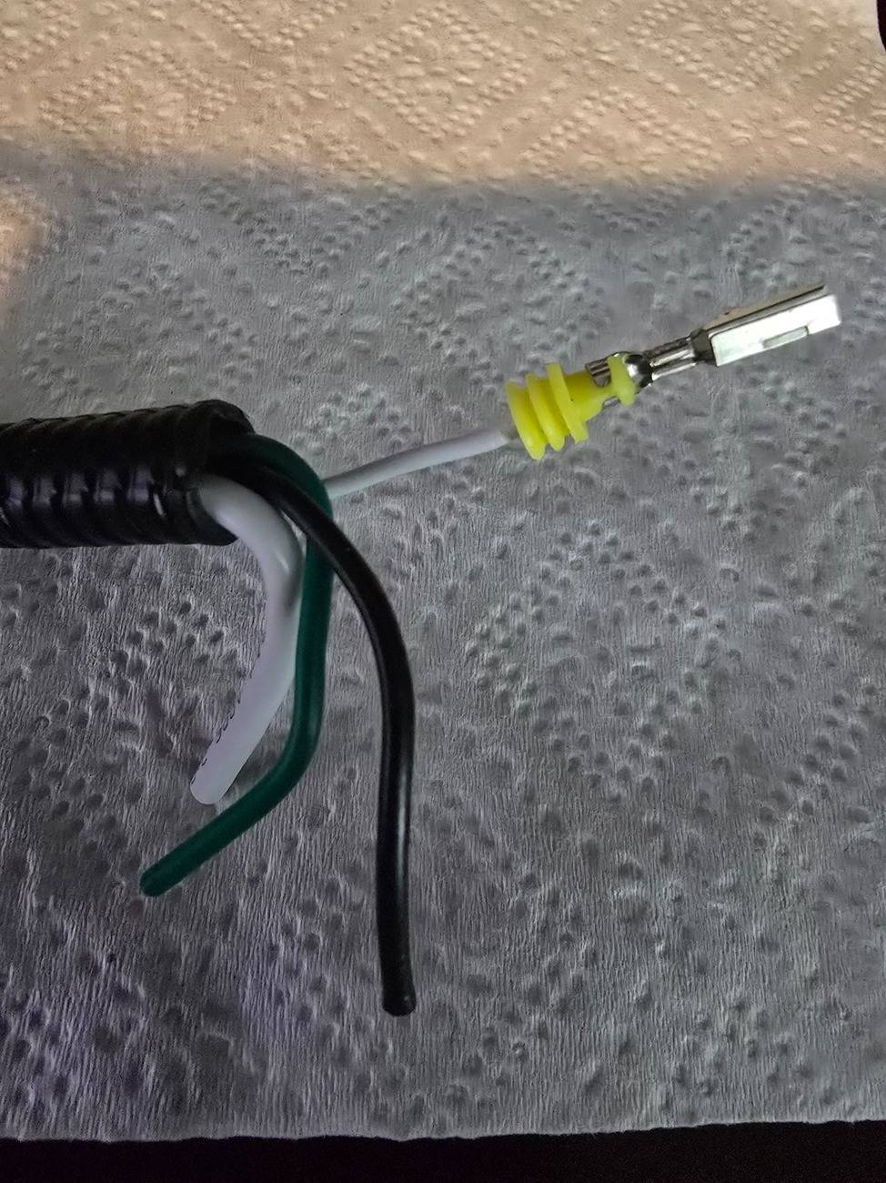

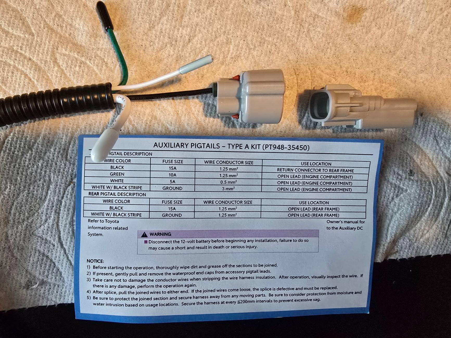

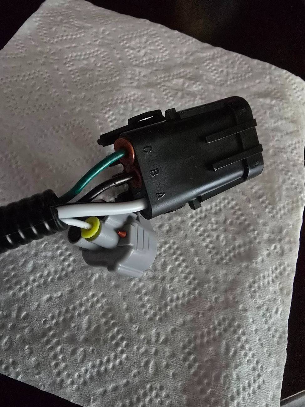

Project still in the works, but I did finish the Toyota pigtail jumper.
This is the original Toyota Jumper.
2024 Tacoma HOW TO: Rigid SR-L Series Lights for ARB Rear Bumper Installation 20250422_182221

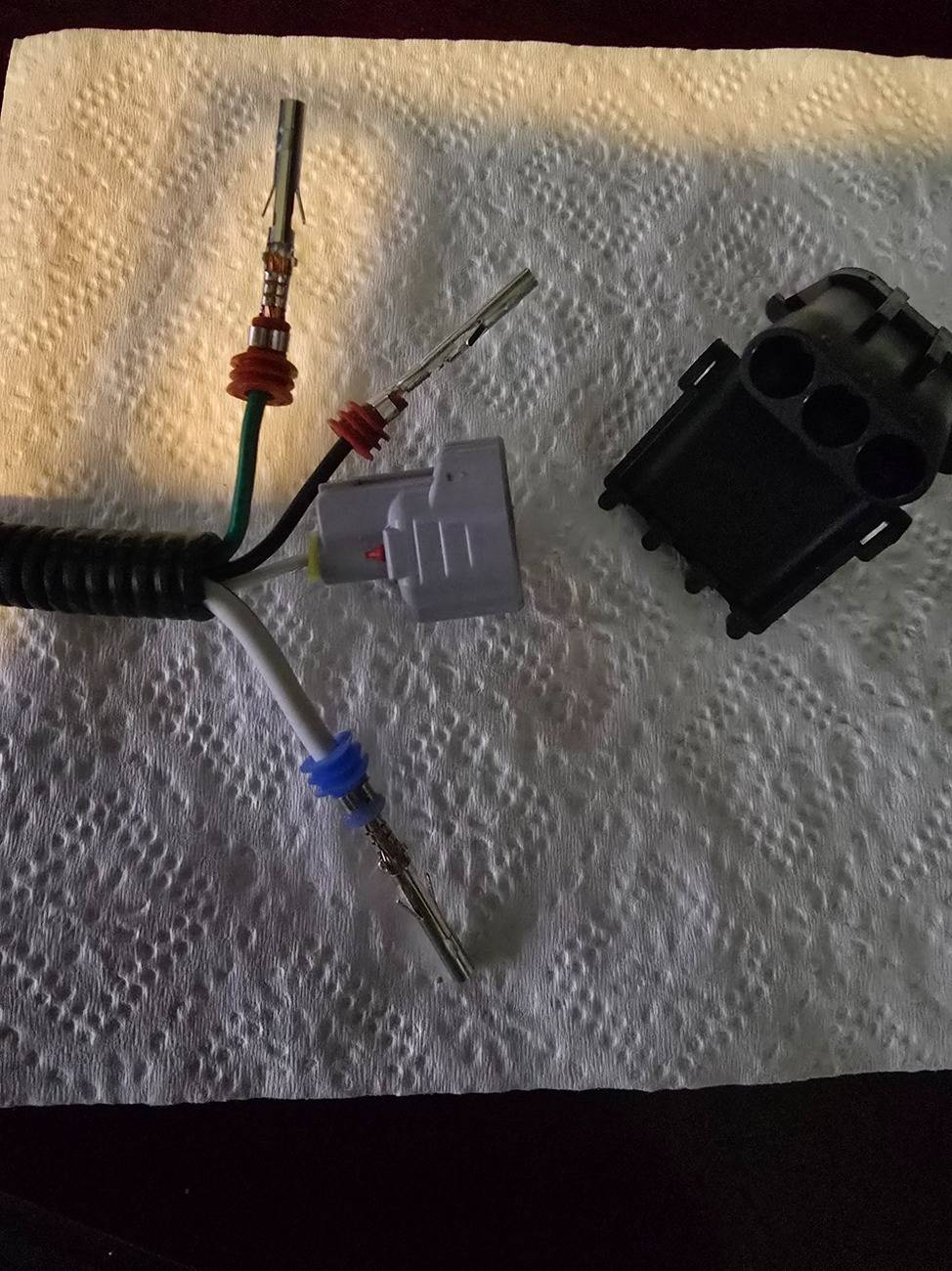

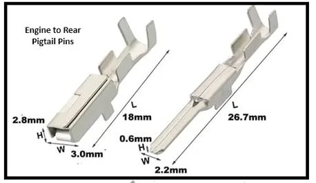

Unpinned the Black wire (AUX1) and pinned the White wire (AUX3) using a similar pin as used in the Toyota harness.
2024 Tacoma HOW TO: Rigid SR-L Series Lights for ARB Rear Bumper Installation 20250512_164500
I believe this pin is a 621-2-2A
2024 Tacoma HOW TO: Rigid SR-L Series Lights for ARB Rear Bumper Installation 1747291604442-dd
Using my own 3 pin waterproof female connector, I crimped the pins on AUX1, AUX2, and Ground.
2024 Tacoma HOW TO: Rigid SR-L Series Lights for ARB Rear Bumper Installation 20250512_173151
Here is how it looks when finished. I will build a male 3 wire pigtail jumper for future potential use if or when needed and tuck it away. I have no plans for use right now since I will be using my Auxbeam RGB 6 Gang Switch for most of my lighting project which includes ditch pod lights, fang lights, grill DRL lights, and a hood scoop light.
2024 Tacoma HOW TO: Rigid SR-L Series Lights for ARB Rear Bumper Installation 20250512_173847

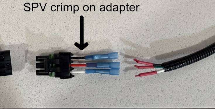

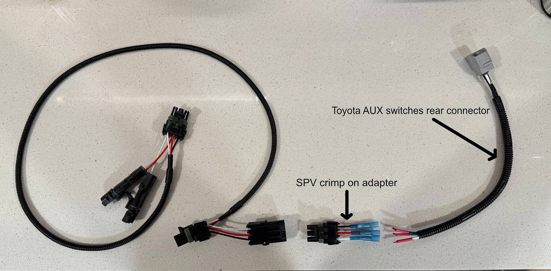

I just finished installing the kit from SPV on my 2025 Truck and just wanted to add some useful information I received from them. As you can see from the pictures there are 3 wires coming from the Toyota supplied rear harness and 3 on the SPV adapter. White/black being the ground, green 10A, and black 15A on the Toyota wires. On the SPV adapter, black is ground, red is for the backup lights and (ironically) white is for the red halos. I didn't want to be able to turn the halos on with one of the AUX switches, so I did not connect it. You can turn them on with the parking lights, so it seemed redundant to waste an AUX switch for them. I connected the green 10A wire from the Toyota harness to the red SPV wire, and the backup lights turn on with the AUX 4 switch. Hope this helps anyone with a 2025.

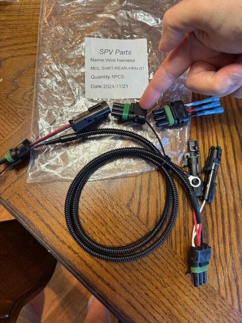

My 2025 TRD Pro Toyota supplied harness/pigtail has 4 wires, not 3. It also has a white wire (10 amp) which must just be another aux switch inside the cab.
My SPV short harness also has a 3-pole female plugged into the 3-pole male plug that the improvised/interim male plug is to plug into. The female plug has the ground wire attached. Is this not needed now since the Toyota supplied harness has the white/black ground wire?

Yes, you are correct. You can remove the plug with the single black wire as it is not needed for your setup. That single black wire threw me off when I was wiring mine up too.

Yep, that was confusing, and I should have added that to my post. You don't need the single black wire if you are connecting to the aux switches.
