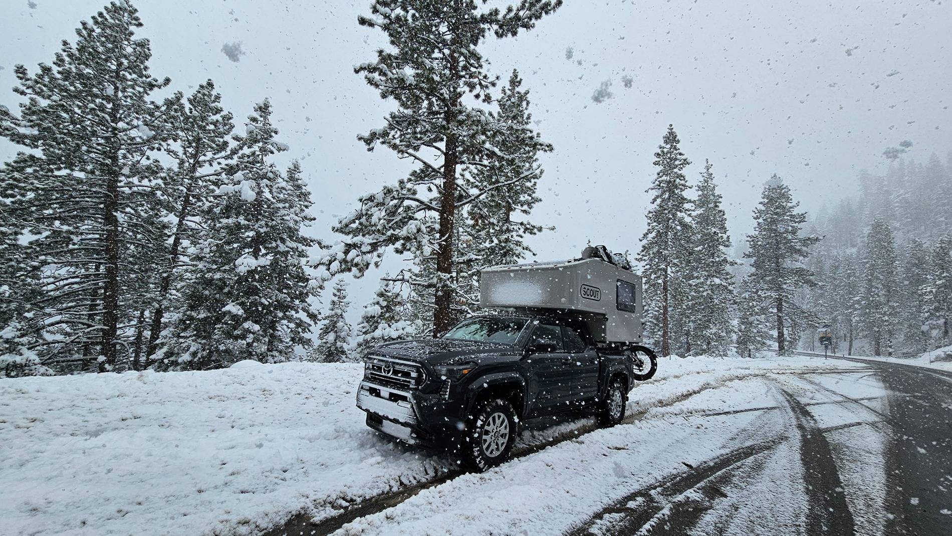

I recommend swapping out bump stops to Timbrens when towing. It drives amazingly. The bounce is usually the tires. You need to switch to LOAD E tires. I run my tires at 65 or 70 psi, depending on load. Thats the bounce you feel. I run duratrac , swapped after 200 miles from OE.
I rent my truck / camper combo at times and everyone is always surprised how great it drives but its simply prepped for it. BTW, the bumpstops take 30 min to swap out . I use them and take them out after my trips. With out load, they are a nightmare lol.

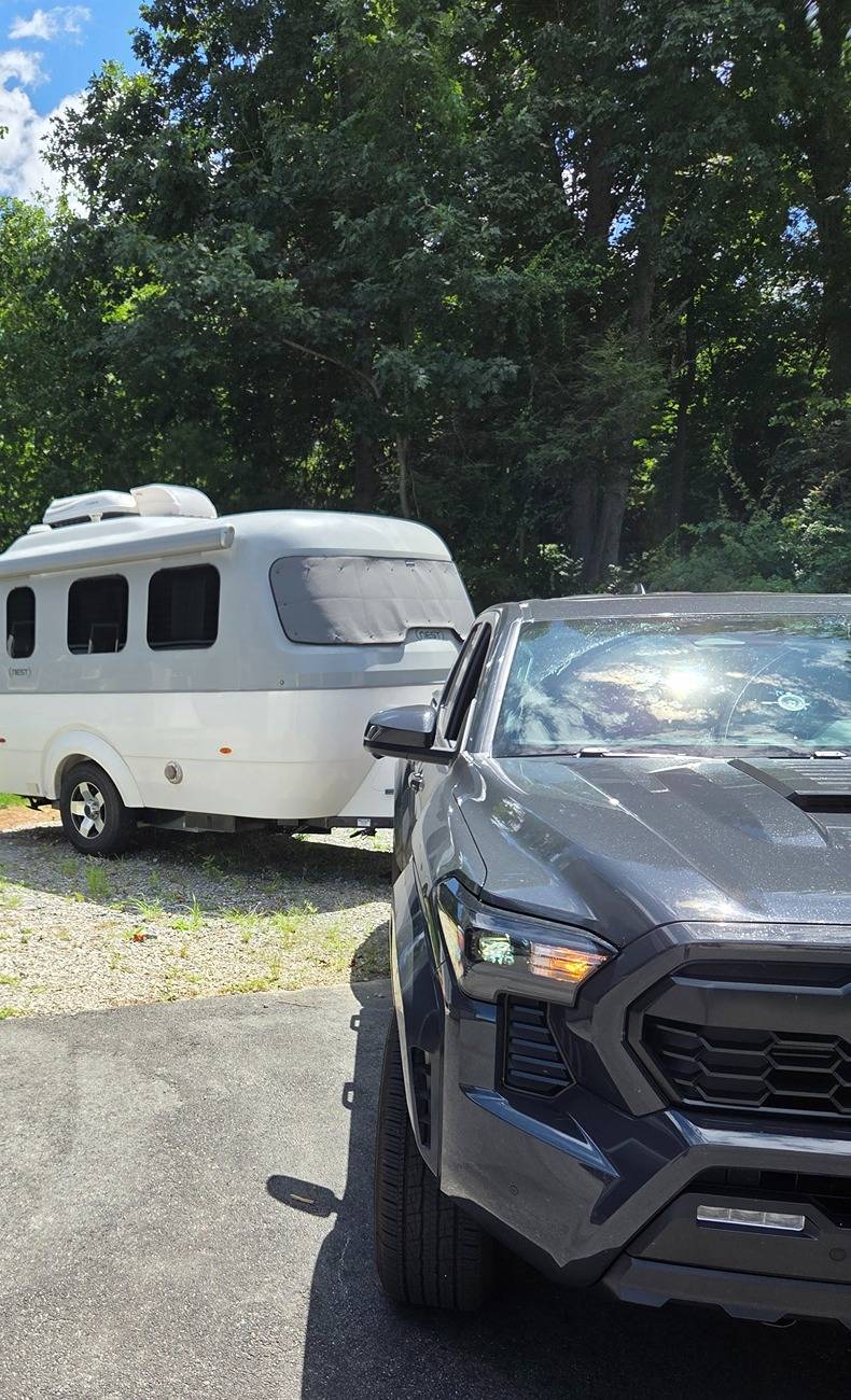

Just completed a trip to Maine from northeast CT. 170 miles each way and maintained 16.2mpg. Usual average mileage is 21mpg. Very Happy with the mpg on the trip. Pulled an Airstream Nest with 370 lb. tongue weight. and weighs in around 3500 lbs empty. I previously owned a Ram 2500 gasser and pulled a 8K lb 5th wheel. Average mileage was around 10.
