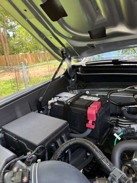

Yesterday I installed Redline Tuning hood struts. This was an easy install and the instructions were great.

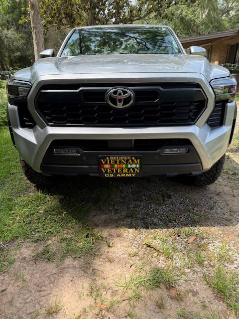

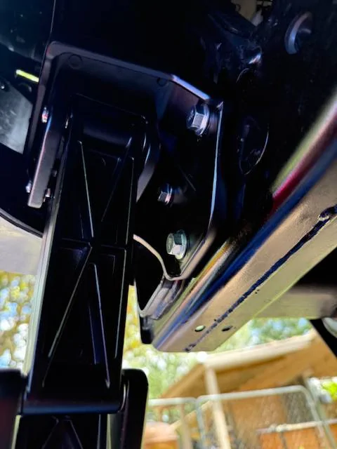

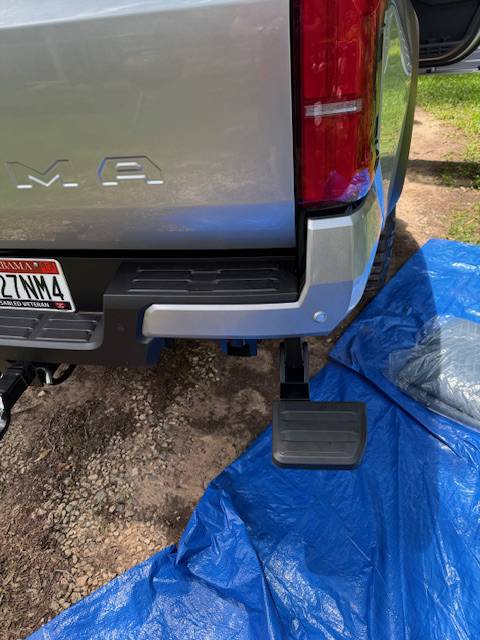

Today I installed the bed step $95 from Amazon. This install gave me problems. I followed the advice from a previous poster about running a bolt through the holes before installing the step to clean the paint out of the holes, and this worked to an extent. I managed to bugger up 2 holes a bit and messed up the treads on 2 of the bolts. I fixed the problem by running a 10mm x 1.5 tap through the holes and the same size die to clean the threads on the bolts. I used WD-40 throughout the entire process to lube the bolts and holes and they still got buggered on the 1st try. If you do add a step, I recommend running a tap through the holes first. you can get one at Lowe's for about $9 if you don't have one. You have to use a box or open end wrench to tighten the bolts as there isn't enough room to use a ratchet. I don't think a ratchet wrench would fit either, but I didn't have a 14 mm one to try. The last thing I did today was add my Retired Army tag holder and Vietnam Vet tag to the front of the truck.

I'm guessing you'll be very happy w/ the hood struts and bed step---- I have both and consider them to be really worthwhile adds. Great looking truck and thank you for your service:flag:

Thank you for your service. Good looking plate

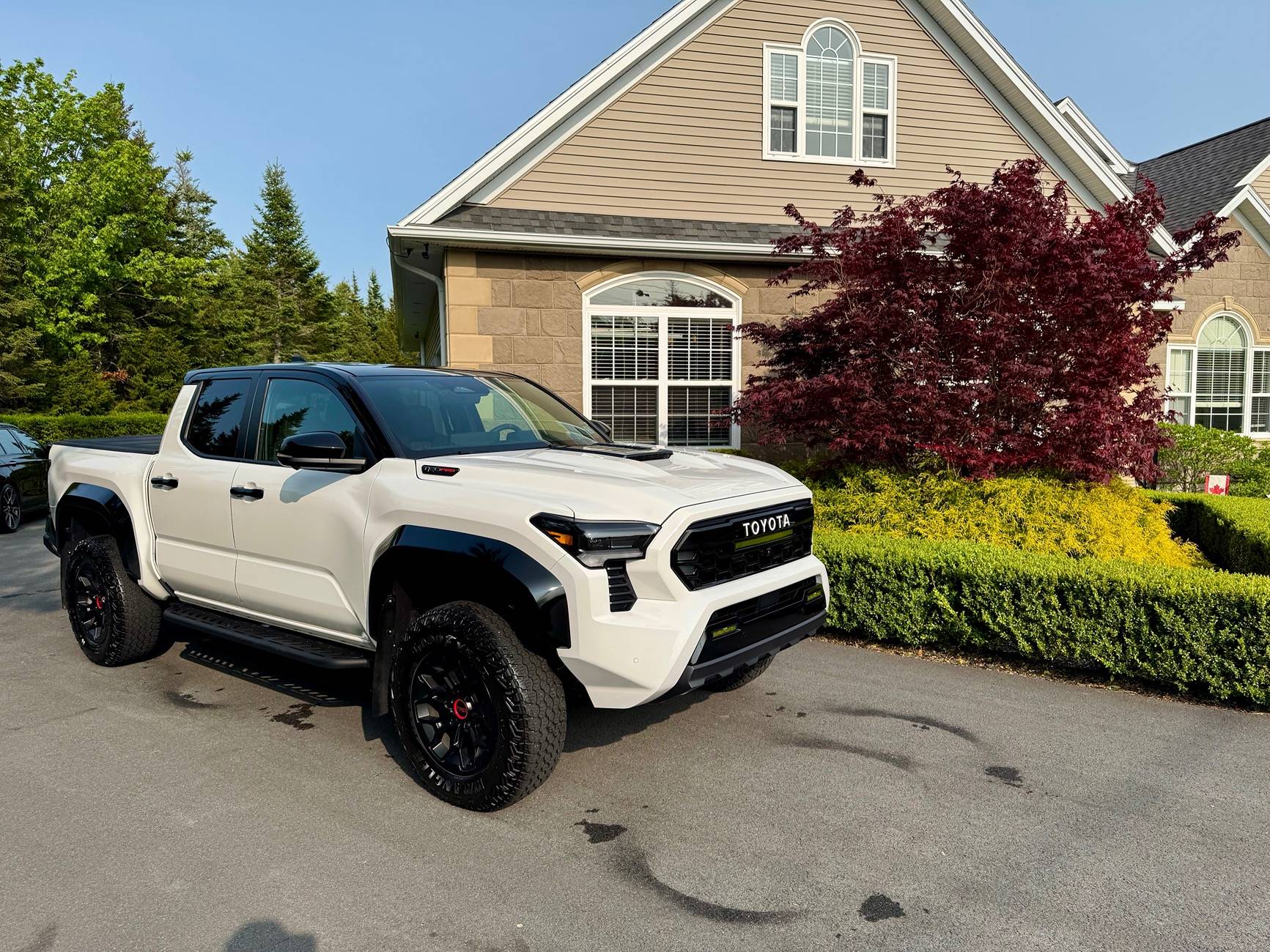

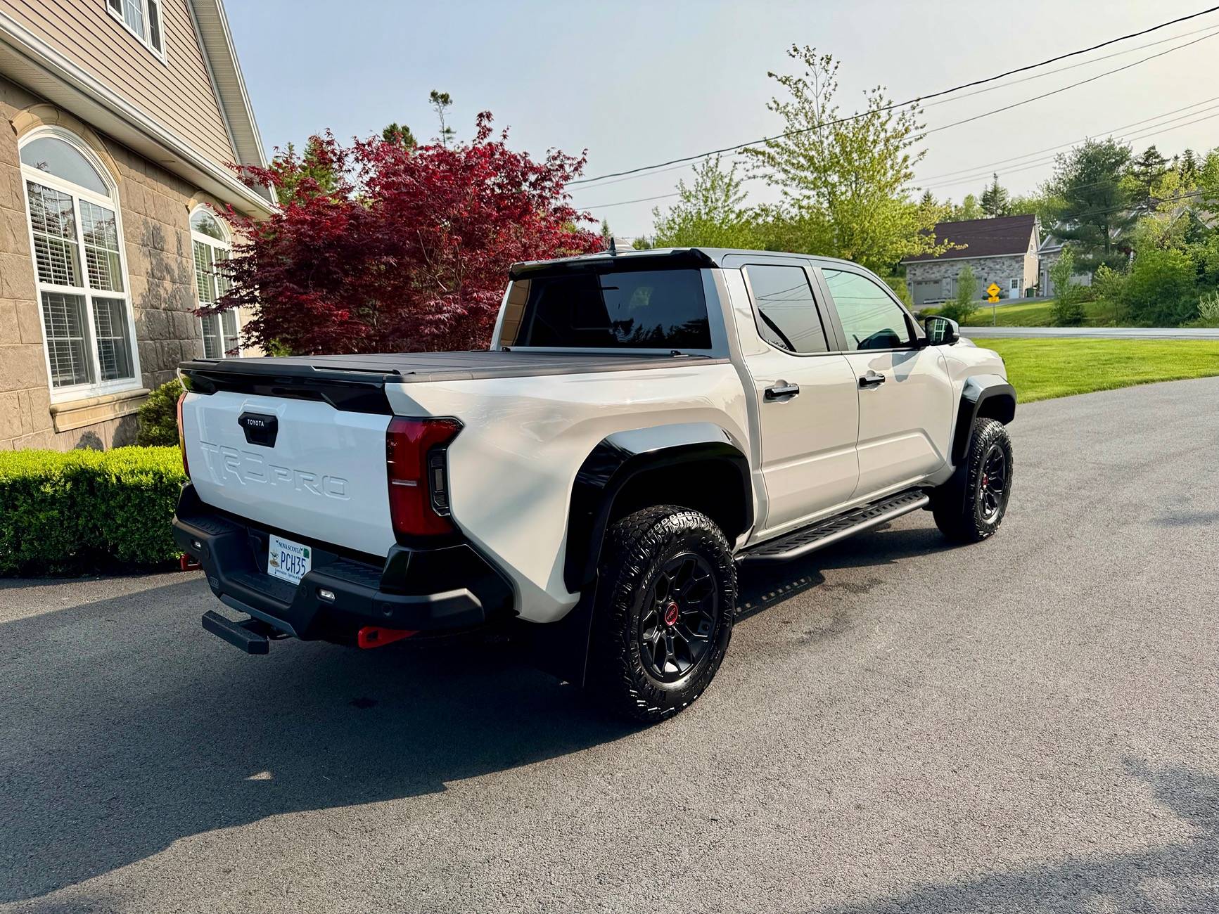

I did my second oil change, and first tire rotation, I can’t be the only pro owner considering removing the rubber bump stop in the rear because I have the fox bump stops?

Don’t do that. That’s not a bump stop, it’s a remote reservoir that holds shock fluid

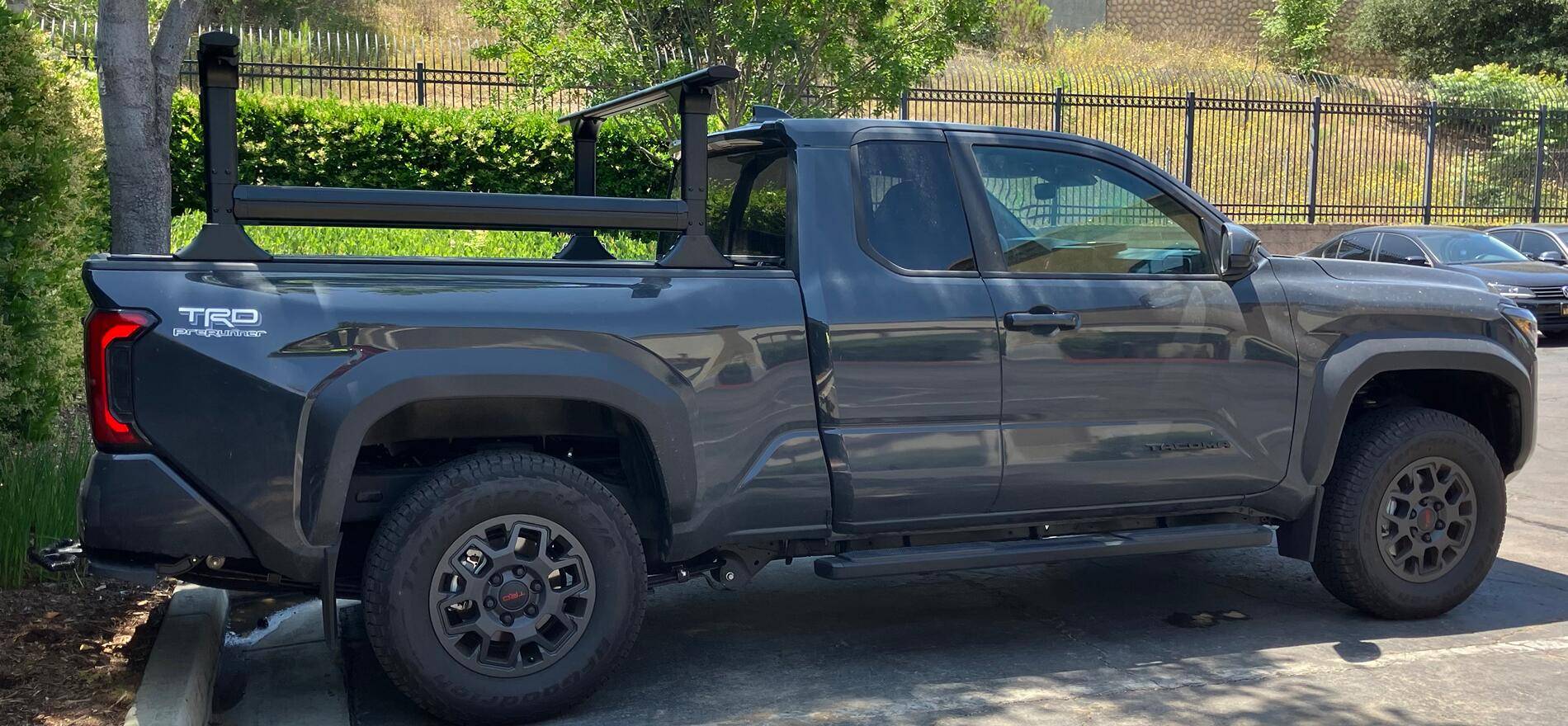

A week after trading in my 24 Trailhunter for a New 25 TRD PRO, I decided to install the Sport Bar on the TRD. I really like the look of the Sport bar, gives the Tacoma that Marty Mcfly vibe IMO.

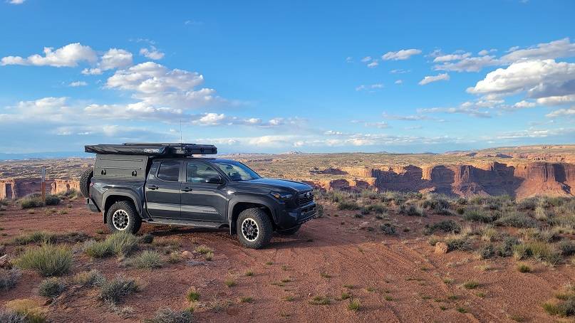

Today I had a successful crossing of Medano Pass from Great Sand Dunes NP west to east on Medano Primitive Road to CO SR 69 in the Trailhunter which performed flawlessly. That is what the Trailhunter was made to do.
