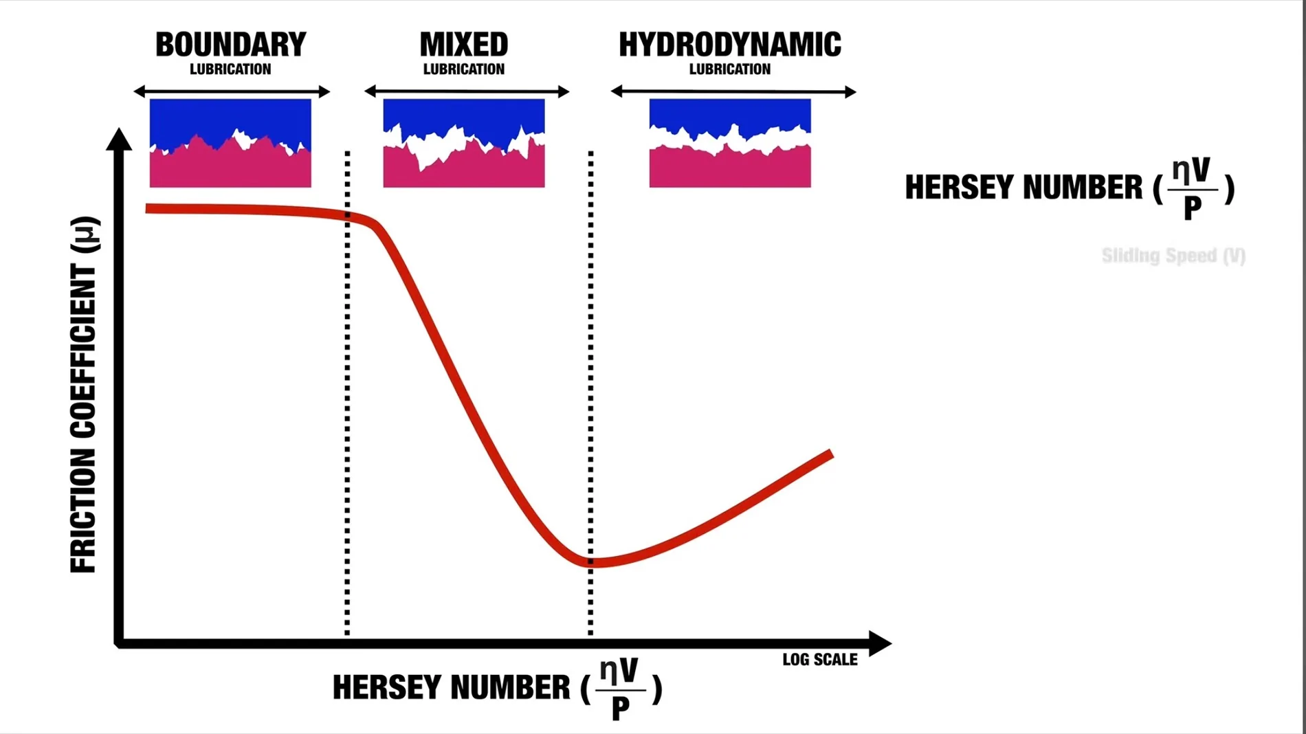

I love a car care nut video as much as the next guy, but the oil viscosity video is really meant as a basics/intro. Engineering Explained did a good video explaining oil viscosities during the GM 6.2L mess:
Great explanation of Stribeck curves
(that I vaguely remember from engineering school).
2024 Tacoma 5w-30 IMG_6408
Long video short, engine bearing clearances, operating speeds, and oil viscosities are engineered to put you at the optimum point on the friction curve. This gets both the best fuel economy and the least bearing wear. Changing the Hersey number (by, for example, changing the oil viscosity) moves your position on the friction curve out of the “optimal zone” it was engineered for. Moving further right into the hydrodynamic zone sounds like you would be improving engine life, but you would actually be slightly increasing the friction coefficient. That generate more heat, the enemy of engine longevity.
In GM’s case, they recommended changing the oil viscosity because the parts GM’s suppliers machined didn’t actually match what the engineers designed, putting the engines further left on the curve into the mixed zone.
I’ll stick to Toyota’s recommendation for viscosity. I’m still not gonna run the oil to the recommended 10k interval. Changing it at 5 (or sooner) risks nothing but a few dollars and some time in the garage.
