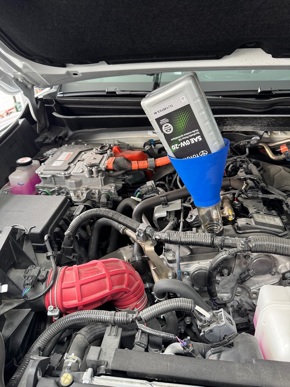

Haven’t done much since getting back from Vancouver, were banned from hiking or entering the woods at all, but I did my 3rd oil change and tried out a new funnel and I really like it

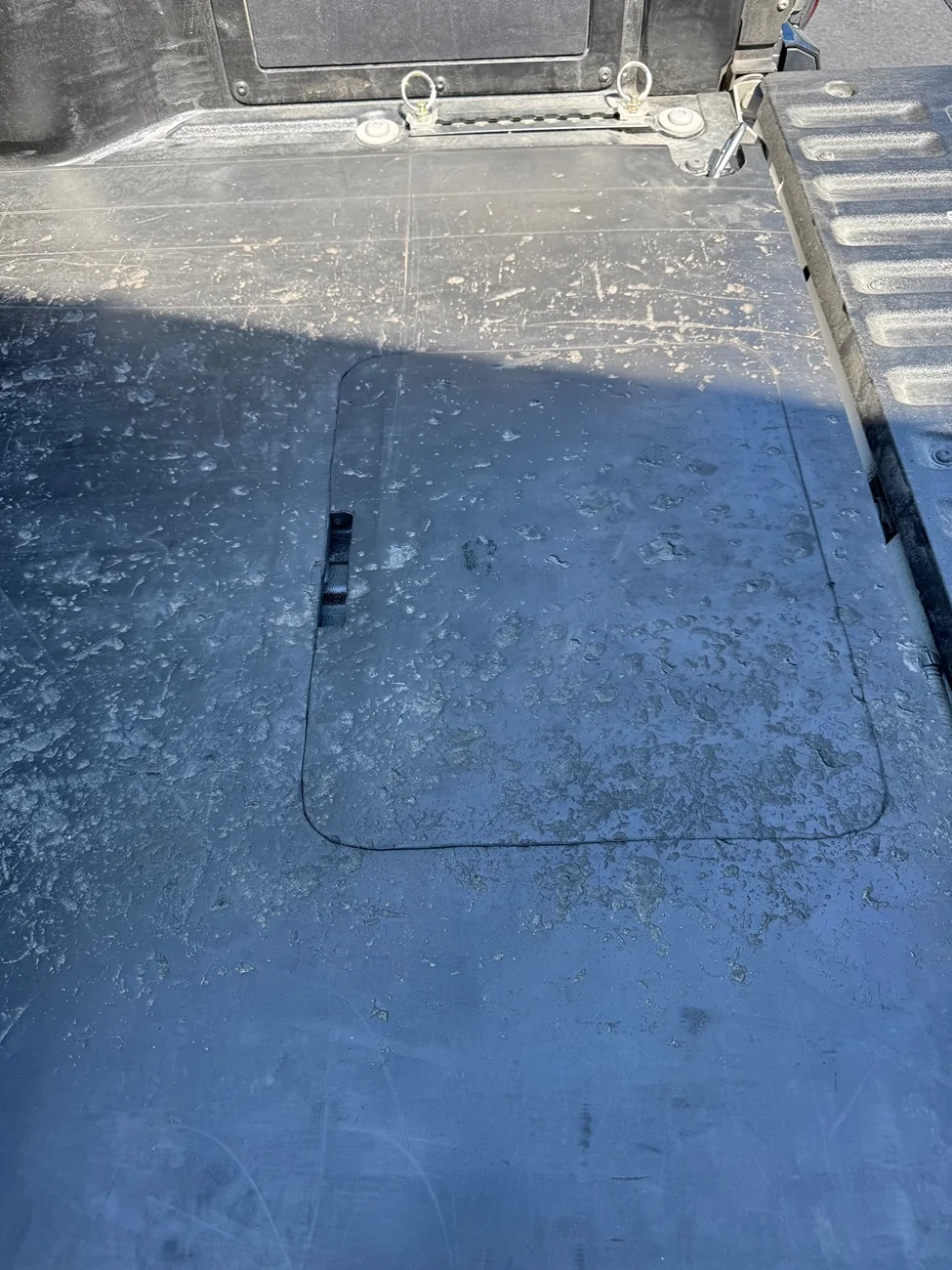

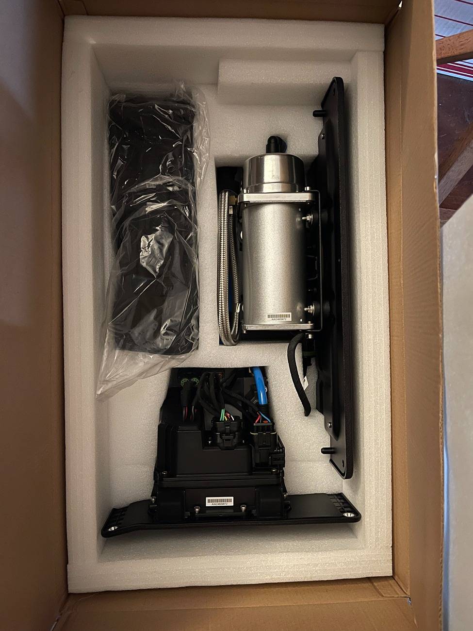

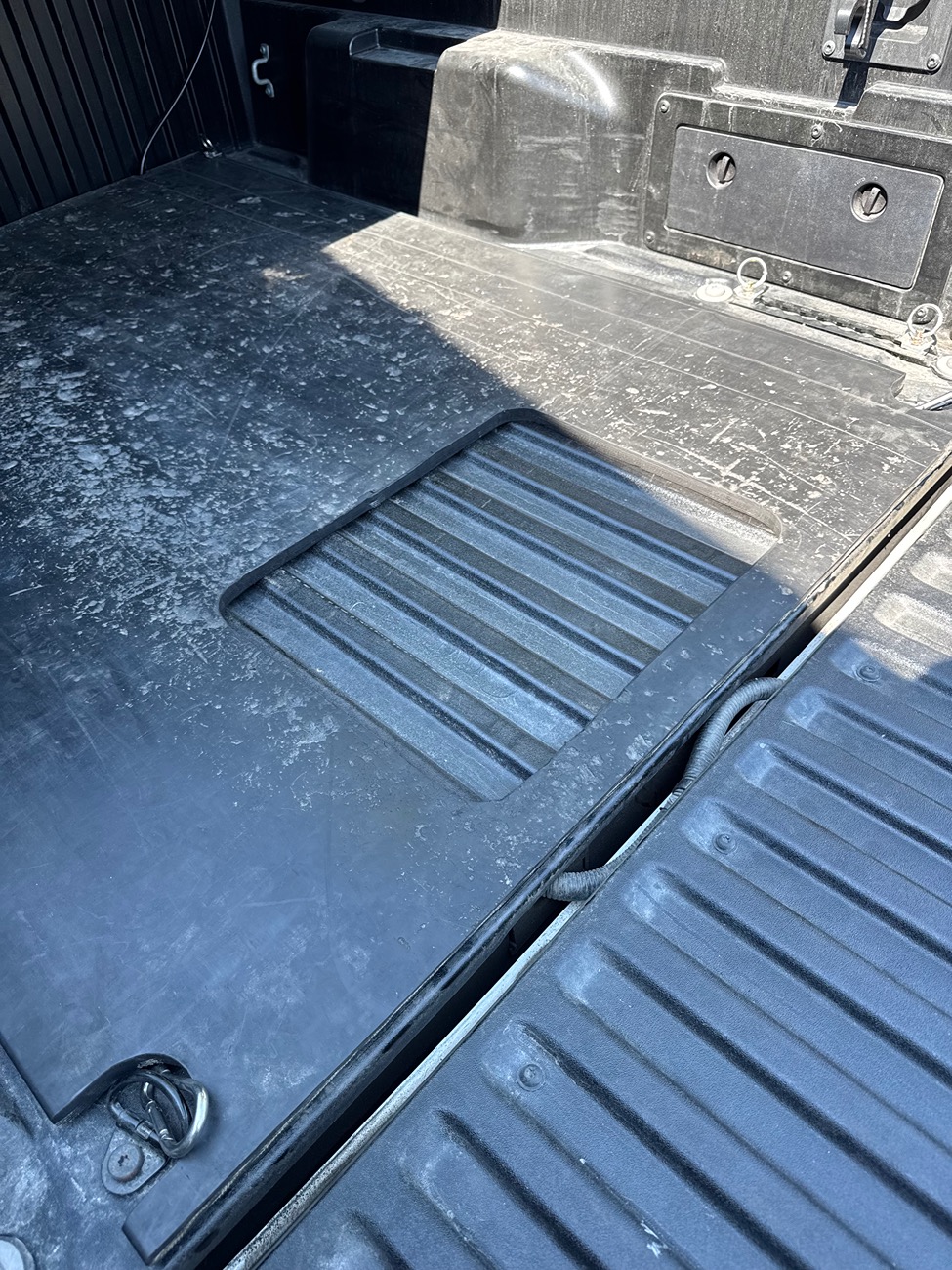

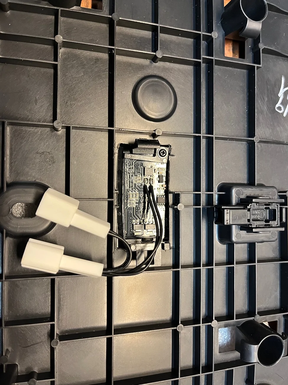

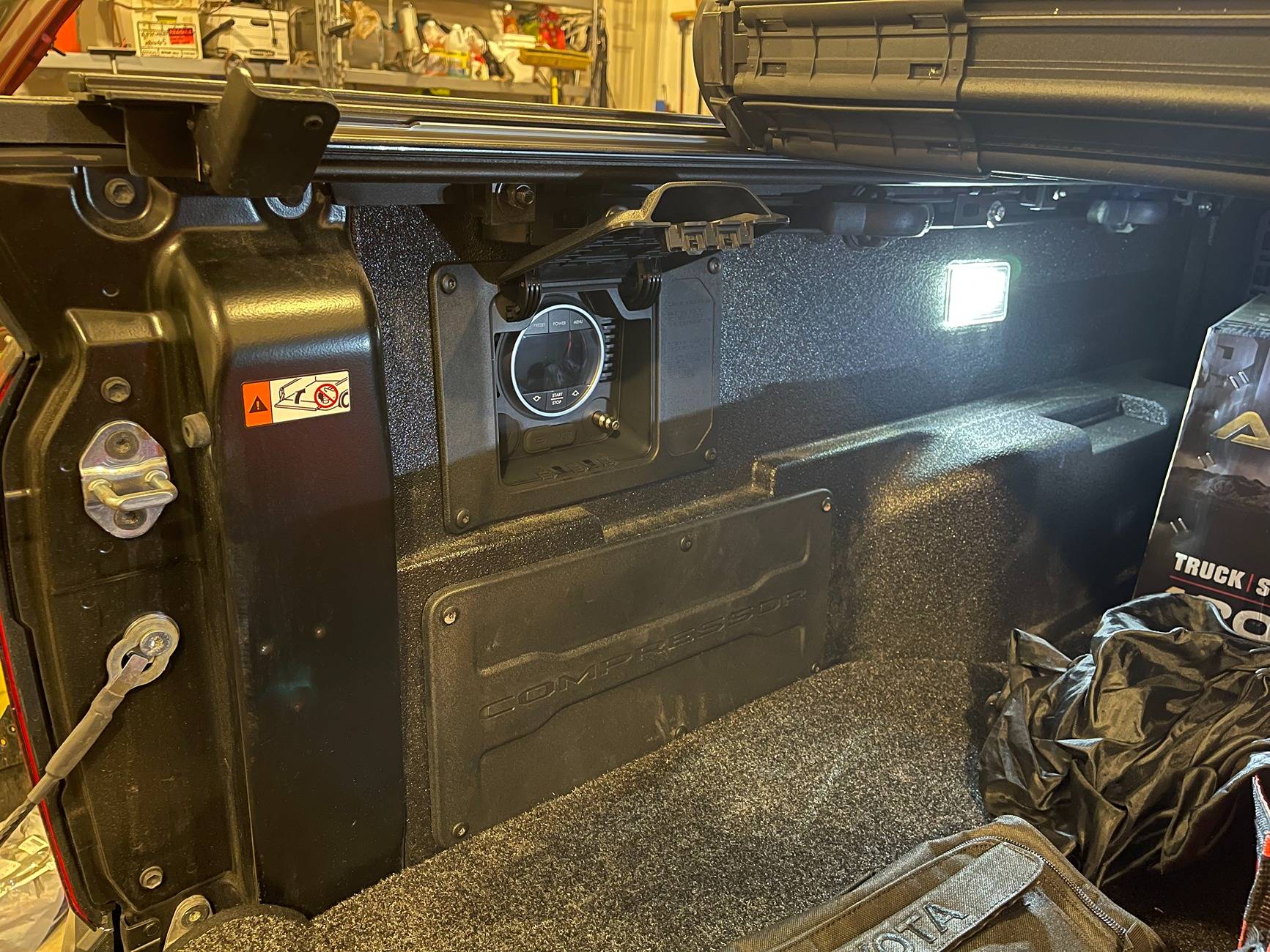

How was the install?
Due to the wiring already there for it, it's gotta be one of the easiest ways to have on board, out of the way, inflation. The worst part is cutting the bed correctly, then maybe the rivnuts, but take your time and use a template for the cutting. Bonus, it's got a nifty feature that your selected inflation pressure, once it auto shuts off on one tire, all you have to do is unchuck, and re-chuck the next tire, and the inflator automagicly starts filling the next tire.

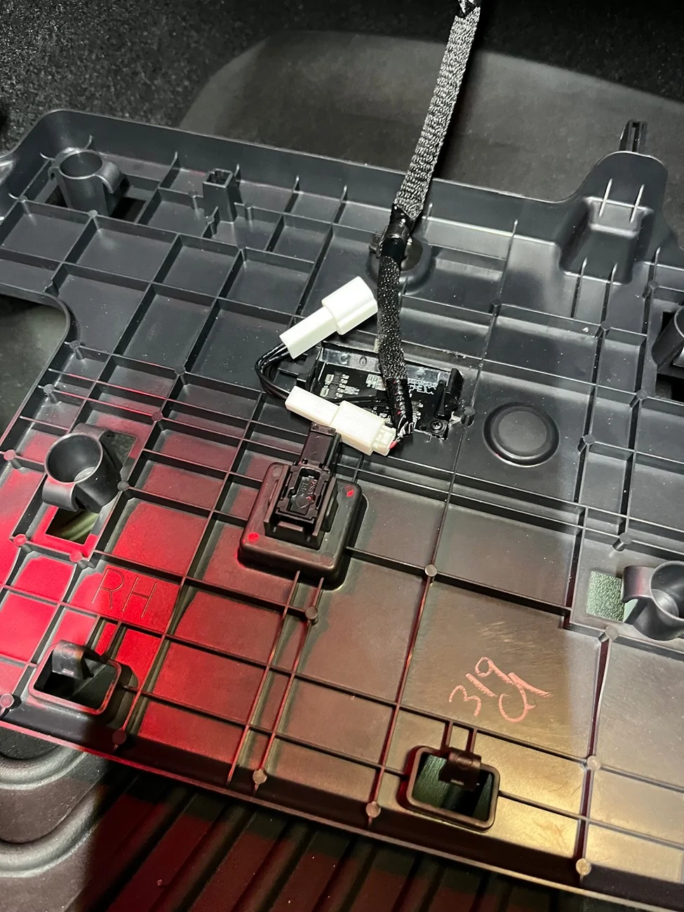

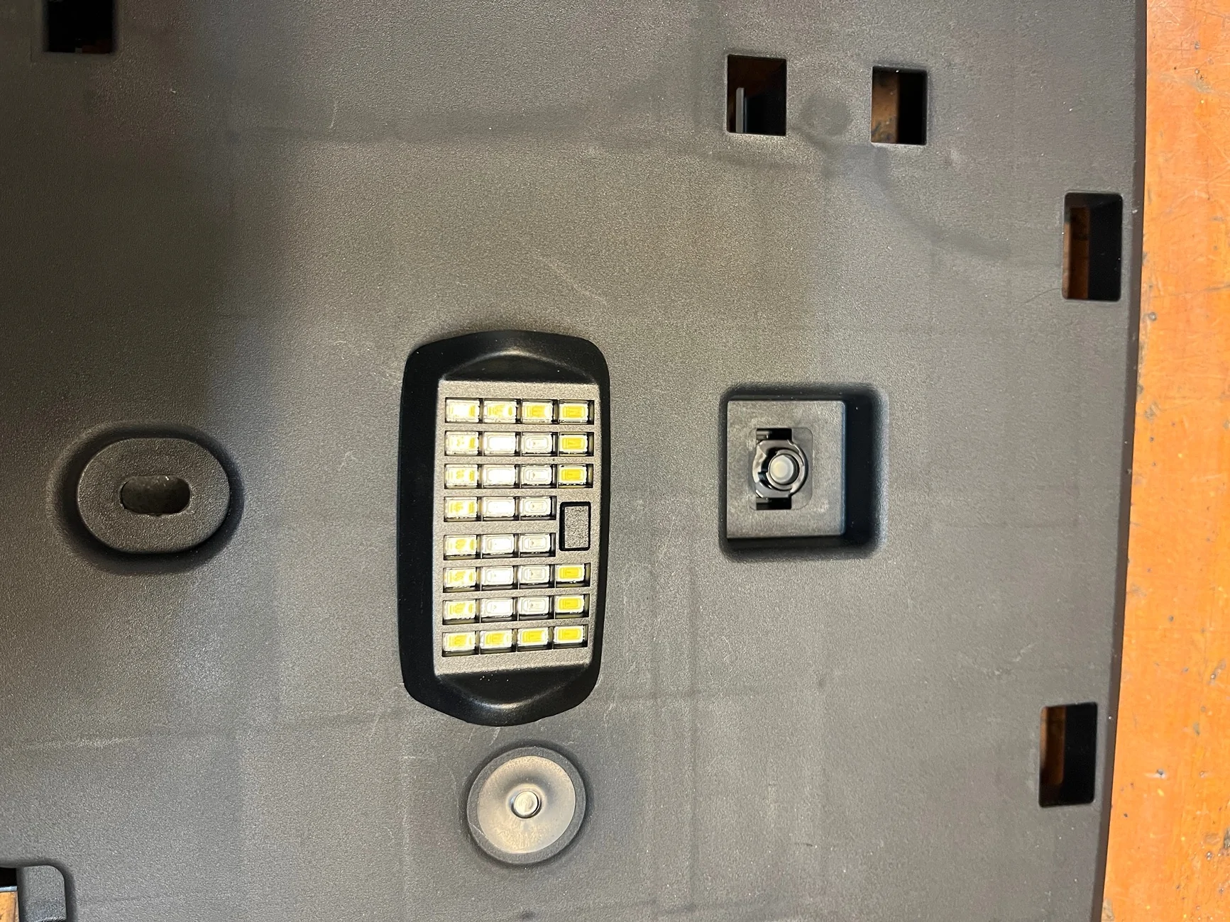

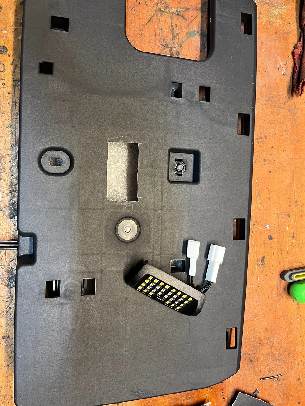

I was trying to figure out how to use the 2 extra MESO door lights that you get for our gen 4 tacos..so I removed the plastic pieces that are over our feet under dash. Didn’t take any pictures of the drivers side but the passenger side worked just the same. The plugs on the MESO lights are the same in the doors as they are under our dash that powers the little 1 watt bulb. I just cut some rectangular holes in the plastic pieces and the meso light just snapped right in" took all of about 30 minutes. So now I have nice and bright footwell lights. They all work just like the rest of the MESO lights that I have. All come on and dim with the rest of them

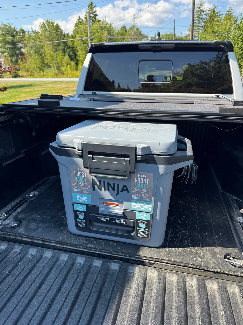

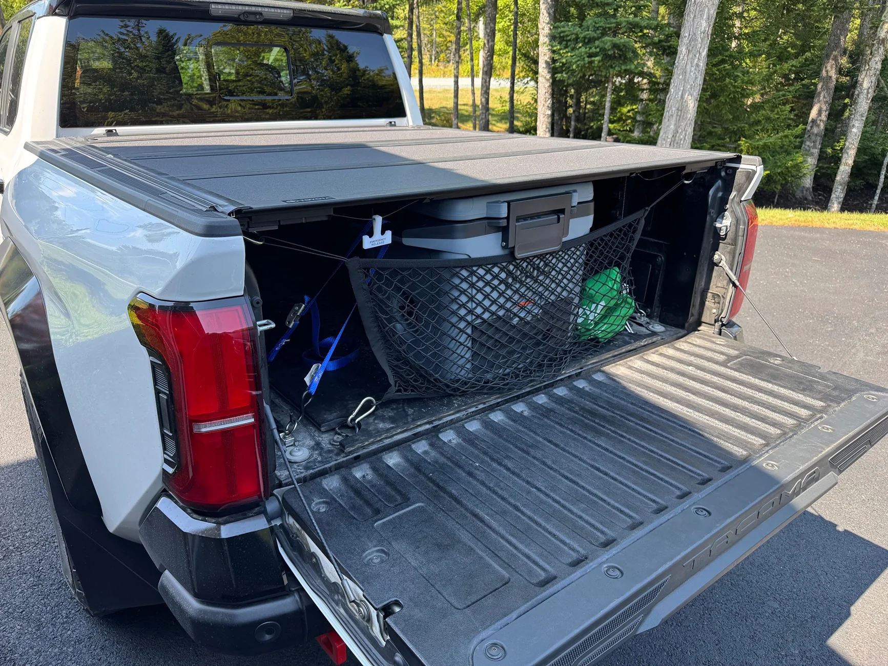

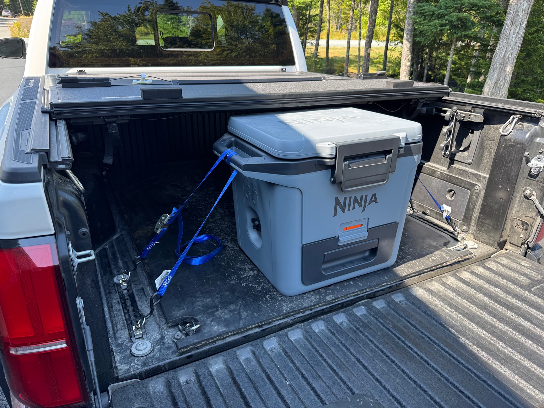

Bought a new cooler for day trips and picnics, didn’t check if it would fit in my bed, however I have a 3/4” thick conveyor belt bed mat so I just made a template of the bottom of the cooler and cut it out, now it fits perfectly, can’t move side to side and it’s strapped down with my VersaTrax perfect setup
I also cleaned it but it’s not very noticeable

Awesome use of the 2 extra lights! I'm gonna have to steal this idea. :fistbump:

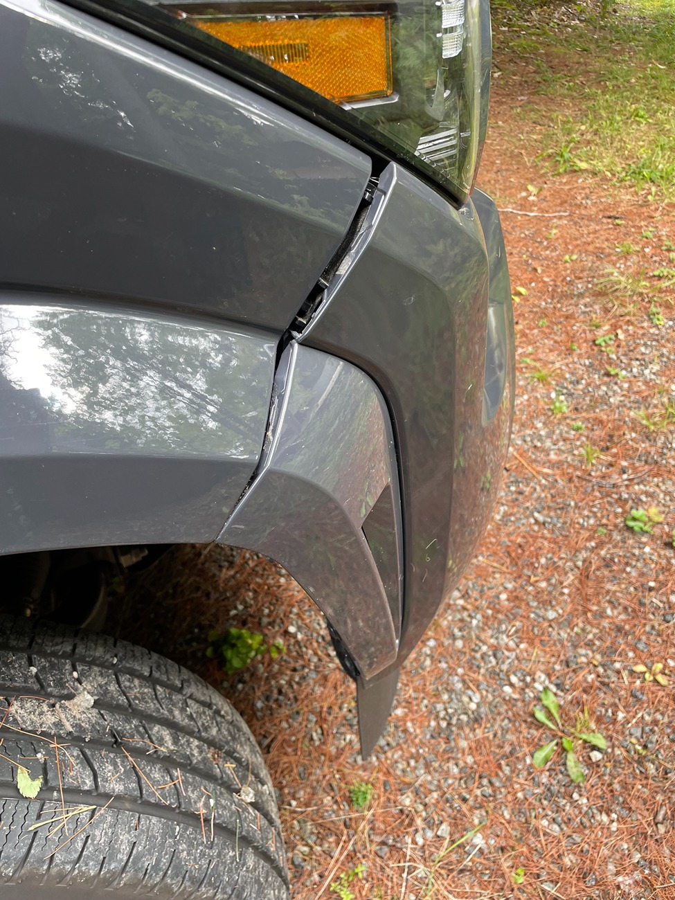

Partially removed and reinstalled my front bumper cover this afternoon after hitting a small deer Friday night in upstate NY. Took about an hour to remove the bolts & clips and figure out the assembly method. Got lucky, one alignment tab on the bumper cover had a slight non-structural crack that's not visible. Looks like new again.
On the bright side, got 28 mpg up and back.

Your lucky that’s the only damage you have.could have been a destroyed front end. Glad your alright
