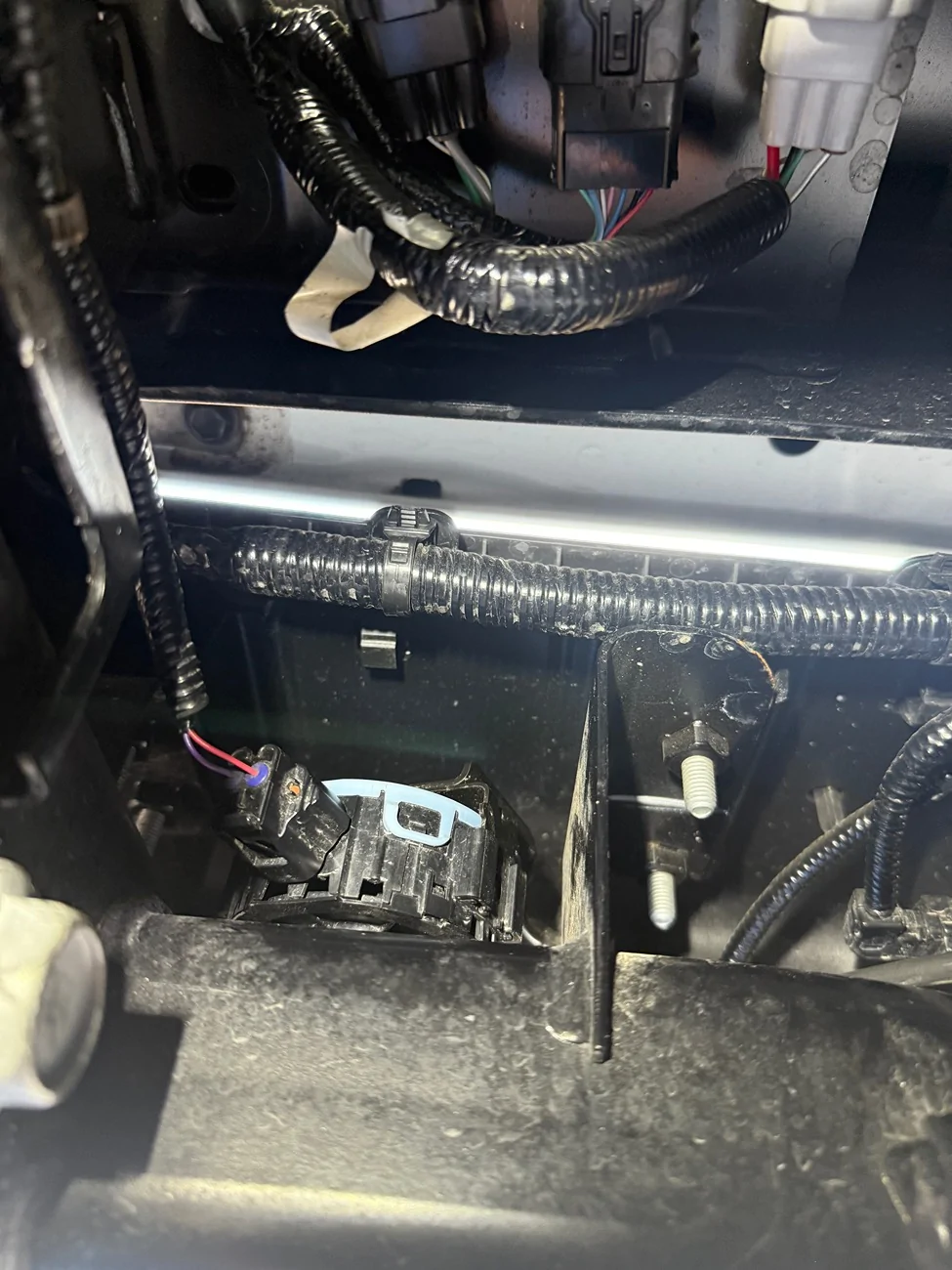

I'm glad that I got my order in when I did. I did not have to lower the spare tire however I did remove the small speaker located in front of the passenger side bumper light cover. Here is the pic of the speaker in question. I only needed the factory wire in kit for the rear switch and the jumper. The only issue that I had was by my own doing, I didn't make a good connection between rear end plug and the reverse light connector (red wire) easy fix. .
2024 Tacoma HOW TO: Rigid SR-L Series Lights for ARB Rear Bumper Installation IMG_4505 2
2024 Tacoma HOW TO: Rigid SR-L Series Lights for ARB Rear Bumper Installation IMG_4530 2
Rubenc87
Ruben
Sep 2, 2025
176
66
2025 TRD PRO
Of the three plugs, one goes to the pigtail which eliminate the connector that is on the harness with the ground wire attached (bottom right packed wire). As far as installing the lights, just use a long extension and you will be fine aside from the small skpeaker (pictured). .

How did you tie everything up to the frame without dropping the tire? I’m kind of dumb with stuff like this so I would not be surprised if I’m the only one who dropped the tire.
Rubenc87
Ruben
Sep 2, 2025
176
66
2025 TRD PRO
Ran the wires above the spare between spare and bumper. Just follow the factory wiring. Once everything is tested then just zip tie to factory wiring.
