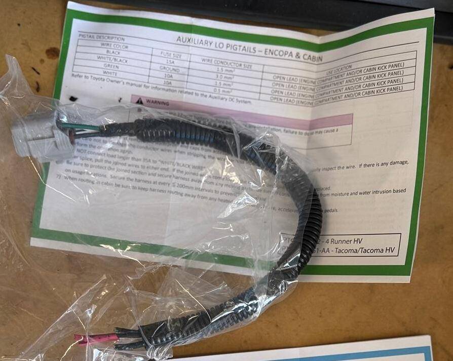

So is this one a power SOURCE? Or is it an INPUT for pass throughs somewhere else in the truck?
2024 Tacoma HOW TO: Rigid SR-L Series Lights for ARB Rear Bumper Installation 1750095376989-mb
2024 Tacoma HOW TO: Rigid SR-L Series Lights for ARB Rear Bumper Installation 1750095406358-a
Because from my understanding THIS one was the POWER OUT from the Aux switches. Which is the Green wire (Aux 2) Black wire (Aux 1) and White wire (Aux 3) with the black/white striped wire the ground?

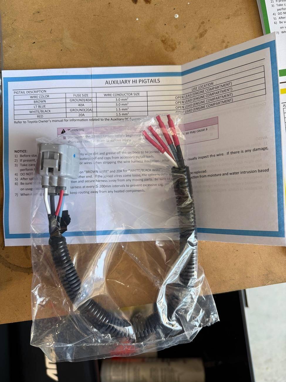

I believe the blue sheet connector plugs into the upper plug and supplies loads up front. These are already hot and have power. I think the green sheet connector plugs into the plug inside the cab, and should also be hot. You have to install the jumper harness in the engine bay to power the rear plug. That’s how my 25 Pro with 4 AUX switches should be anyways.

Yes you have to use the pigtail which connects by the washer fluid it is tight tough to get too to connect back wires to the switches
