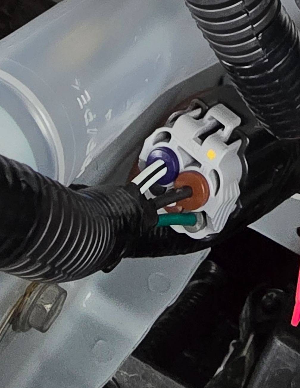

I have heard mixed on that. If you can, send a picture of your under the hood pig tail showing the wires and colors coming out of the 5 pin connector. I am working on a new plug in with connectors to be able to easily plug n play and interconnect to accessories...

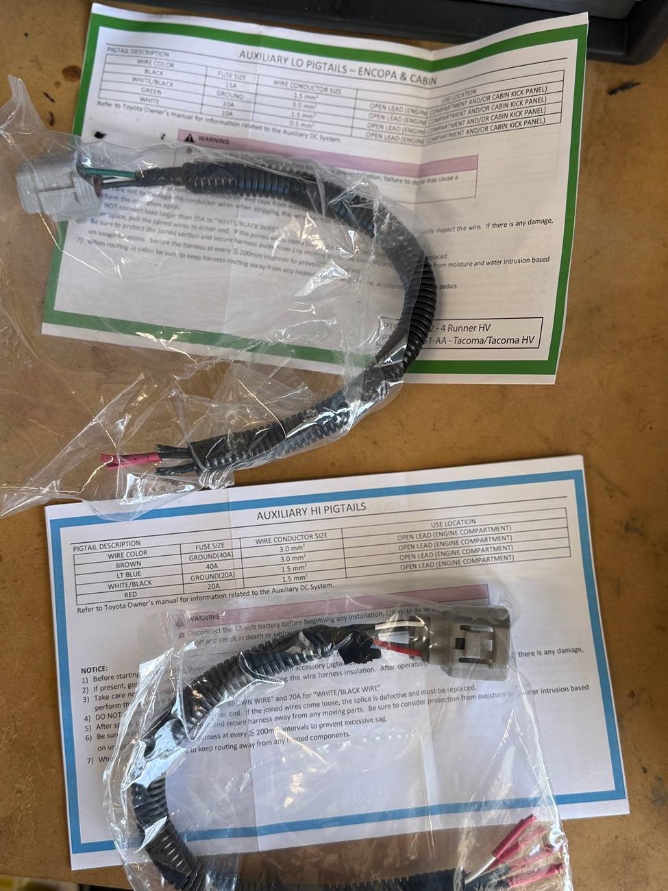

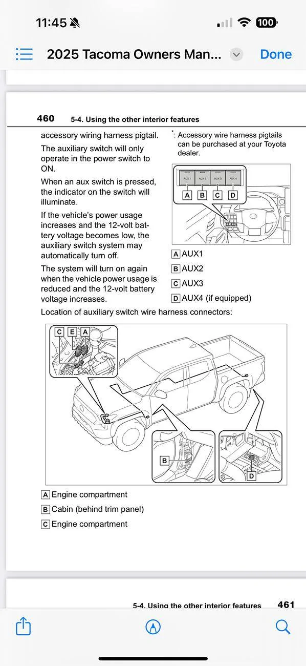

Maybe these pics will help. There are 4 AUX switches. In the engine bay, there’s a plug in port to power the front lights (blue sheet). There’s also bypass plug in ports in the engine bay (shown in your picture above) which directs power to the rear plug in port (yellow sheet). And there’s a 3rd plug in port inside the cab somewhere.

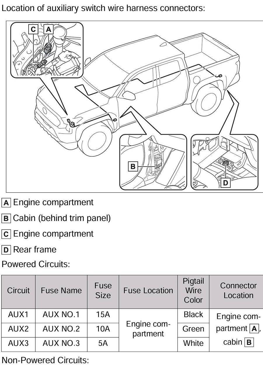

These pages are in your OEM manual. There’s a chart for 3 AUX switches and one for 4 AUX switches.

Yeah, I have looked at that diagram over and over and it's a little confusing but now that I know what I know it's not so much but I can see how people have questions when it comes to all of this.

Yeah, for real. It is quite confusing. I jumped into it without studying all those diagrams and learned by my mistakes. Hopefully some of our sharing helps others.

I agree. If it’s correct, I don’t get it. It’s titled “Non-Powered Circuits” so I would just ignore that chart. lol
